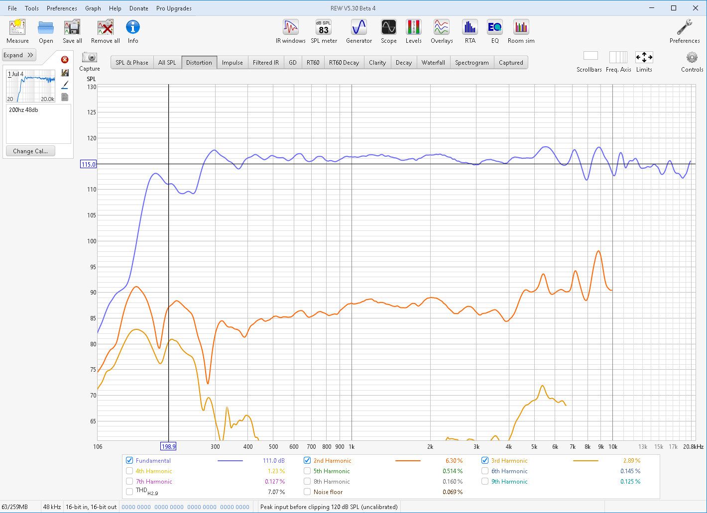

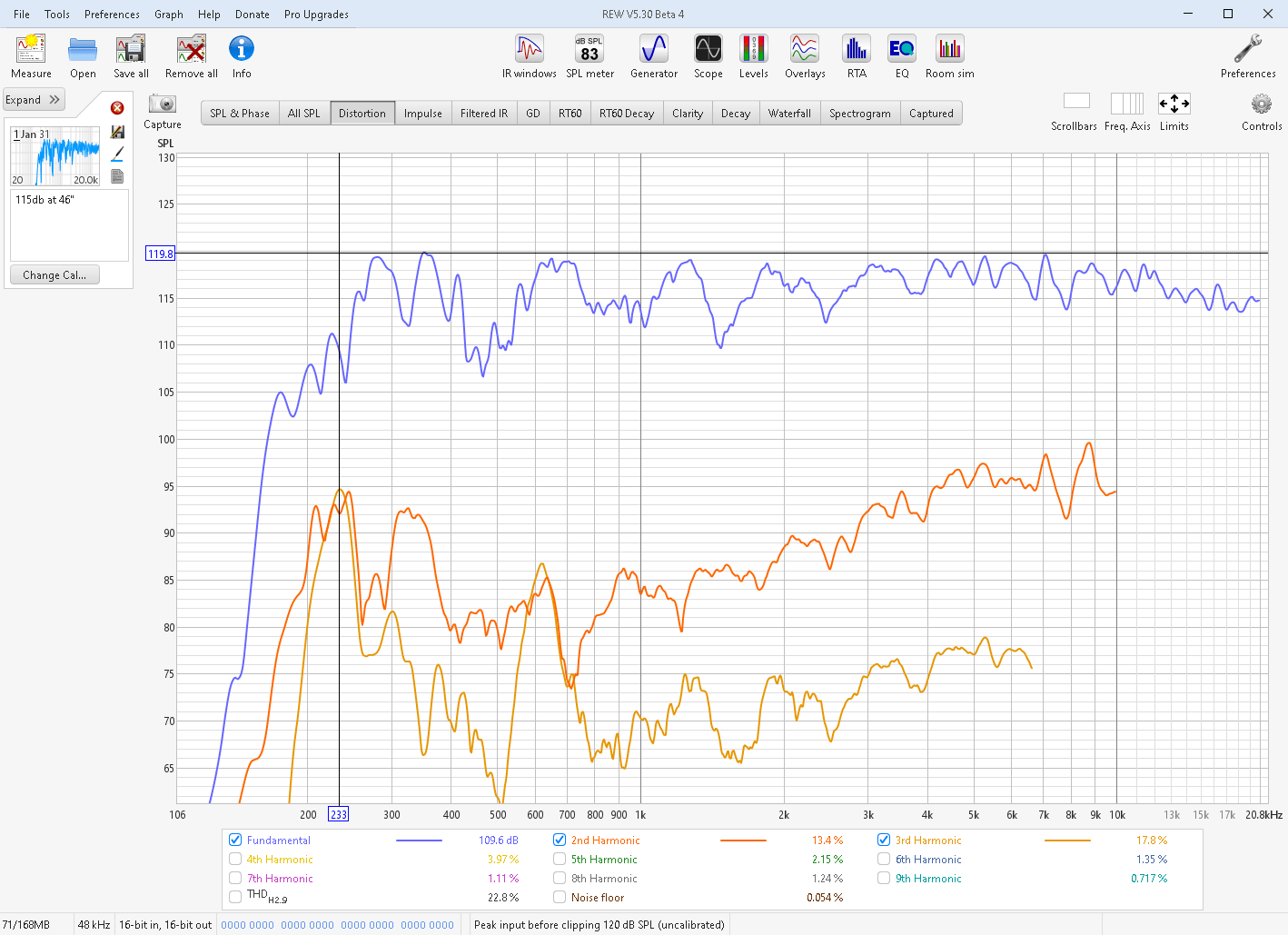

(inside at 46")
(Outside on the deck 6 ft from house pointed at sky, 1meter, too lazy to go to middle of yard...)
Thd measurements are more accurate outside it seems. According to the above I have more than enough headroom to cross at 200hz, wouldn't you say?
If 95db rms, then 110db peak, minus -6db at the xo point and another -3db with the addition of another channel. 101db 200hz/1m. This is all about parasitic THD correct?

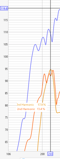

If you are now happy with 18% third harmonic distortion at 233 Hz and below at 109 dB from 1 meter away, sure, you have enough headroom 🙄 .
Thank you for being forthright but lets take a measurement at a more realistic spl. Was that an honest 115db?
I call that a show of force. Thd is complicated with horn loaded drivers. I recall times where THD would lower as I moved the microphone closer... That suggest a disconnect between the measured thd and parasitic effect to the rest of the passband, which is it what I would be concerned about, as I do not recall any issues with impressions of SQ.
Lotsa suger there ;-) - way to much distortion for my liking and requirement. About at least 10x too much.
Your liking is a system producing less than 2% thd at 117db/1m?????? What system do you have!? Please share your measurements at 117db/1m
