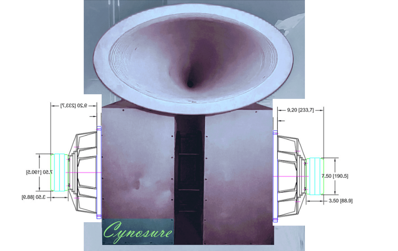

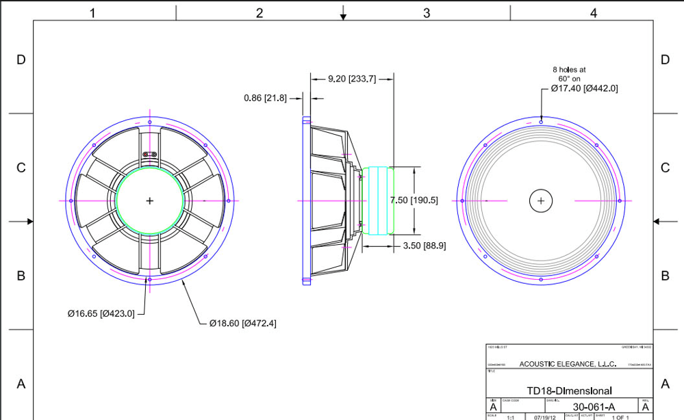

Just to be clear, I am entertaining 18s on the sides of the enclosure, for active cardioid potential. The motors would be facing out, so I was wondering is where the limitation would be on the high side of the passband due to the unique geometry blocking the rear diaphragm.
Lets say that magnet is 7.5"...I guess that would limit me to about 450 hertz?

This is what I am imagining
I think should be able to run the ride woofers up to the point where the Horn looses directivity. Then again if the front woofers aren't running that high does that even make sense, since, the side woofers aren't on the same axis horizontally, as the horn. So at the very least, I can cause some directivity down low, or just use the side woofers to correct the FR where It can and then use them as a monopole where no improvement needed, in an attempt to have the best bass response with only 2 sources.

I am sort of confused on what limitations are going to be with this config.... Q goes up I guess that doesn't matter....outside woofers are separated by 32" so coupling only happens below 105hz..... The intentions where to create cardioid for LF directivity. The horn looses directivity ~423hz...

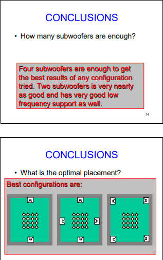

These pictures came up in discussion elsewhere...You guys probably have seen them too many times.
I have tried that. Also one sub in every upper corner. 8 subs i total. Was ruler flat, no eq, from 90 to 3 Hz in room response with sealed 10" boxes. It sounded very wired, like being in a car. Was strange not to have the sound coming from the front.
Very interesting and thank you for sharing.
I must be very tired... the correct response would have been....Because there is Not enough room to fit the magnet inside the box...the magnet of the other woofer is in the way. I'd have to widen the box some.Why are the magnets hanging out?
^ Some speaker motors can make noise, test if yours do before building it. Air is pushed through the motor to cool it down, wires may rattle and so on. These might be audible, if motor sticks out. On high quality drivers, perhaps not. Worth to check out though.
I've done multiple subs for more than 10 years and don't find it "weird". I find it the best bass that I have ever had.I have tried that. Also one sub in every upper corner. 8 subs i total. Was ruler flat, no eq, from 90 to 3 Hz in room response with sealed 10" boxes. It sounded very wired, like being in a car. Was strange not to have the sound coming from the front.

And I also see why. It was the most smooth and clean bass I've ever heard. The wierd part was that it felt like being in an alternating pressure chamber. Difficult to orientate. The room was quite small like 14' deep, 11' wide and 8' high. I ended up rotating 90 degrees, thus having lsp along the long side and an WW-MTM-WW setup where all W were about 1/4 from every boundaries. Became relatively smooth but with a more coherent experience.I've done multiple subs for more than 10 years and don't find it "weird". I find it the best bass that I have ever had.
I'm curious to try again thought, still remember that rock solid low frequencies. In a few years, kids have to grow some more.
I bet; Direct and indirect sound coming from every which way depending on Frequencyalternating pressure chamber. Difficult to orientate.

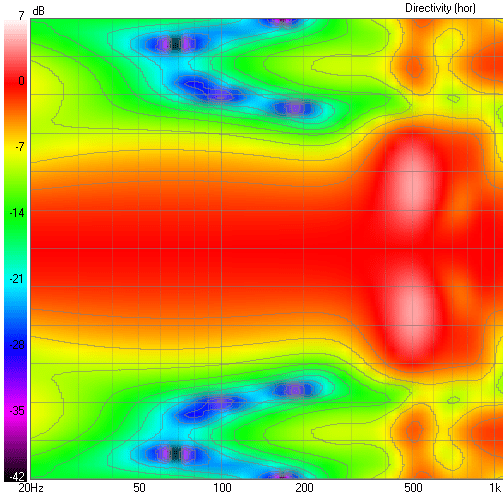

This a pic of some of the polars I see with an indentically inverted response with a delay on the side woofers
There are various combinations of configurations to choose from. The main thing to think about is how in thee hell does one set up the filters, in situ???? Especially mixed phase as in cardioid and monopole in the same filter. I would like to think that I could just try to affect the areas of the FR that appeared to need improving, but after some thought, it would appear that Full Cardioid makes the most sense even for the areas where FR was smooth or EQ'ble to a more neutral response, because it would still further increase accuracy by lowering decay.... It would also be more simple to set up....I think... I just don't know. @gedlee I would imagine that you would have some ideas given your high level of understanding of whats happening in the room.
I'm pretty sure that Active cardioid is the ticket. But how to use it properly is the Key. There is no real time phase Eq that I know of. That tool would make it much easier to create a desired response, I'd think.
For set up insitu the only thing I can think to do is take a measurement of the Front Woofer, with mic somewhere on the side of the cabinet, likely directly in front of the Cardioid woofer..... Create that same response to be emitted from the corresponding cardioid woofer, and then invert the phase and add delay and adjust spl from the woofer until desired result.

It looks like the cardioid effect is much stronger, the closer the sources are. I did figure that I can get the magnet inside of the box by going modular and making boxes that can attach to the sides of the current box. I was hoping to get more of your opinion. At potentially 56" wide I wonder should I just Build the Desk around the subs as well lol. Is there any particular thing about the reverse mount that detours you?
