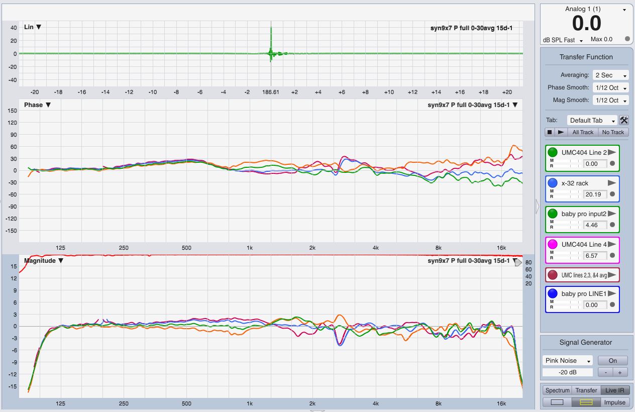

Here's the kind of polars i get....although I can only provide horizontal until i get to try out my new 5 mics on an outdoor vertical mast rig.
(The way i make the syn boxes doesn't allow for setting the on their sides the make spinorama meas).
Anyway, here's the last set i made outdoors of a 75x60 degree box. 0-30 deg, steps on 10.

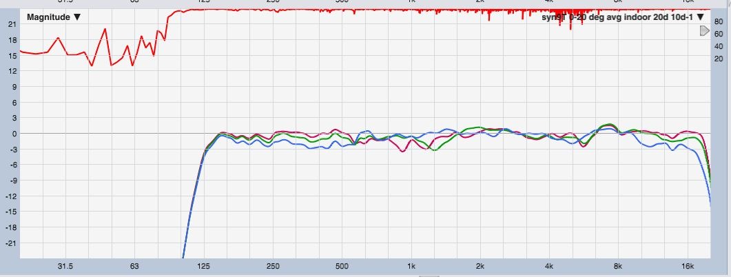

And here's a 90x60 box I'm currently using in a LCR config, made indoors close, no gating. Zero to 20 degree, steps of 10.
I don't bother with polars outside the conical wall angles anymore.
And have come to believe consistency within listening window angle is what dominates SQ.
(All my syns are made to cross to a sub at 100Hz.)
Anyway, these are giving me a sound I love

Yep, we do seem to have different preferences and opinions, but hey, that's all good and well, right?
By coherence, I meant the coherence as measured in the transfers i posted. It's the top red trace in the magnitude pane. Sorry if that passed by.
If you'll look at the first outdoor set, the one with the crap at around 3kHz, you can see coherence is 100% across the measurement.
That tells me that the measurement's overall flatness mag and phase is very valid. No gated smoothing, no reflections, etc.
Tells me the warts are real too, and need work.
The second indoor trace also ungated, has decent coherence too.
But it's an up close measurement, within the near field (acoustic definition), and therefore pretty suspect imo.

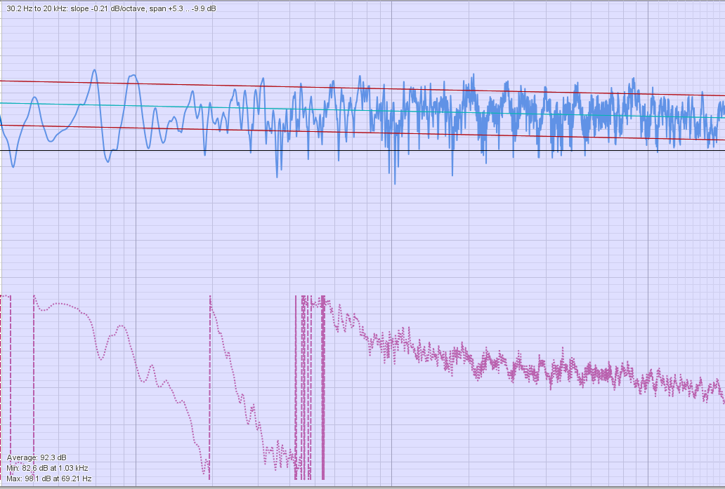

This is what I've been listening to at about 45", one channel. I thought the HF would be cleaner due to the narrow polar but its a lot cleaner than say a dome tweeter would have been in the same situation. I am impressed with my ears over the last 2 days as I experimented with the 2way config. Through only the use of reference tracks I diagnosed miss set, parameters in my XO. Accidently setting a LR48db LP to Butterworth, out of phase, and before all of that, a HP on the horn set 65hz? I'm impressed with myself that I could hear it, simply because, looking at the FR and phase, nothing was out of place, per say. As soon as I switched the filter type, the material hidden in the XO, came forth. I was considering that the mechanical HP of the slot did something un repairable and that I would have to take the woofers out of the slot....it was a miss set filter type....WTF
