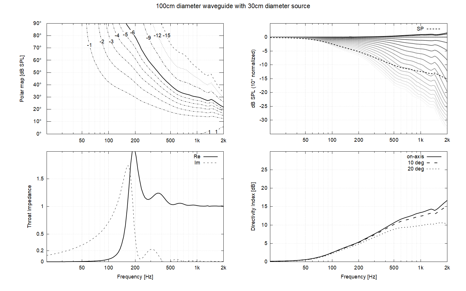

I am no expert on horns but I remember that some rule of thumb repeated on forums is that mouth circumference should be 1wl, which means for 100Hz ~340cm so roughly 1m x 1m (~40") square should work?
edit. Quick test ATH, 100cm diameter waveguide for ~15" driver and it looks like bigger is needed. In comparison ~cardioid system would be miniscule. But again trade-off is in the SPL capability for bass.

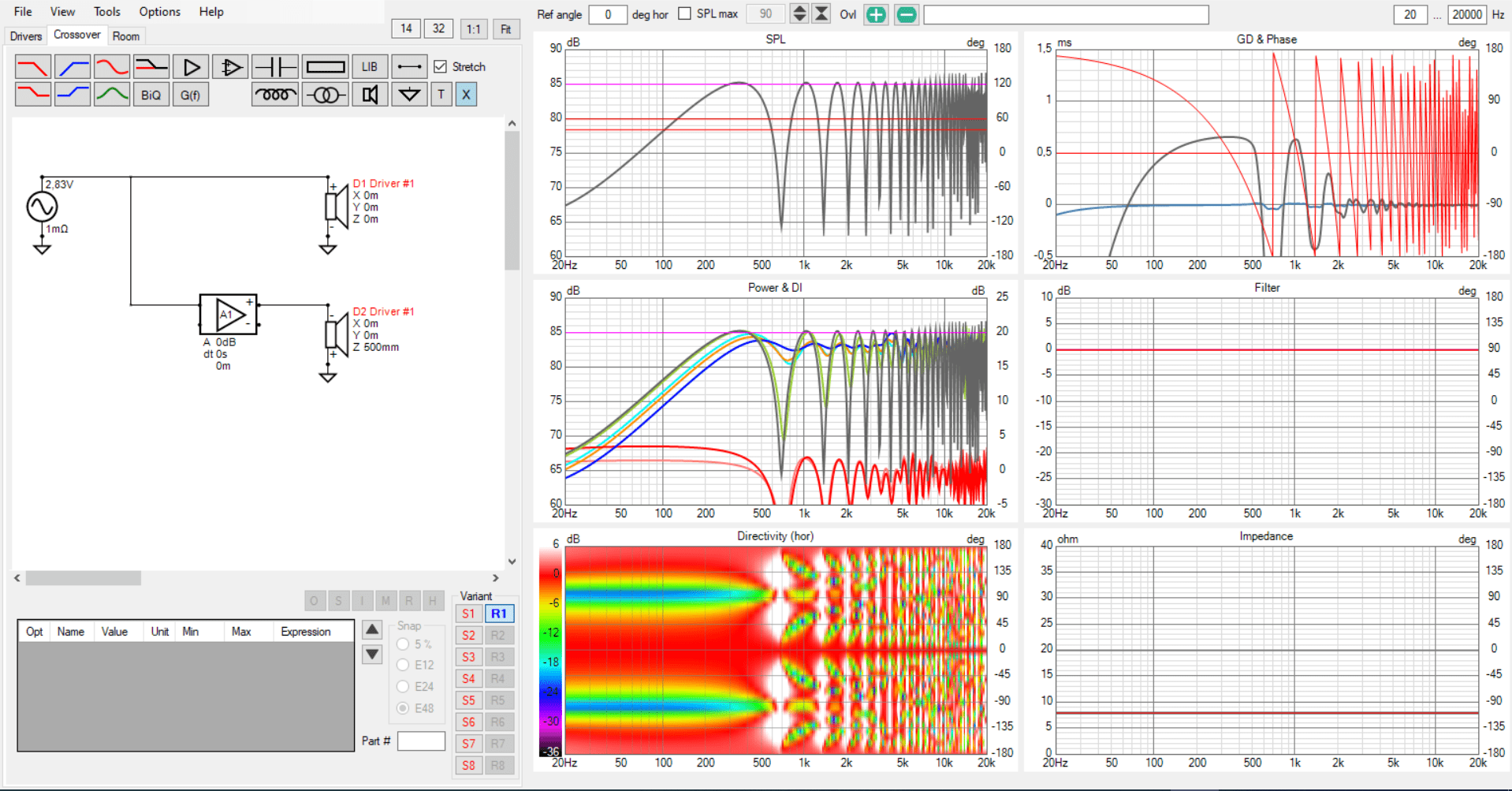

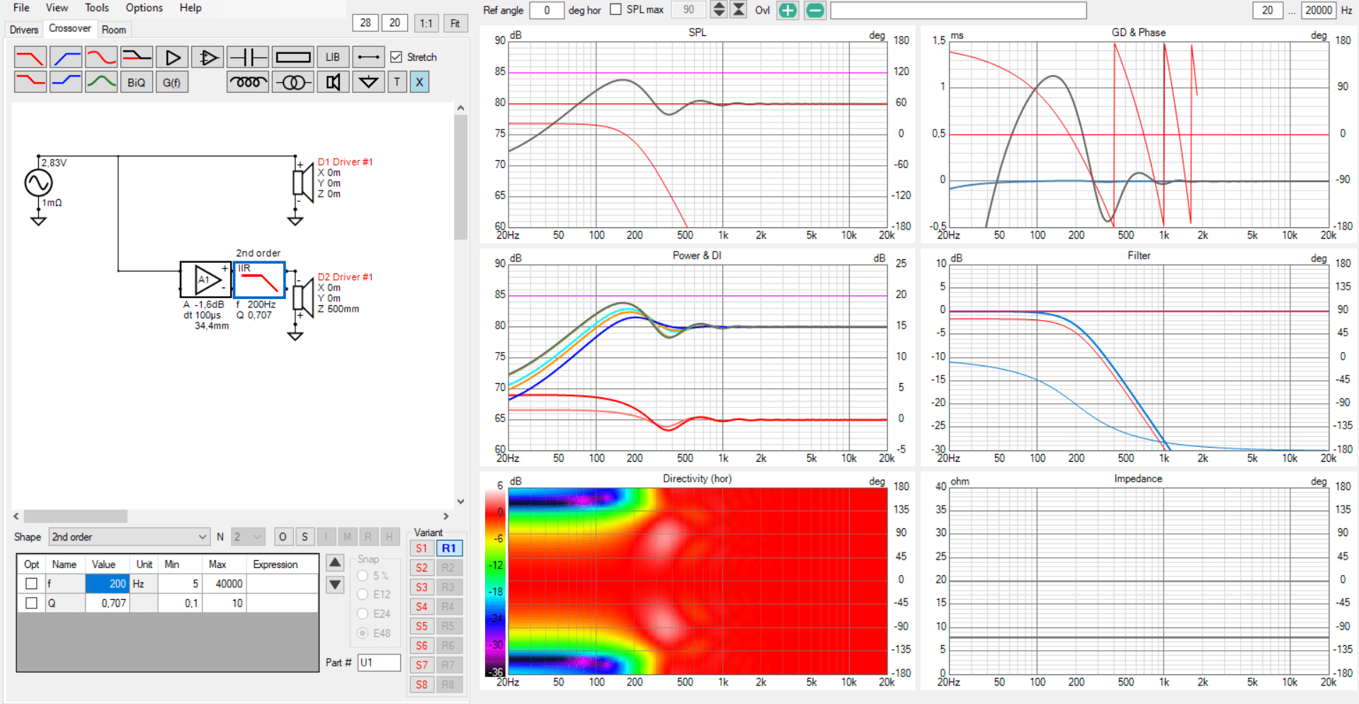

^^ Yes delay is the trick. Dipole has no delay on either side and destructive interference happens towards 90 deg off-axis. When the other side is delayed then the null angle turns, quite simple. How to manipulate delay passively, using single sound source, both sides of a woofer? Lets run it through:
Few things
1. affect path length between the sides, front and back
2. add group delay with acoustic low pass filter
3. add delay with some material that has slower speed of sound than air
4. something else I don't know of? the magical resistance?😀

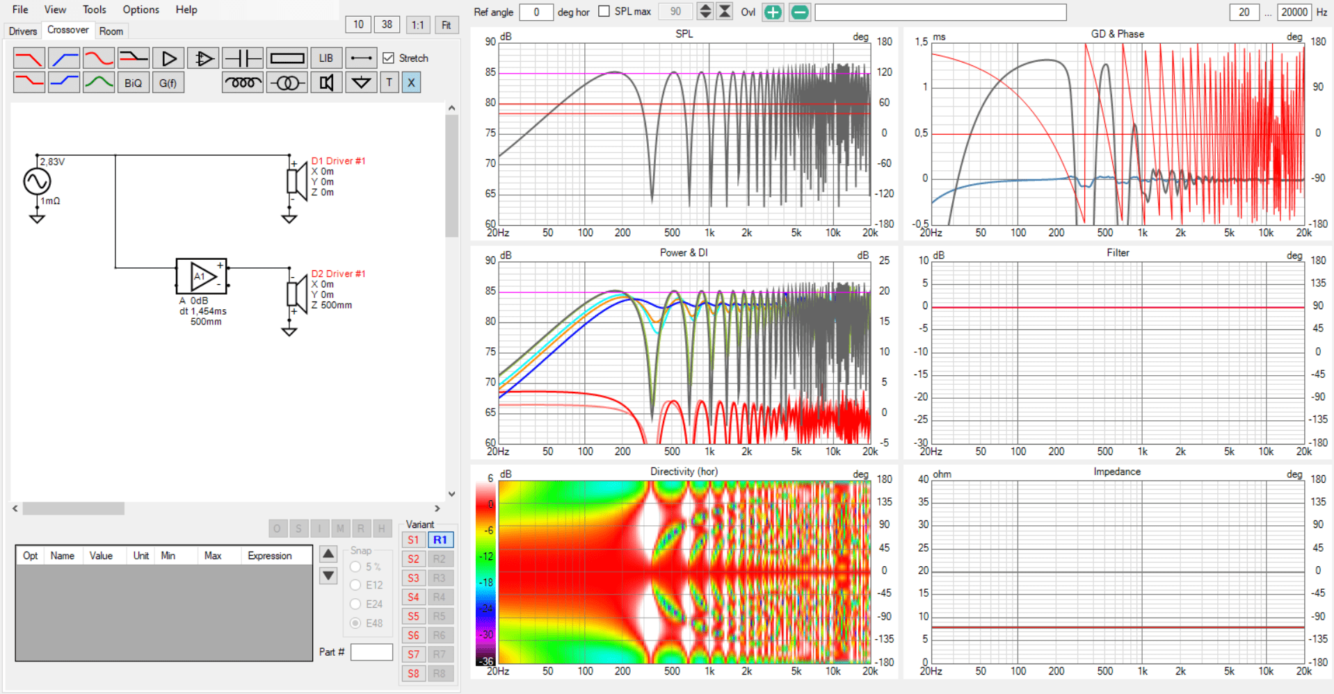

Destructive interference happens best when both interfering sounds equally loud. If either is quieter the other dominates and attenuation is reduced. There is then a trade-off how much one can make delay with damping material before attenuation is too great and pattern not as good as hoped (low DI). "Problem" with damping material is that besides adding delay it also attenuates, and attenuation depends on absorption coefficients of the material and incident angle of the sound. As frequency dependent filter it creates some group delay as well.
Hence, all three must be balanced, path length between the sources (position of aperture), minimal damping material to prevent too much attenuation (close to dipole now!) and then manipulate acoustic low pass on the back side to start turning the pattern.
To have as much bass available as possible you'd need path length to be tens of centimeters (like with dipole).
Here is example, with sensible 50cm path length between front and back sound we get elevated DI for bass without losing too much lows.

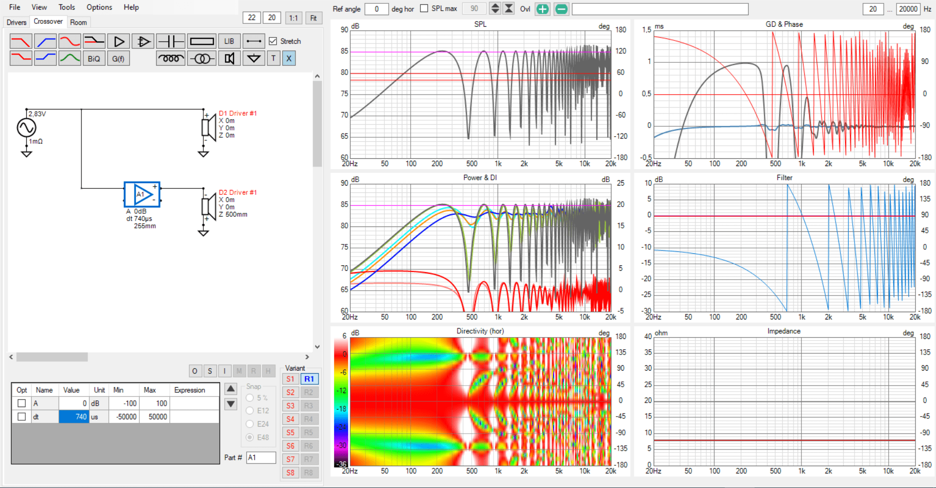

Then, turn the nulls to higher angles adding delay to the backside somehow. Now we just use a delay block, easy!🙂
Shorter than path length delay we get ~supercardioidish pattern and delay equal to path length we get the cardioid. Too much delay and it turns to subcardioid and eventually the pattern disappears.
Such delay block is not possible passively/acoustically, so lets add some attenuation to it assuming we have material that does the delay and adds some attenuation. As mentioned earlier materials tend to have varying attenuation with frequency, very little on low frequencies. Not sure if there is materials available that add delay without attenuation. Perhaps some maze / metamaterial is possible. Anyway, the pattern gets poorer with attenuation to one side so it is better to avoid attenuation (on low frequencies) if at all possible. Except for possible reflections of short wavelengths, so logically we'd use some damping material but not too much.

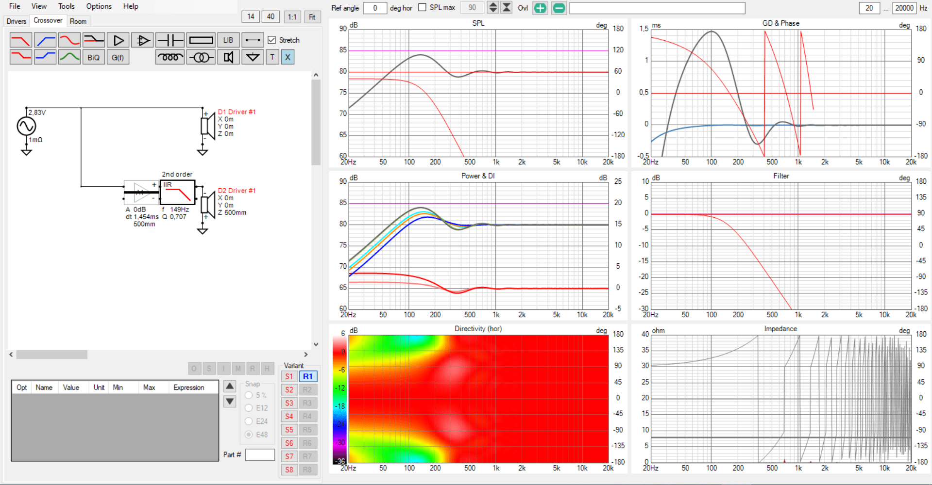

What if the delay was made with group delay instead? Seems to work.
In reality we probably have some delay and attrnuation from damping material and some low pass due to volume inside the box and apertures:
Wow, looks good. Issue is that how to actually manufacture such thing, is it even possible? How to get 2nd order acoustic low pass for example? Well, use reflex box calculator and tune the resonance somewhere above the low pass on the emulation. Cool, how about the small delay and attenution? Just try few different materials and use what seems to work best. Also, as this is just idealized emulation simulation expect some additional variables that need to be tuned after the fact. So, some prototyping ahead.

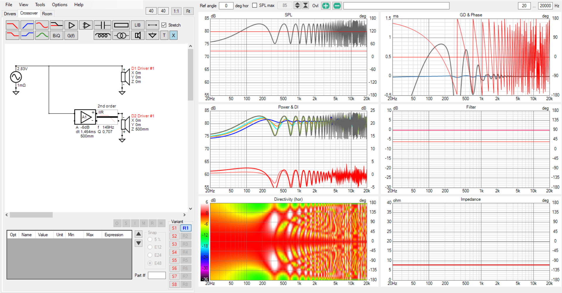

^^ Above is simulation with active parts so rear driver with flipped polarity 50cm further away. The simulation is ment to emulate passive system though, rear driver with flipped polarity represents sound from backside of the cone and the delay and filter blocks represent damping material and effect of the box volume and aperture size, which is an acoustic low pass filter, all of which affect the sound of from backside of the cone.
Its simplified example, with two ideal point sources and no bafflestep or anything so wouldn't quite represent reality like that. It is an example how to use imagination accompanied with the simulation, what a passive cardioid system roughly consists of and the various blocks are tuned in order to gauge "what would happen if" and use reasoning how to make it happen in reality. Its a method how to make emulation to help coming up with a passive cardioid solution.
You could implement it actively just like in simulator, rear driver on a 50cm deep box, flip polarity and add delay and low pass filter and bam, ready. Or what ever you come up with on the simulator specific to your application. Better check it with baffle diffraction and all. No need to use imagination if going active.

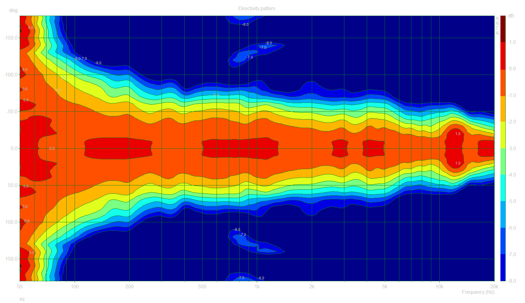

Are you akin to hearing this error? I mean do you look at the chart and can easily imagine how this polar would sound, in effect.
I don't give much credence to subjective listening tests - unless they are done correctly, which is very difficult. I base my designs on good measurements and learned how to "read" those. This approach has never led me wrong, so I stick to it.
But I have no doubts that the aberrations noted above would be audible. Proving that would be very difficult, so I let the measurements be my guide.
Reactions: camplo
Hmm... I was studying my FR at listening point. I think I'm close to the worst listening and placement in the room, somewhat offcenter but not far away... I've a huge null at 30hz and another around 70hz (not looking at computer, right now)...
I'd like to think that cardioid will help me get a FR lacking these nulls regardless of such bad placement

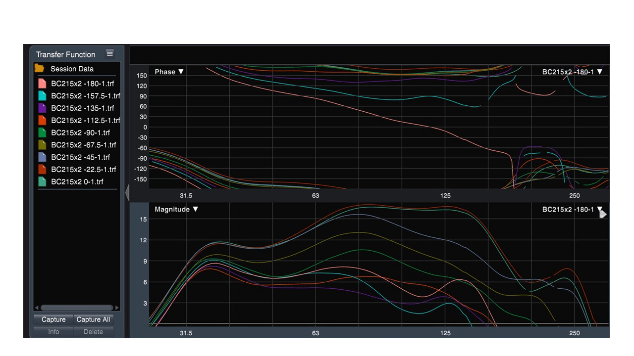

They had one thing in common: they were no match for simple (mostly Funktion One/Void) stacked frontloaded horn subs in terms of perceived quality/purity.

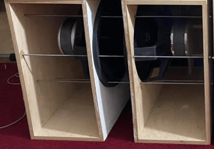

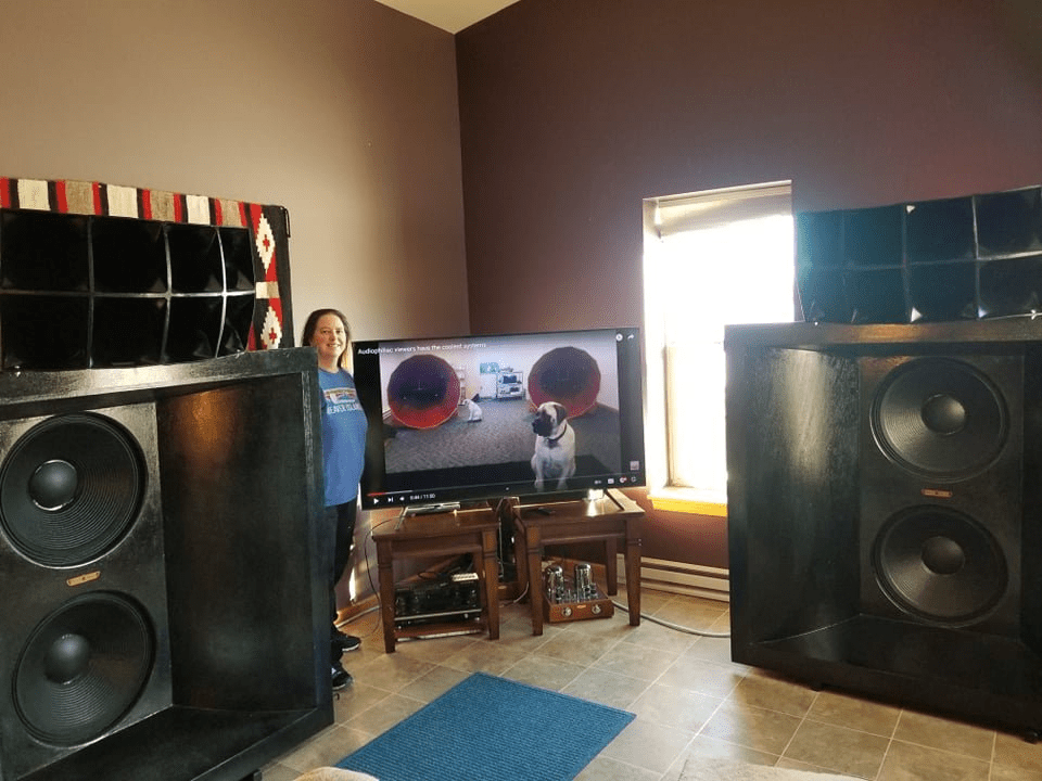

That ol, new, friend of mine, Headroom. I've been imagining 4 18"s, two sets of ppsl stacked under the horn.... but then I'd be opt to try passive cardioid, and be "stuck" with the resulting headroom. It might be "enough"....
I like what @gedlee said about "mixed polar" filtering, the idea of possible having the additional woofer be cardioid and monopole at the same time....How would one even do this? GD?
A null eats headroom for lunch... what does a null mean to cardioid? Does Cardioid really narrow the beam width that much that its a sort of silver bullet??? Antinode eater?
Am I correct that cancellation on the side baffle is better than rear? Or is there any reason to favor cancellation in the rear? In the regards to cardioid performance I mean. Is there something special about the rear that makes more desirable to place cardioid woofer there? The closer the drivers the easier it is to use them in monopole is what I think.
