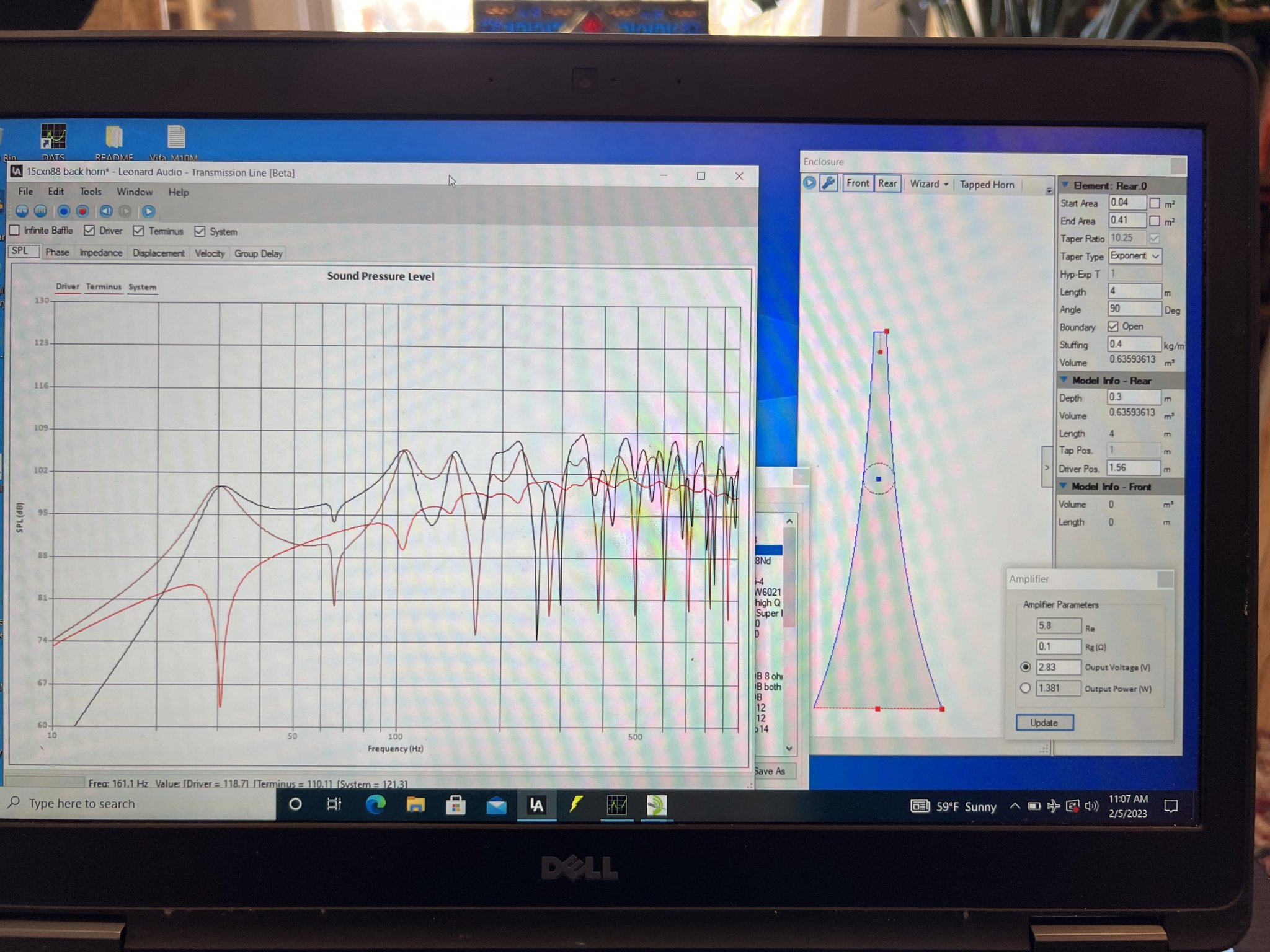

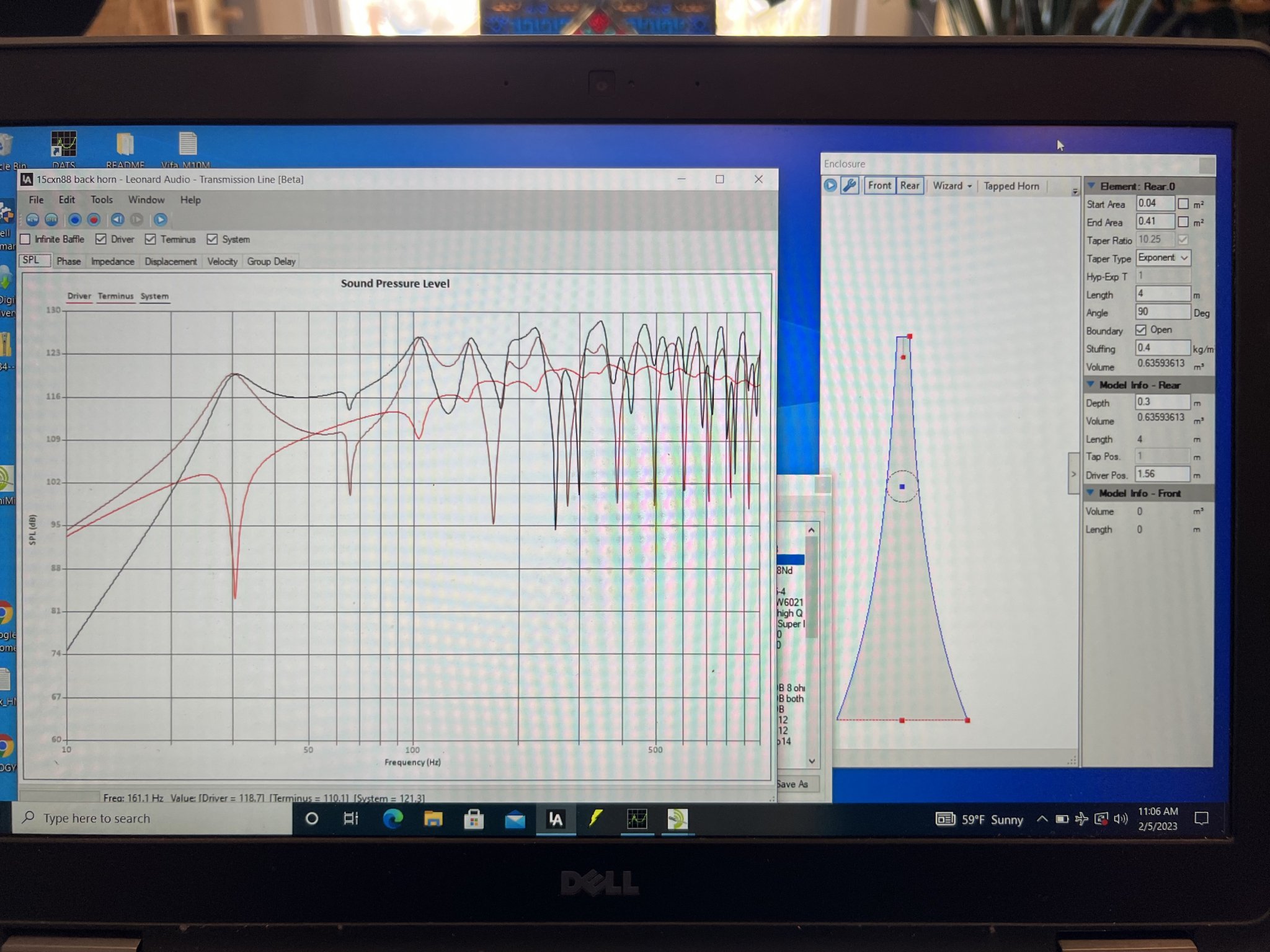

So this morning I modeled the 15” coaxial B&C 15CXN88 in the Leonard Audio horn/TL software program. I use the 15CXN88 as a bass midrange + tweeter in my Bitches Brew live edge dipole design, crossing it over at 110Hz. This driver emphasizes my point because it is not even a subwoofer by any stretch. It is designed to be a bass midrange. But in the right size horn it still can function as a sub as you can see here:
Below is graphs for a 635 liter horn with 4 meter length and 30Hz tuning frequency. You can use it down to about 25Hz and then you’d want a steep high pass filter below that point to minimize excursion. This yields 100dB spl for 2.83 volts at 30Hz:
This is the output at 28 volts input (100 watts) which you can see is 120dB:

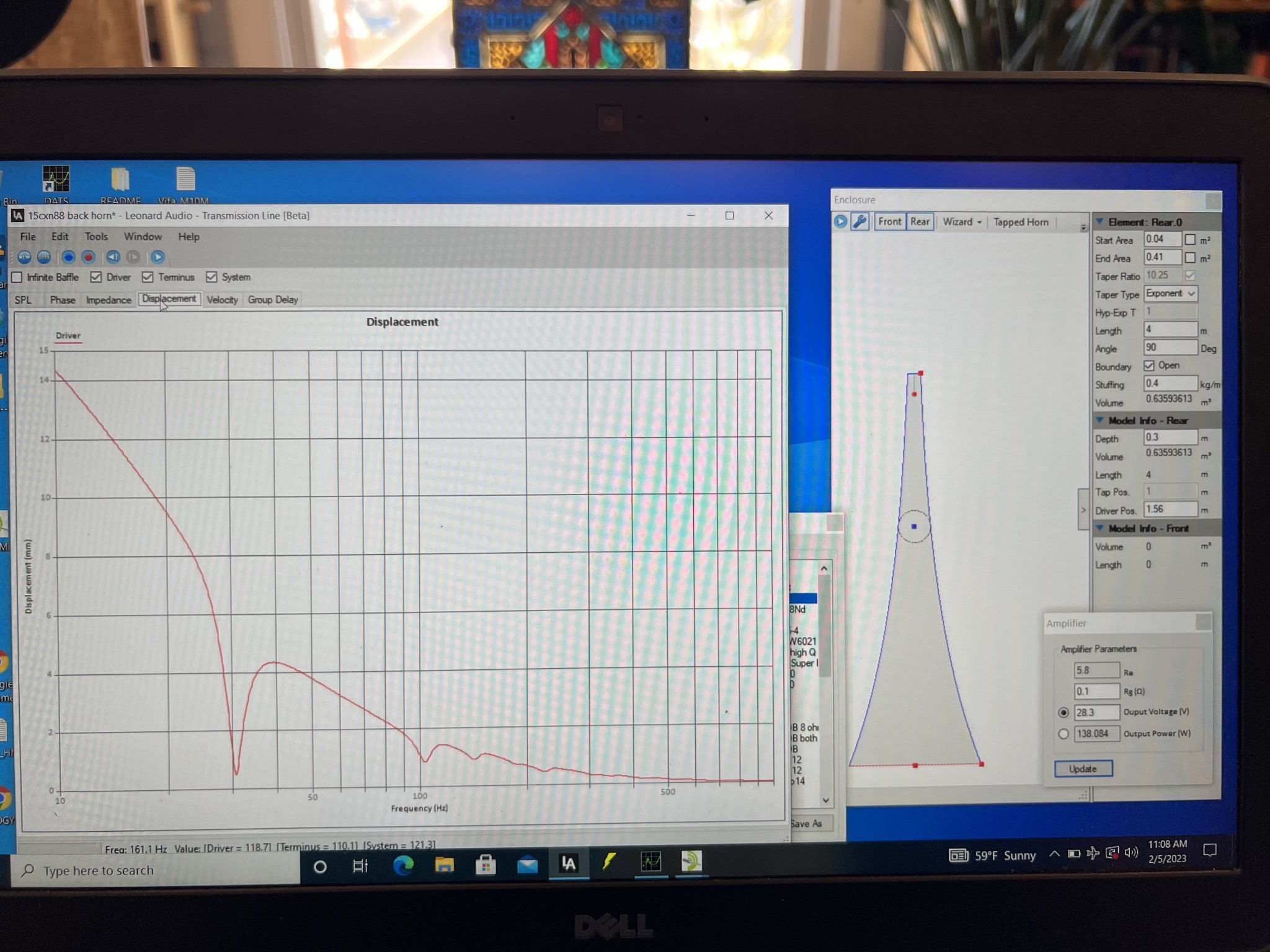

And this is the excursion:
At 30Hz it’s about 1mm; peak excursion is under 5mm at 40Hz. So even this bass midrange can put out 120dB at 30Hz.
If you look closely at the right enclosure panel, you can see the settings I used. The driver is mounted about 1/3 of the way from the closed end. I just whipped this up quickly, it’s not particularly optimized. There are midrange peaks from the horn that you can deal with via DSP or with transmission line stubs but it does give you an idea.

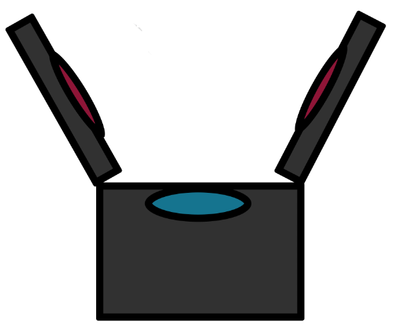

Whats going on with Dirac live and active room treatment? I think active cardioid is, in a way, a form of active room treatment. One Idea I thought about was using woofers to create bass directivity but in a way I have not seen. Likely because its a horrible idea but here goes.
Lets say the red circles are the cardioid woofers and the blue is the main. This would be a top view... Does this make any sense lol?

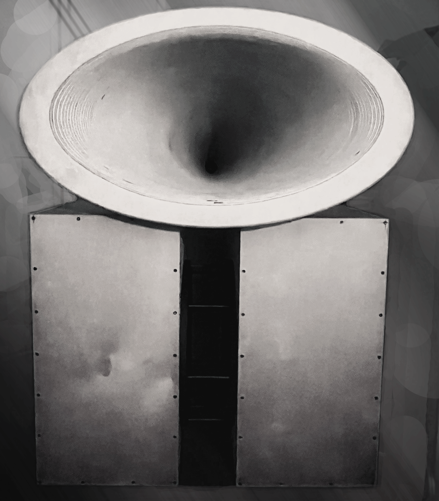

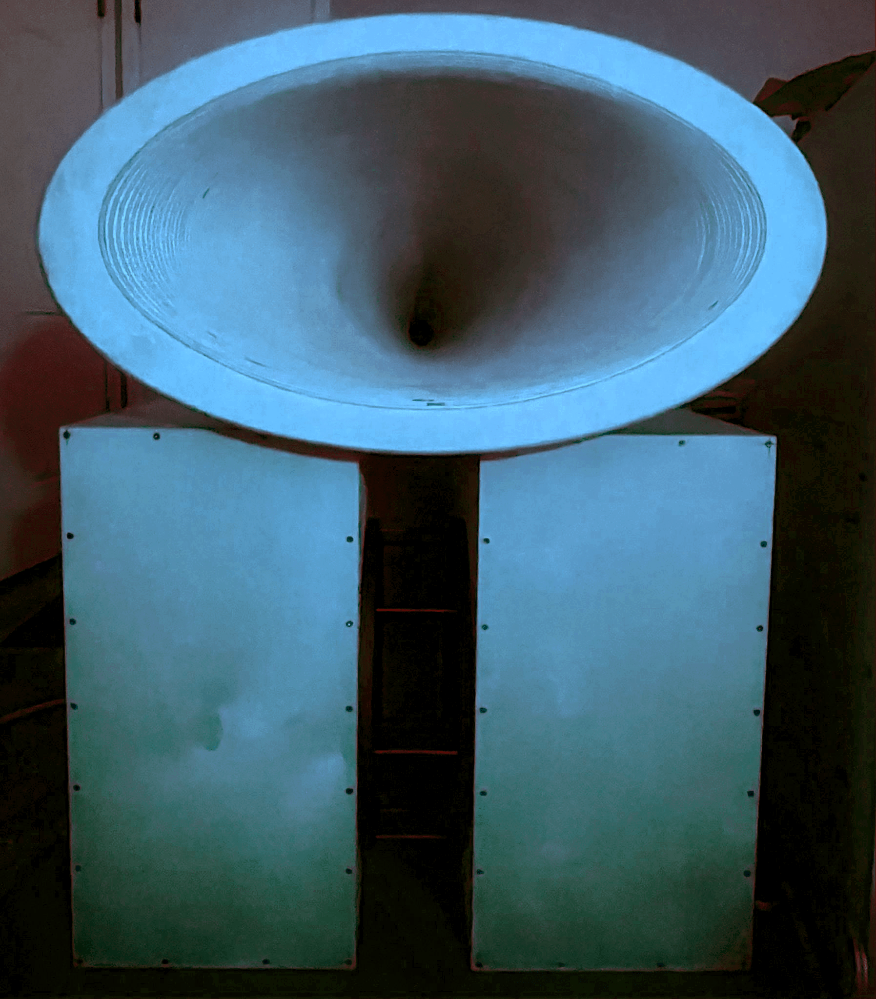

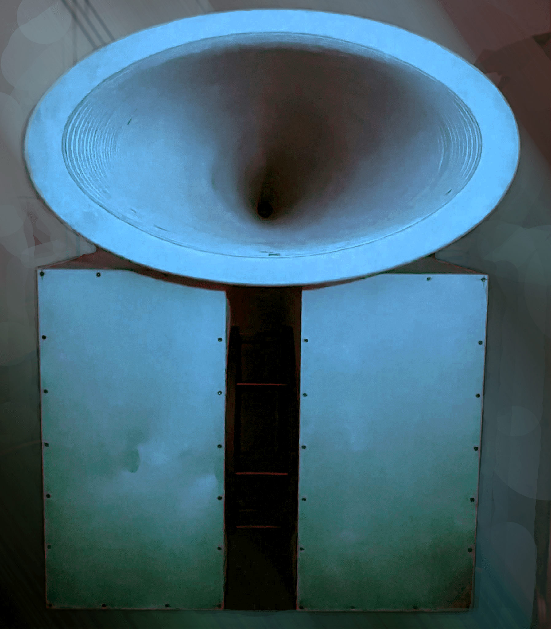

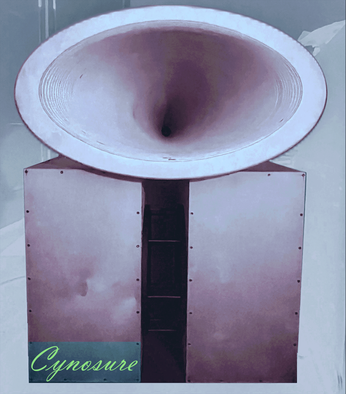

Came up with a name finally 😊 Cynosure - cy·no·sure
Still a ways to go, but I am so grateful to you all, who have helped, and continue to help me and others like me, in the community, create something as unique and desirable as this. This speaker is not what everyone wanted or wants, but its what I wanted and I am pretty sure I did a good job covering almost every aspect to be criticized, with your help. I've also found a flaw in one of my favorite reference songs 🤔 this system is truly vulnerable and that was what I was aiming for. It has the 2way vide that so many people love for the same reasons you all do. I think this could be called a PPSL 2way maybe? PPSL assisted FR?......PPSLAFR, PPSLAWBH for PPSL assisted wide band horn 😉lol! I did put thought into the design. When I first was introduced to the PPSL it was a sort of eureka moment but with no instruction manual. I knew that if I went this route that I should error on the side of accuracy further up the passband, so a smaller CSA slot was chosen. I initially was inspired by a Ripole recipe that asked for a slot width, 1/4 of the woofer diameter. From there I was inspired to increase the CSA just slightly, higher than a 2:1 compression ratio. Point being, I made this PPSL with context of being mated to other sources, not just a subwoofer to be sat in a corner by itself with a lowpass set at 80hz. I played with Hornresp, paying attention to the placement and character of the slot resonance as opposed to where it might be crossed over at, 200hz. I just so happened to overlap where the Axi could go as if I planned to pair them, but I didn't plan this from the beginning. I call it a blessing😇. I always thought I would run the horn to 300hz, the 15" to 300hz and the PPSL to "just under the horn XO, ie ~200hz. I actually used Vituixcad to show how far down to place the XO, to stop the ppsl from augmenting the simulated response, in the speculated horn xo area, and like I said, about 200hz it was! So the PPSl in a nutshell has been designed to be able to cross at 200hz or lower. Some question'd my strange interest in the low Horn Xo...man I am in love! This system is in a way like my nearfield 3 way, where the 2way portion covered above 130hz and the 12", everything below, I ran the 4" from about 130hz-2.5khz and to me it was pretty awesome sounding midrange. Somewhere I came across the term "naked midrange". This has the same great midrange but the directivity takes it to the next level in turn coming from a single point up through treble. The horn is like a lens, and it has higher directivity than the 18"s unless they were arranged differently but non the less, its one source, not 2 combined, and with the low xo its pretty much Fullrange. 200hz is a good XO territory, there's a lot of energy there, in media, what a great place to have all that efficiency, probably a little directivity and 3 large sources coupled because of 1/4WL. That with all the headroom down to 30-20hz. I haven't even auditioned in stereo yet lol and I am very impressed. Funny thing is with the other system, at about arms length, crossing at 200hz was a problem. I wonder what I did wrong? With this new system, 200hz xo point, it doesn't seem to be an issue. If you are familiar, you basically listen to vocals, and you wait for a low note to draw you're attention down, or for yourself to perceive the vocals to come from somewhere else suddenly with the occurrence of a low frequency in the vocal performance. I'm not getting that with this system and when I mute the horn, theres not a lot of vocal energy there to boot. I think the mechanical lowpass of Slot, on top of the 48db LR lowpass, is causing much more of what would of been more noticeable material, to be attenuated. Still, I should be able to break this illusion you'd think, in particular with my close proximity listening distance. Maybe I need to pull up some Barry White and see what that does. I'm excited because, just as is known, when things are simple, they work together to achieve a great result, much easier. So if it sounds this good now, which is subjective, wait till I hear this baby Phase corrected to my listening spot via AudioLense! Thats objective lol. I've only experienced such a dsp corrected playback once, on an older system using the same 12" bass, but with an 8" midwoofer+1" tweeter. I phase aligned everything best I could to my sweet spot and it was another eureka moment ie, time alignment. The improvement was enough to make me a believer, and not only had me relistening to my catalogue but I remember pulling up pop stuff like 90's Madonna and being blown away by the production, even old Brittany Spears, stuff, I'm thinking, I wouldn't normally listen to this, but the increased SQ gave me proper perspective into the sound engineering which really causes the musicianship, to stand out and I was lovin it. So with this System, I should be able to achieve great things if I use it properly. Ty Ty Ty Ty Ty
OpenAi chat is a really good study buddy. Any one who likes to study anything should be using it, its work flow, its efficacy in transferring knowledge and just narrowing in on specialized knowledge is incredible. I've been pushing my kids on it, and I'm pretty sure, AI, is the best professor you've never had, particularly because it never gets irritated and will take all the time in the world to explain and reexplain again, whatever it is you want to know that it knows. I used it to create the Spreadsheet code above...It even allowed me to create a spread sheet that generated tractrix+exponential hybrids, simply because the math is well known and understood.....Not by me...but by it and other mathematically inclined individuals. Soon, anyone will be able to write programs thanks to AI. Above might be the only elliptical tractrix horn spreadsheet On the internet...... Its not perfect, the AI, but its useful.
well that was a long journey....only took 11000+ posts to get there!
I like the looks of it 😎 , functioning as a near field monitor there should probably be a small print warning sticker on front: ‘CAUTION….if you can read this your head may explode’
In all honesty, I need to set some type of limiting to protect myself. I am anxious to getting to the point of working on these monitors. Between the monitors and what I've learned towards Sound Quality and Impulse response, I should be able to work efficiently and effectively.
I'm not sure what to do with the 6 15"s I have.... add active cardioid to the project enclosure, multi sub, or cancel wave at rear of room...
