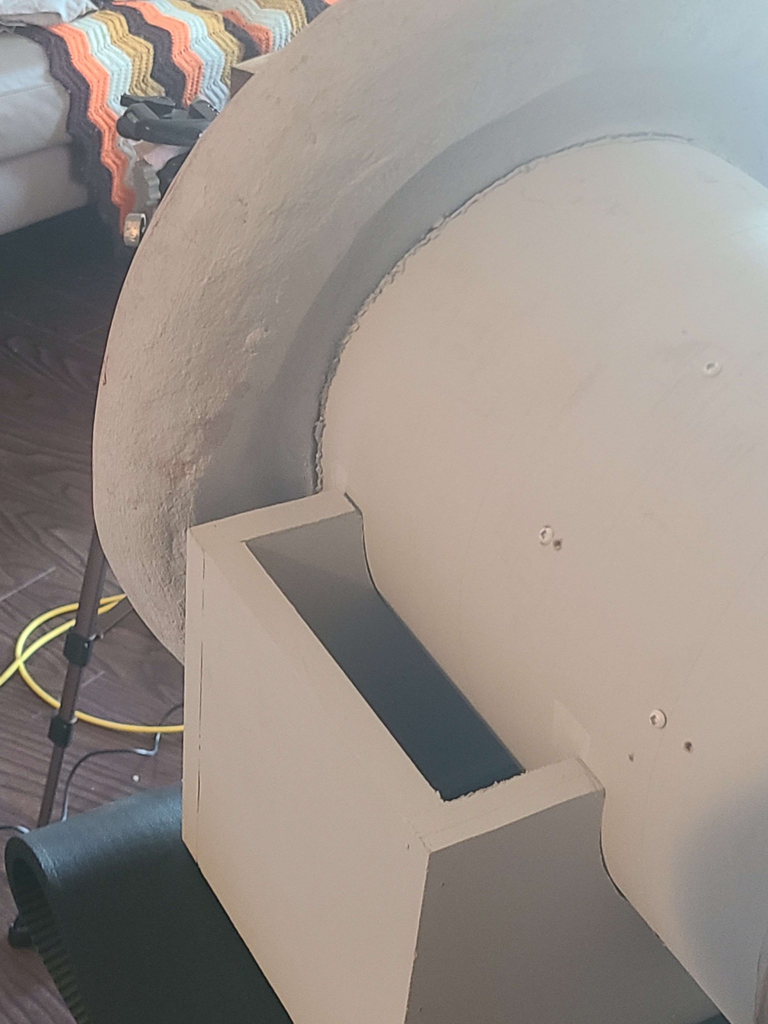

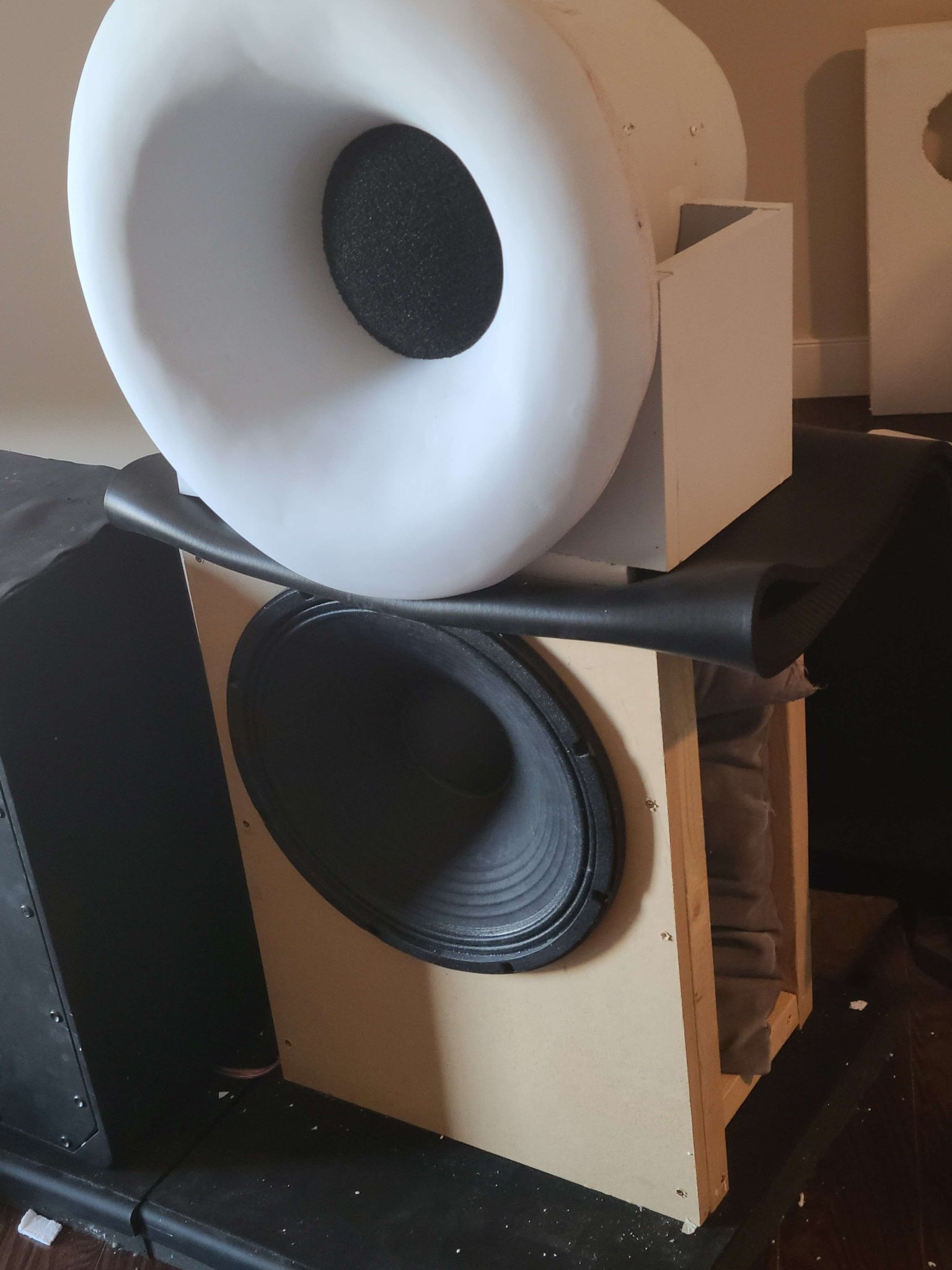

Still the best I've ever heard in my own system was an experimental rig I made a few years ago. I made a 21" oblate spheroid horn/waveguide with a 66 degree angle out of shapecrete with a huge roundover and drooped it over a 15" to get the c2c distance closer. I crossed over around 650hz and having that extra 350hz is a big deal IMO for sound quality. The other thing I'm convinced of is that the horn material matters. The innertness and mass of the 50lb shapecrete horn gave a solidity to the sound that was very realistic. More so than my Abbey's. Also inside the shapecrete I used metal wire reinforcement. The other thing is the 4" round over, this does something special to the lower midrange. I used a B&C 750tn 2" CD for the highs, it got a bit annoying in the upper treble due to beaming, this was before they came out with their coaxial, wish I had a chance to try them before I turfed the waveguide. I will build these again one day if I get the chance it worked extremely well.

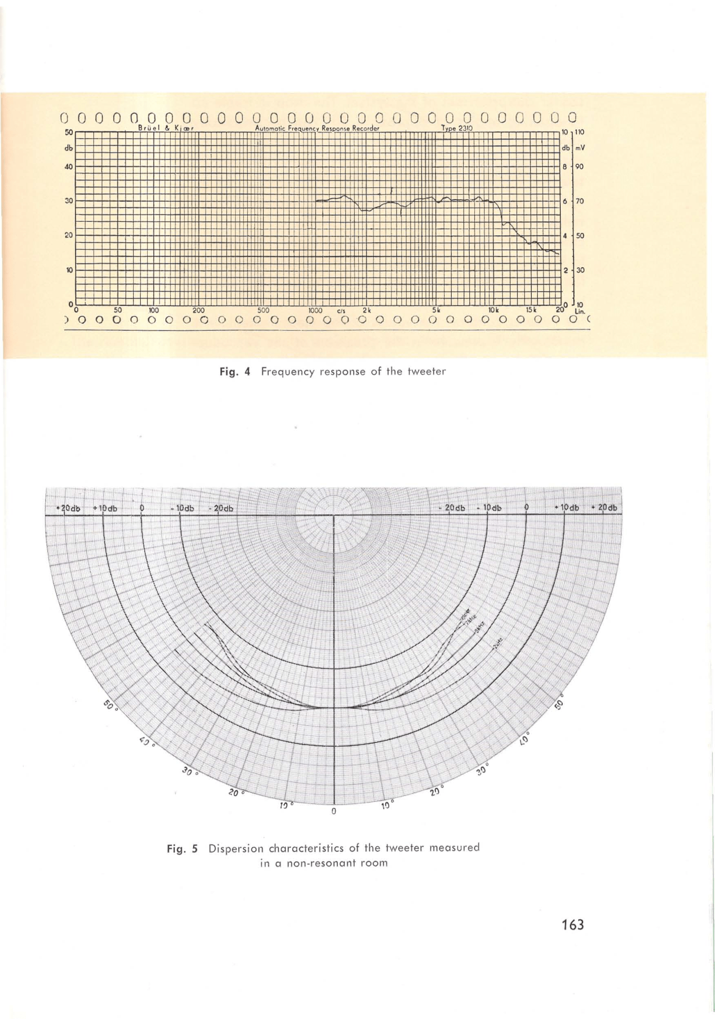

More than 60 years ago, Zeiss Ikon launched a truly brilliant tweeter horn with the phase plug integrated in the throat and an 'alternative' roundover.

Yeah I fluked out on a couple things. The horn before you take into account the roundover is around the size of the woofers sd (13") and due to the angle of the horn I was able to droop it over the woofer so that the two 13" circles about touch eachother from the perspective of the listener. I think this is important for a waveguide of this type for the purposes of coherency, (is it lobing?) I think the voicecoils in this configuration acutally lined up pretty good too. The main flaw in the design was the beaming up above around 4-5khz which would sometimes bother me. Very fatiguing. Im not sure if this was an artifact of the compression driver, the horn shape or the material itself. Of course these types of thigns often dont show up in measurements! I did abit of reading on concrete and it has a resonance around 4-5khz as well.Yeah, you got pretty close to the optimum with the first try, which is admirable. It took me about two years of numerical simulations to get to the same place 🙂 (the shape, the size, the material...)

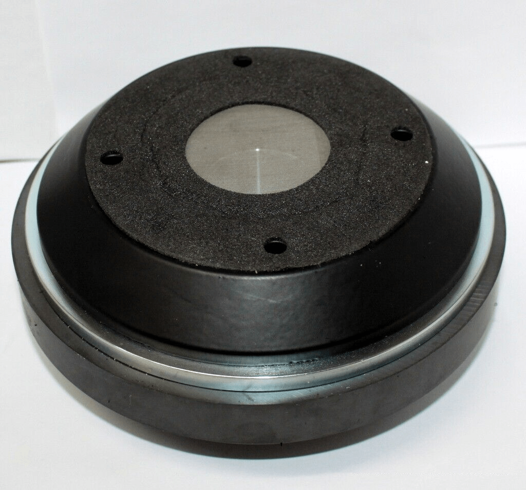

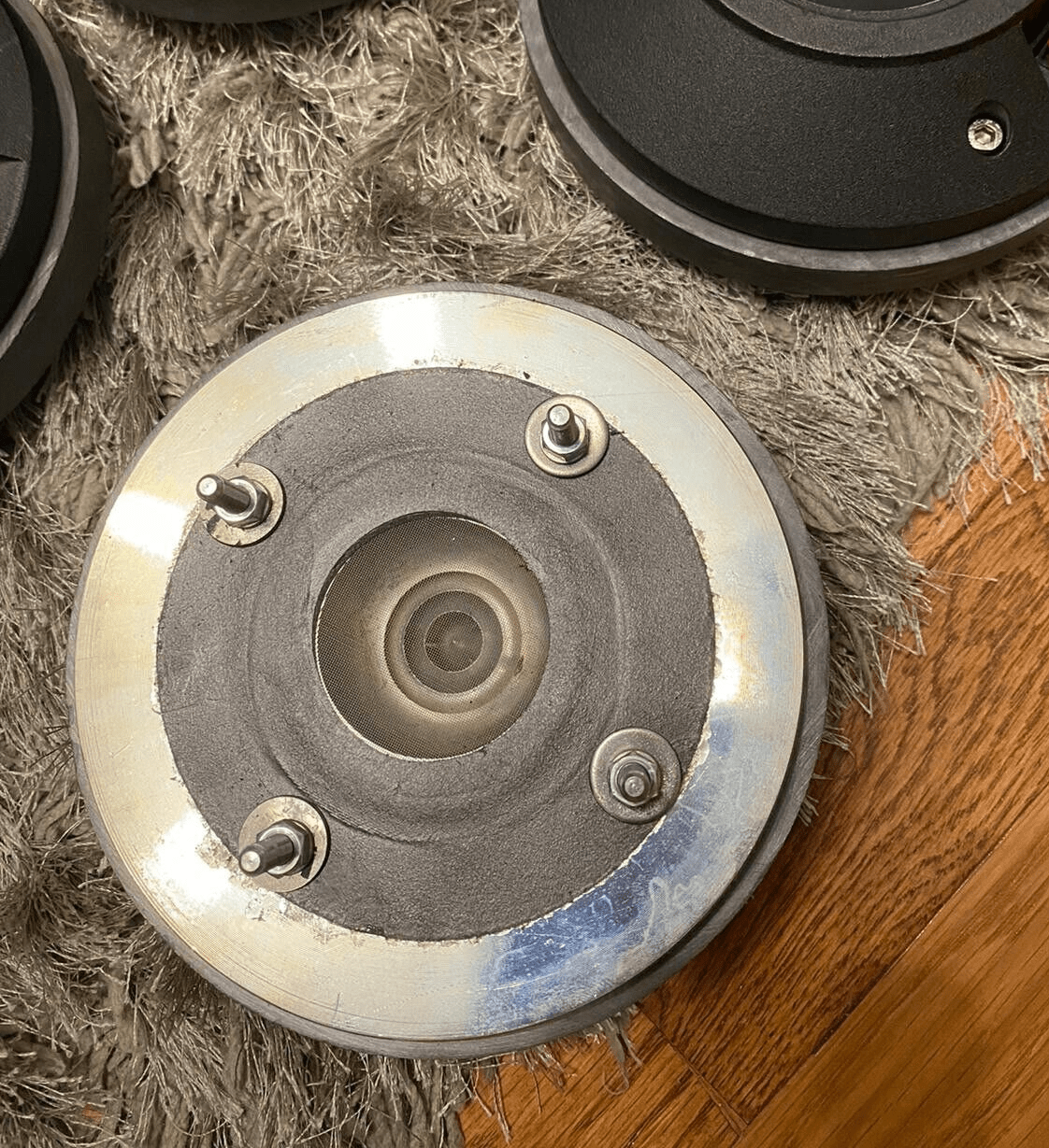

The beaming should probably be largely attributed to the snout (throat adapter) of the DE750-TN.
In the original DE75, the phase plug ends near the exit:
Despite the 2" throat, beaming can be minimized in combination with an OS(-like) waveguide:
With the motor being 7.5" round I should be able to create cancellation up to about where the horn looses directivity.

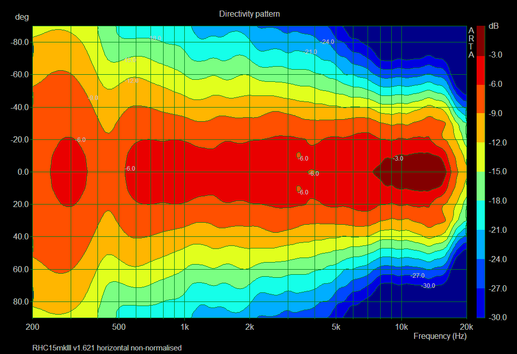

Beaming inherent to a 2" throat starts above ~7 kHz, the driver has little to no effect on directivity below that, so any beaming/narrowing around 4-5k must be the horn, typically a mouth diffraction. If you connect a truncated OS to a circular arc (as I gathered this is what you've done), this is exactly the kind of curvature discontinuity that causes this. This can be eliminated by making the whole profile a single smooth curve, as shown in my papers.The main flaw in the design was the beaming up above around 4-5khz which would sometimes bother me. Very fatiguing. Im not sure if this was an artifact of the compression driver, the horn shape or the material itself.
