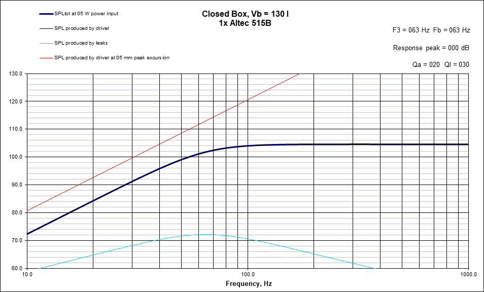

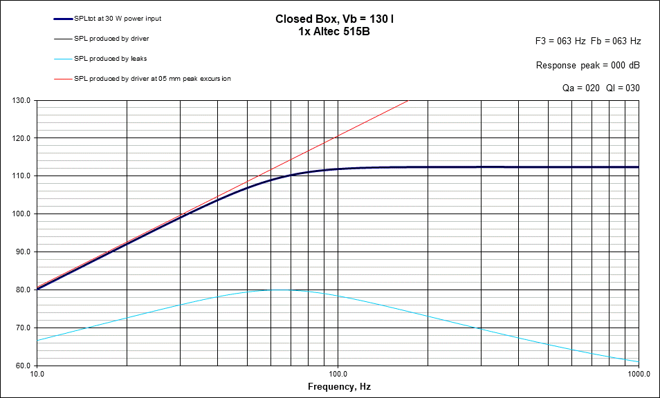

As best as I understand it, the maximum SPL from a sealed box arrangement is limited by the design parameters, i.e., the Vb and the driver's excursion, which, for the example below, happens at input power Pi=30W:
Are you saying that if one were satisfied with, e.g., SPL=105db, dow to 40Hz, which requires Pi=5W to about 100Hz and then used equalization, e.g., Linkwitz transform, to increase the power between 40Hz - 100Hz to achieve the required SPL at these frequencies:
the group delay would increase form the case above?
Regretfully, to my knowledge, although UniBox does have means to implement the equalization, it does not show group delay.

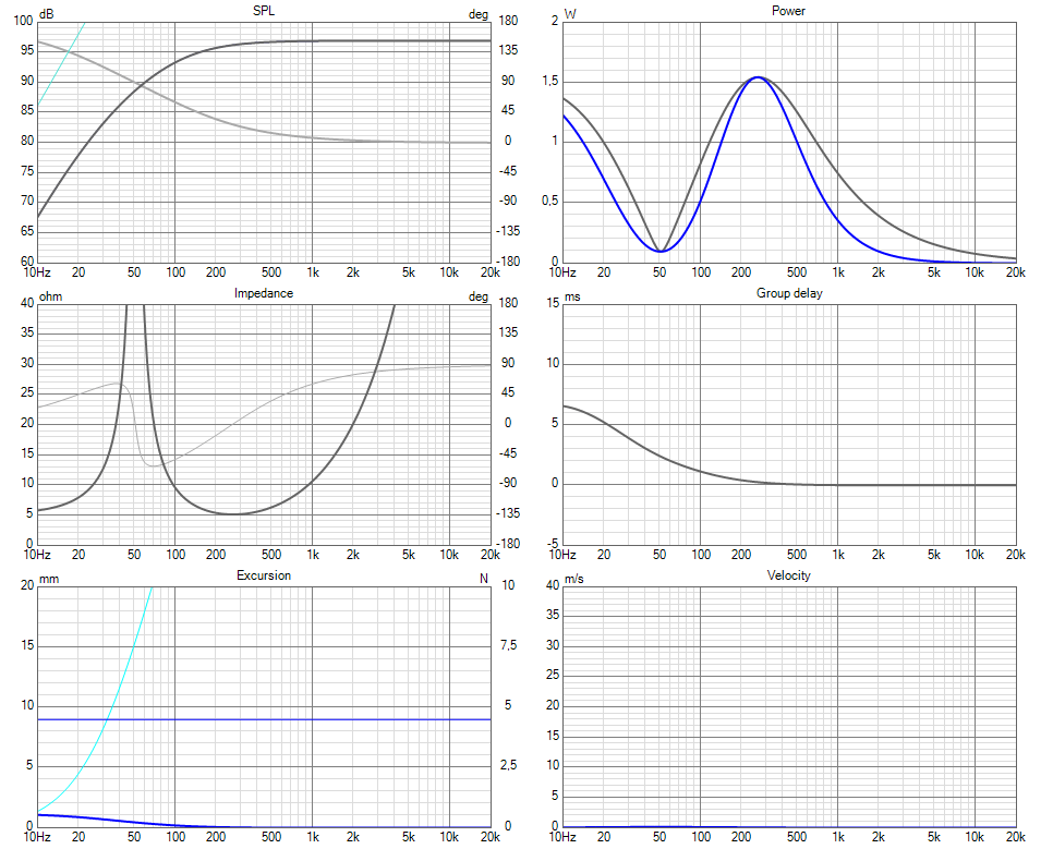

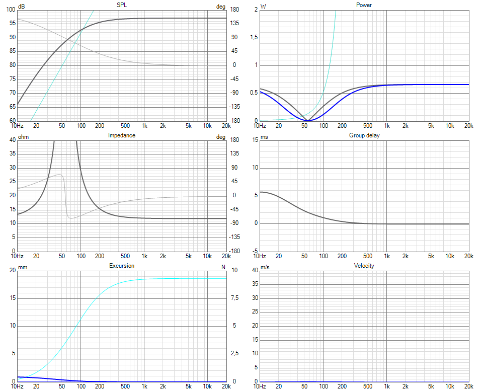

No, GD is more or less fixed around 5ms for suitable 15" drivers (quick & dirty sim of the 515B attached).

I am not sure how I am to understand the group delay (GD) graph. Is the GD shown for the non-equalized case or equalized case? If so, should you not show the other case to prove your point?No, GD is more or less fixed around (max.) 5ms for suitable 15" drivers (quick & dirty sim of the 515B attached).
What application are you using for the simulation?

Here's the B&C 15TBX100 in the same cab. Note the power requirement compared to the Altec.
App is VituixCAD.
Correction: GD is more or less fixed between 5ms and 10ms for suitable 15" drivers in the case of non-equalized sealed cabs.
The perceptibility of GD below 50 Hz is debatable.

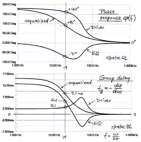

Yes, but my inquiry was whether the equalization will (significantly) change the GD. It seems plausible that it will change it somehow, after all, it is a filter. But, the question is how much and whether it can be perceived. If the change is significant, an equalization filter could be designed to correct the GD.App is VituixCAD.

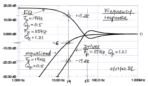

This is the part that is confusing and it is important to be clear about what the EQ is doing as that will make a big difference. EQ does not have to equal a change in slope.If a sealed box's very low end is extended by increased excursion via EQ, the EQ invariably negates the sealed's natural low-order rolloff.
Transfers/achieved acoustic high-pass, head towards the same as vented, so might as well go vented.....
You absolutely can EQ a sealed box and maintain the sealed boxes natural 12dB per octave roll off, it will limit the maximum SPL and use more power and excursion to get there.
You can also EQ the sealed box the resemble a vented one pushing the F3 down lower but rolling off at 24dB/oct below it.
You can EQ to follow the sealed response in the initial roll off and then get steeper lower down, or anything else that takes your fancy.
I think you are mainly advocating for good acoustic design by choosing the right drivers to work in the box type you want because not every driver will give a good response in a sealed box without EQ.
The only way it will significantly change the group delay is if the roll off slope is made much steeper.Yes, but my inquiry was whether the equalization will (significantly) change the GD. It seems plausible that it will change it somehow, after all, it is a filter. But, the question is how much and whether it can be perceived. If the change is significant, an equalization filter could be designed to correct the GD.

Well, if I recall correctly, the equalization, e.g., Linkwitz transform, actually decreases the roll-off slope. Hence my initial question to mark100.The only way it will significantly change the group delay is if the roll off slope is made much steeper.

Ultimately the final rate of roll off is the same 12dB/oct but it can be pushed so low that it is hard to see in graphs.Hi fluid,

From the man himself,
"A majority of drivers exhibit second order highpass behavior because they consist of mechanical mass-compliance-damping systems. They are described by a pair of zeroes at the s-plane origin and a pair of complex poles with a location defined by Fs and Qt. The circuit above allows to place a pair of complex zeroes (Fz, Qz) on top of the pole pair to exactly compensate their effect. A new pair of poles (Fp, Qp) can then be placed at a lower or a higher frequency to obtain a different, more desirable frequency response."

Ah, that is a great description. So the transform is essentially cancelling the original pair of poles, and substituting new pair of poles. However, the original zeros are left unaffected; the equalization curve raises (albeit eventually to a limit), so the resulting equalized curve should be less steep, although perhaps not appreciably so."A majority of drivers exhibit second order highpass behavior because they consist of mechanical mass-compliance-damping systems. They are described by a pair of zeroes at the s-plane origin and a pair of complex poles with a location defined by Fs and Qt. The circuit above allows to place a pair of complex zeroes (Fz, Qz) on top of the pole pair to exactly compensate their effect. A new pair of poles (Fp, Qp) can then be placed at a lower or a higher frequency to obtain a different, more desirable frequency response."
