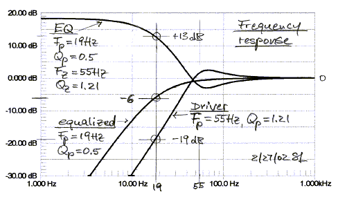

Hi fluid,
Taking the idealized case of a response that I posted, the equalization curve should (asymptotically) approach the modeled/measured response at higher frequencies, then raise to compensate the drop of the response and again (asymptotically) approach level. Such can be described, as, e.g., 1+(k^2-1)/(1+k(f/f_b)^2), wherein f_b is one-half of gain/loss.
I may be overlooking something, so can you give me an example of equalization that would result in increased GD and reason why would anyone employ it?
I do not wish to beat a dead horse, much less to deride mark100, but the issue is of interest to me. I had discussed with someone the idea to design an equalizer that would compensate the GD of a vented enclosure, thus "to have a cake and eat it too".
Kindest regards,
M
My simplistic mind cannot think of an example of an equalization that could make mark100's statement correct.I'm just trying to show that what mark said isn't really right in all cases, and incorrect for a basic LT EQ.
Kindest regards,
M

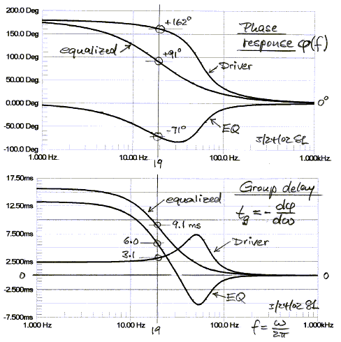

Hi fluid, hi M,Ultimately the final rate of roll off is the same 12dB/oct but it can be pushed so low that it is hard to see in graphs.
From the man himself,
"A majority of drivers exhibit second order highpass behavior because they consist of mechanical mass-compliance-damping systems. They are described by a pair of zeroes at the s-plane origin and a pair of complex poles with a location defined by Fs and Qt. The circuit above allows to place a pair of complex zeroes (Fz, Qz) on top of the pole pair to exactly compensate their effect. A new pair of poles (Fp, Qp) can then be placed at a lower or a higher frequency to obtain a different, more desirable frequency response."
Linkwitz analysis is small signal analysis, and yes there it holds true that the rate of roll-off can be held to 12 dB oct.
But that not's reality when it comes to driving a sub with large signal.
Large signal analysis must take excursion into account.
If a sealed sub is simply EQ'ed up with shelving as per the above diagram, it will run past xmax or at least into excessive excursion and distortion at the lower end, when trying to use the sub at its normally specified full SPL.
A way to control over excursion when using a Linkwitz transform or shelving EQ boost, is to use an additional electrical high pass (like is mandatory for vented designs).
Alternatively, parametric EQ's can be used for selective low freq boost, without over boosting very low in freq.
Both of those techniques create additional phase rotation and group delay...simply because they both net out to create a steeper acoustic high-pass response at the very bottom end.
So with sealed, i think there are 3 basic options:
*Stay within xmax for true sealed 12/oct rolloff....with its implied SPL and low frequency limitations. This at least keeps the 12 dB natural rolloff, and associated low phase rotation/group delay.
*Or put in an additional hpf, or use para EQ for boost....to gain safe excursion limited SPL. This acts more akin to vented's rolloff, phase, and group delay.
*Or go with more sealed displacement to achieve SPL desired at low corner. Bigger drivers with more xmax, or more of them. No boost at all. Shelve down excess response above low corner EQ.
The true gold standard imo !
edit: Ps...of course guys, nothing personal at all...just good discussion among friends. And always happy to be corrected too, when need be 🙂

That being said in practice a LT plus a carefully chosen first order HP will give adequate protection against higher cone excursions, with very minimal penalty for additional group delay.
In this case the work flow is as following;
Design a LT with a desired frequency with a Q of 0.707.
Add an additional 2nd order HP at the same freq as well at a Q of 0.707.
This creates a nice Linkwitz-Riley roll-off with a Q of 0.5, meaning a very steady group delay.
Substitute the 2nd order HP with a first order HP.
In this case you have to fiddle a little with the Linkwitz Transform Q-factor as well as frequency.
As well as the frequency of the first order HP filter.
In theory textbook wise, this won't give exactly the same results.
But the deviation will be below -24dB or so, so nothing we have to worry about in practice.
Especially when one takes the low-pass filter also into consideration. 🙂
I can show some graphs if people find that easier to follow.
One important fyi, this DOES NOT work with the latest WinISD, since it has a major bug with Linkwitz Transform filters!!!
edit: Btw, we will have an increase in group delay anyway because of the lowpass filters.
But using a LT or a BR without any kind of HP (even first order) is not a good idea.
This is true for basically any kind of boosting actually.
