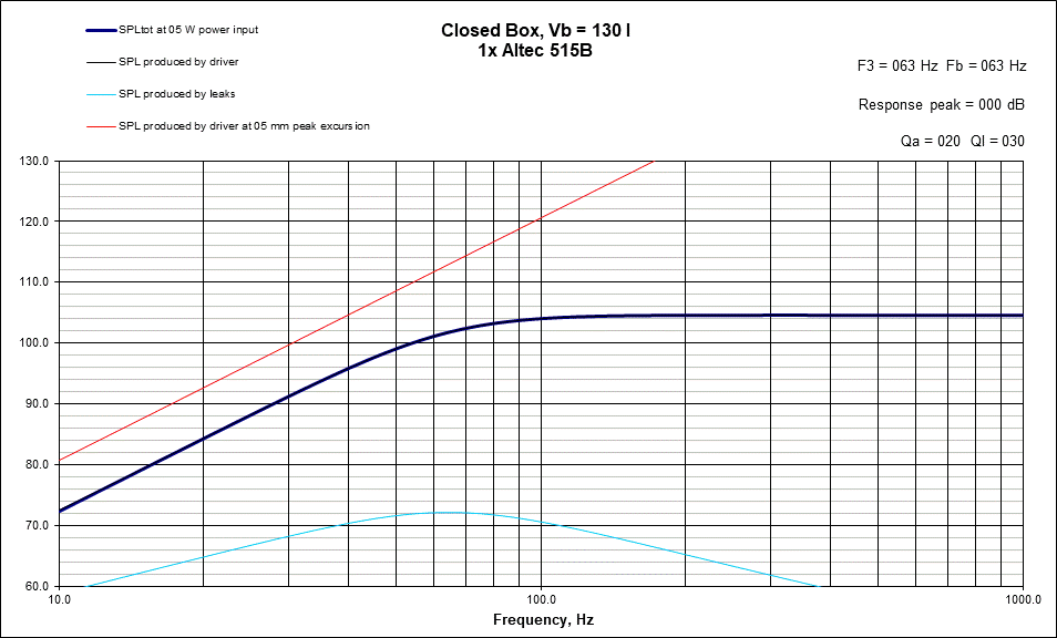

Greetings all who responded to the sealed box equalization issue.
I am still not sure, what the problem with equalization is and why a high pass filter is required.
Consider the below attached image:
For the pupose of discussion, the modeled response has been made parallel to he excursion limit by choice of the enclosure parameters and a (small) series resistor between the amplifier and the speaker. Thus, as long as the required equalization is less or equal the difference between the modeled repose and the excursion limit, the excursion is withing the rated - not maximum - limits.
If such an amount of equalization does not satisfy the required SPL over the frequency of interest, of course, different displacement either by choosing different driver or additional driver(s) may be needed. By the way, this has never been disputed, cf. e.g., excerpt form fluid's post 10,973:
I also disagree with the notion that equalization is a small signal analysis. The attached image shows allowance of 9 dB of equalization.

Hi M, would you post the drivers T/S parameters and the box size you're using? Along with the particular EQ (s)?Greetings all who responded to the sealed box equalization issue.

I'd like to take a look at excursion in Hornresp. thx
Hi mark100,
Of course, I will be happy if more people looked at the simulation, and point out any possible mistake(s) I might have made. Please check your p.m.
However, please note that this simulation was done as an exercise to support the points I made and no equalization had been applied. I actually built a different enclosure for a different driver, and I intend to measure it once the weather permits.

With "small signal analysis" we mean behaving according to T/S parameters (which are measured with a small signal) as well on a linear fashion.Greetings all who responded to the sealed box equalization issue.

Thank you for the clarification. So, from a practical perspective, how can one determine the extent to which they can be relied upon? For example, if the driver is used within some of the limiting parameters, e.g., below power rating, within Xmax, etc.With "small signal analysis" we mean behaving according to T/S parameters (which are measured with a small signal) as well on a linear fashion.

If Klippel information is available, that really really helps.
Otherwise my only proper answer is, by experience and trying.
Still, I have seen drivers (PA in this case, but doesn't matter in general sense) were the cone literally kinked under heavy loads. This was even from a pretty known brand actually.
In my opinion, a better approach is the other way around.
So build in some safety margin, or use something like a simple 1st order HP filter (or a compressor/limiter in some cases, although doesn't really apply to home hifi).
Not a crazy amount, but just enough to prevent the speaker going into kamikaze mode.

As I understand, it implies proper selection of enclosure/driver parameters, so the the required max SPL is reached only occasionally, as noted several times throughout the discussion.
