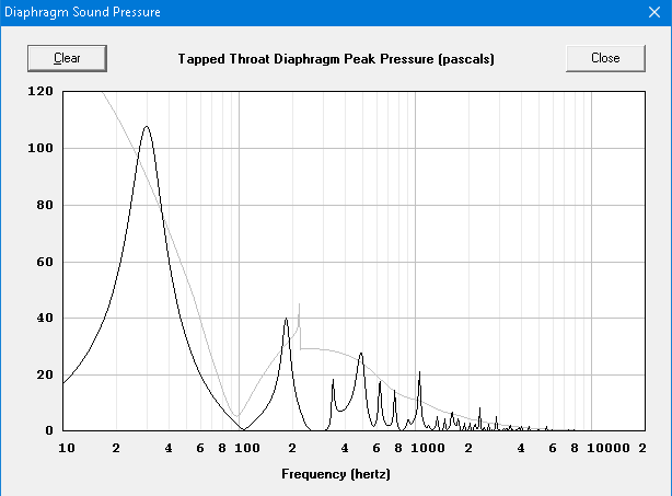

So the smaller you are gonna make this volume, relative to the Vd = Sd * xmax, the higher the "pressure", the higher the (asymmetric) loading on the speaker. This asymmetric loading will create quite some 2nd order distortion and probably also quite some IMD (inter-modulation distortion).

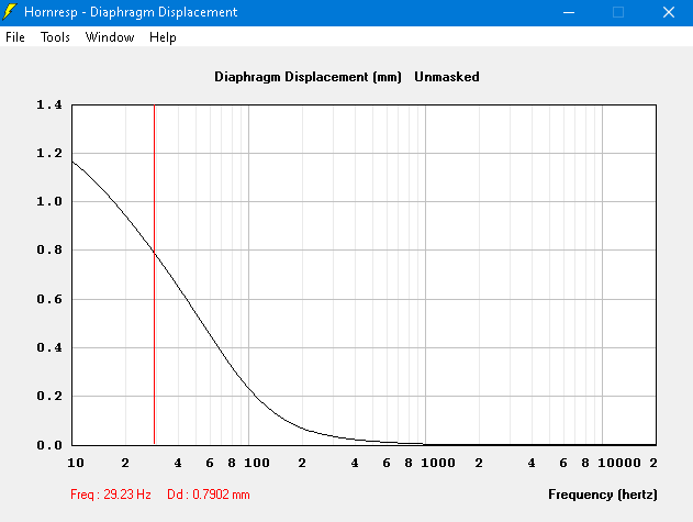

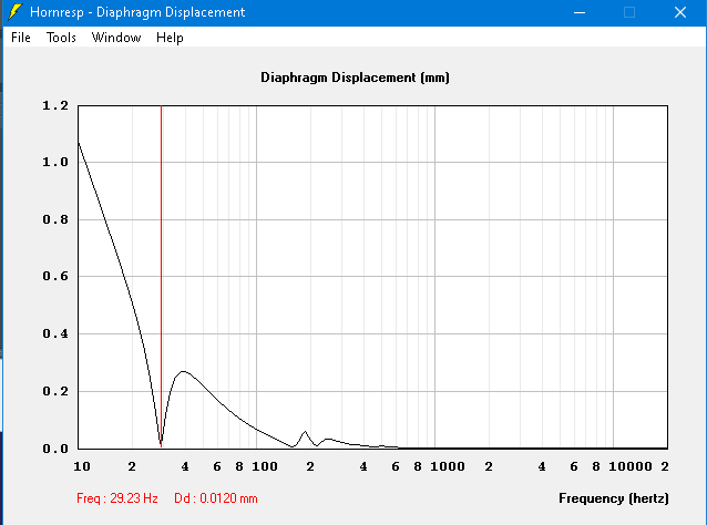

I simulated a TH(Fb20hz) and a Sealed enclosure of similar size and volume matched at 30hz
Potentially, the 30hz note will generate more pressure derived 2nd order distortion and IMD in TH than the Sealed enclosure.
Excursion is minimal in both models....
Regarding the 'compression distortion': briskly correctly explained the problem above. The concern is that the excursion of the driver will modulate the box volume and thus cause a nonlinear air compliance. However, this nonlinear spring will simply add to the drivers own typically nonlinear suspension and the net effect will still typically be domniated by the drivers typically progressive suspension. Such Kms(x) disortion mostly causes harmonic disortion down towards fs and below (where it is not much audible) and very little IMD higher up (see our blog post Low frequency harmonic distortion is almost inaudible. So what’s the point of low distortion drivers? - PURIFI). Again, this mechanism comes from changing the box volume and has nothing to do woth the drriver design.
A related issue is that the driver surround deforms in a non linear way due to the high back pressure in a small selaed box - essentially a nonlinear modulation of the the drivers effective radiating area Sd. This causes a substantial modulaiton of the air spring stiffness (stiff ness of the piston is proportional to Sd squared).

In my endeavor to find a reason to not vent. It would appear that Pressure is a non issue within the realm of good vented designs....The 2 lines are, the Similar sized Sealed and Tapped Horn.

The dip is due to the resonance of the port with the box. I don't see (or I don't understand) your view of the situation.
At Fb the impedance of the box on the driver goes very high, which is why the cone hardly moves. When the cone ceases to move, the back EMF goes very low and the impedance dips - the impedance peaks being entirely due to back EMF since the static impedance is flat in that region.

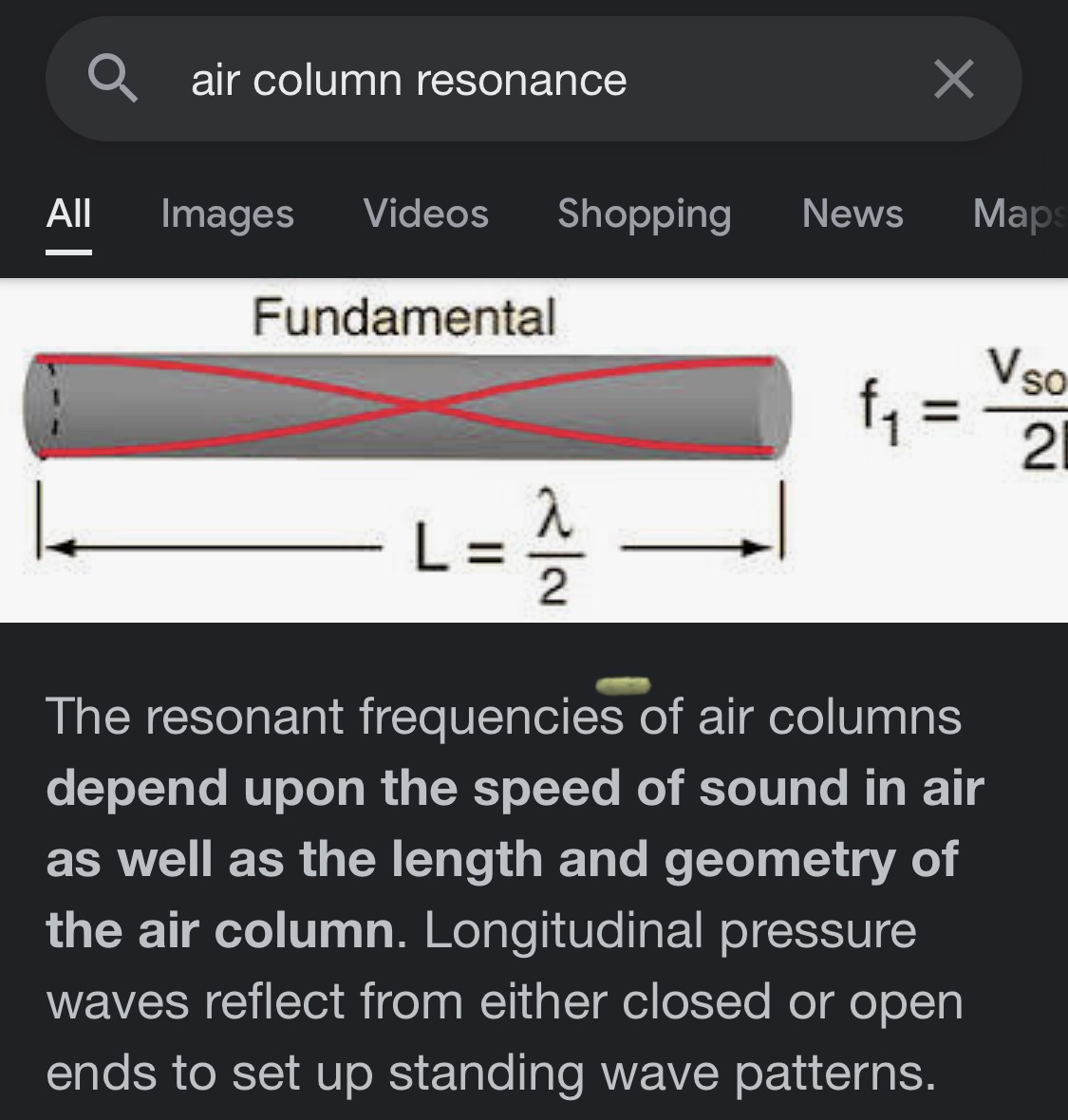

I need to revisit quarter wave theory. The first thing I need to realize is that A reflection is needed for standing waves....So no matter if the pipe is open or closed from the radiation source......a reflection will be sent back towards the transducer...Correct?
And then pressure....looking at a driver played into a open end line. Pressure seems to modulate.... How?
It seems to be based off of harmonics....It would seem to me that pressure would be relative to diaphragm velocity, nothing less. I guess I am not factoring in the reflected pressure....sometimes more or less energy is reflected back, that must be the harmonic part. My guess is that peak pressures are a combination of standing waves where the 2nd reflection is in phase with the source signal, the 2nd reflection being the one coming from the open end, and rebounding off of the transducer or just in phase on the way to the transducer????...and the increase of excursion required to make bass neutral to our ear.
This is correct, but the reflections of these two conditions are 180 out of phase with each other, so very different things happen. And then there is the radiation loss to consider. But at any rate, you seem to be talking more about transmission lines than base reflex. Very different things.

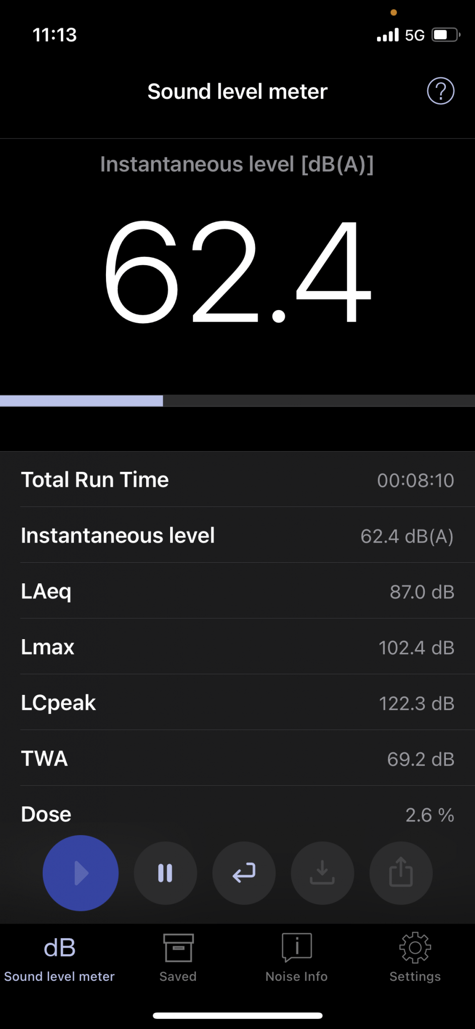

This is a sample of the dynamics from front seat at the Imax tonight showing of Black Adam
@gedlee My dilemma is that I watch the spl meter display numbers (80-90db range) I can hit at home but the experience is unsimilar. The way the LF felt in the theater, is not on par with my experience of LF, so far, with the single dual 18" sub in nearfield...I feel that the difference is attributed by high Sd but I would like to be certain and understand it on a technical level...
I've hypothesized some other things as well but it really means nothing without science backing it.... radiation mass/impedance is interesting but maybe its this; The larger room of the theater, reduces reflective energy, increasing the portion of direct energy to reach desired levels... that actually sounds like a likely conclusion.
Keeping thd at a low percentage, I predict that 90db bass, outside, is a much different experience than 90db bass in a domestic room. Direct vs indirect being the metric of significance, and not so much Sd.
