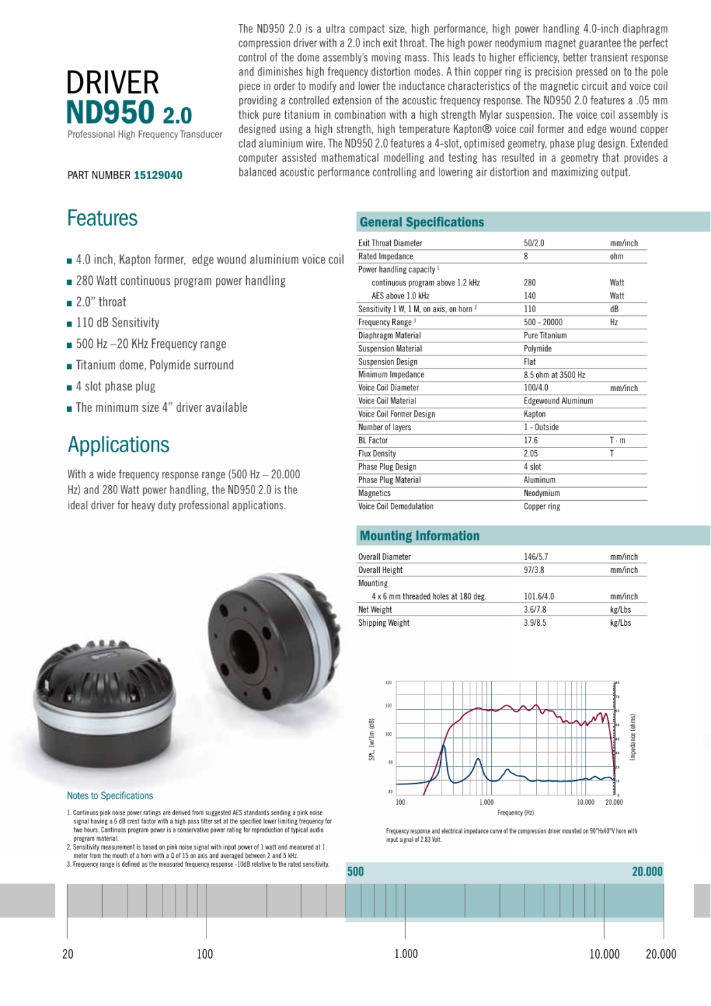

"The horn does play a big role. With that said. Even on the giant 2360A the Axi2050 still runs out of gas due to diaphragm displacement limitations near 300Hz. This isn't really seen until absurd output levels with more than 10 volts applied = REAL LOUD, so technically you could get away with a 300Hz Xo on that horn in most cases."
https://data-bass.ipbhost.com/topic...pression-driver/?do=findComment&comment=24944

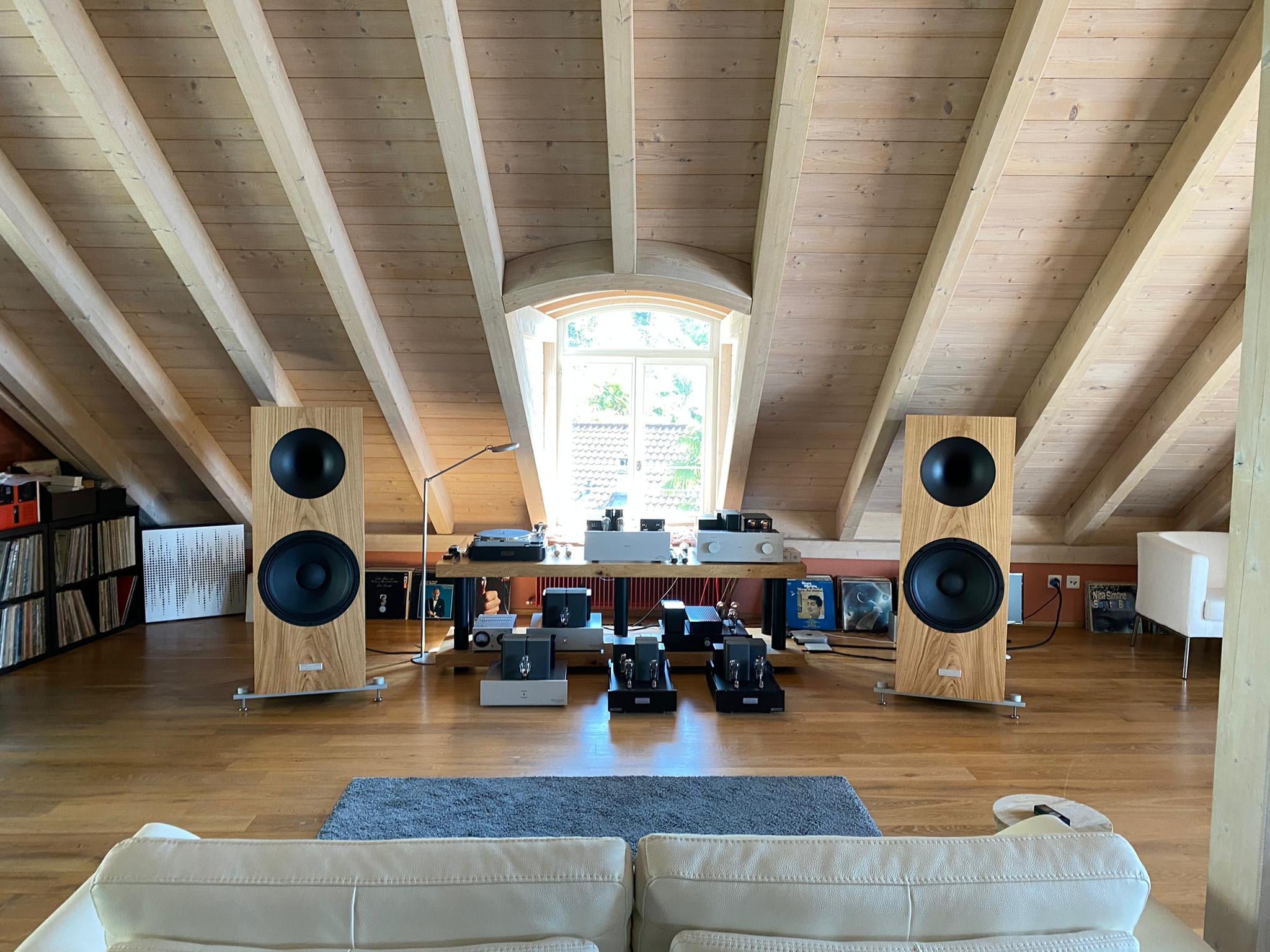

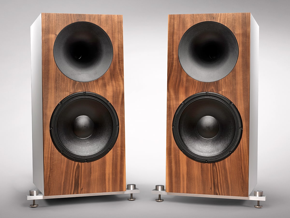

300 Hz seems plausible, even with an undersized horn, judging by the products from a Swiss guy, mentioned earlier in this thread.
He recently launched two 2-way systems. The first features a 15" + 4" comp. driver and his latest creation is a scaled-up version based on the same recipe: 18" + 5" dia.
According to the specifications, the crossover freq. of both systems is 300 Hz.
The 15" is probably equipped with the RCF ND950 2.0, because he almost exclusively used RCF drivers before.
For the 18" version, the Axi2050 is the only option.
Here you can watch a short video of the 18" in action.
Can we see the polar for this speaker? Is the 1" on a wave guide?:1"/15" aktive speaker from ex meyer sound founder in switzerland
.... and was it form one of their current models of PA speakers ?The 1" driver outperforms 2" drivers, but is faster. AP uses Ferrofluid in all their drivers. You can cross low and you can go loud and fast! Impressive!
Judging by the cones, dustcaps and surrounds, the 15" looks like a B&C and the 18" like a Celestion.anyone know what 15 or 18 is used in these swiss speakers?
The CD in those clips sound like they are straining to me.
Indeed, definitely a recipe for headaches in the long run.
PP tube amps combined with 4" VC's + a big compression driver behind a tiny horn, crossed way too low; you don't even have to listen to the clips to predict the outcome.

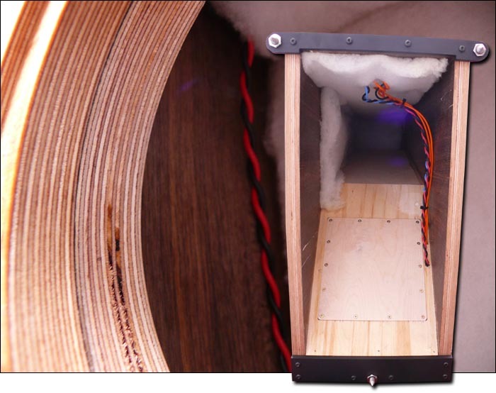

https://tobian-soundsystems.com/en/hornspeakers/15fh-fullrange-hornspeakersWhy is this being called a back loaded horn? Typo?
@ 99dB 1 watt good luck with that.That's why it doesn't seem to have real low bass reproduction.
