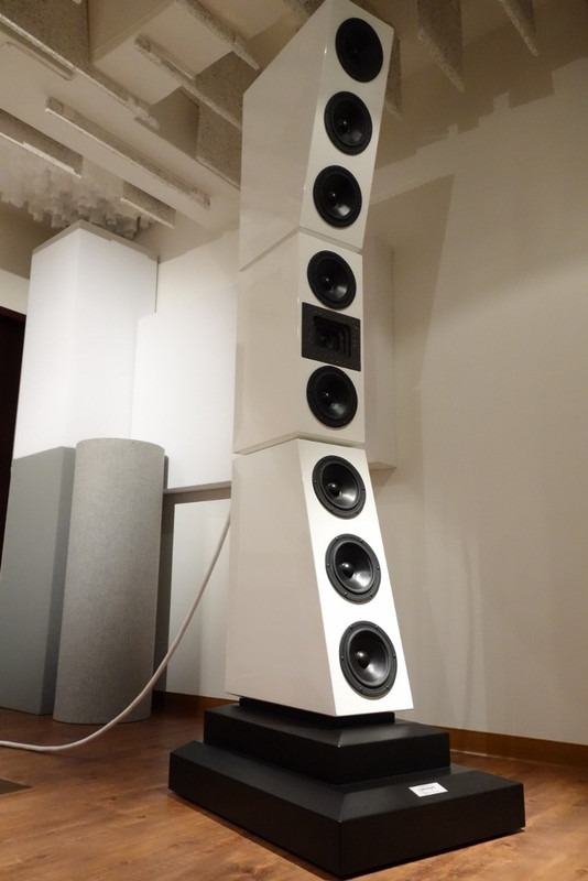

On my large MTMs the sound does also seem to come from the horn alone.
Exactly.
After tasting some MTM honey, even with a horn-loaded dome tweeter, it's hard to go back to regular TM or TMM systems.
Some (potential) lobing and cancellation issues are dwarfed by the advantages of the vertical embedding of the mid/high section by woofers and the coupling with the room (at 70% of the floor-ceiling height).

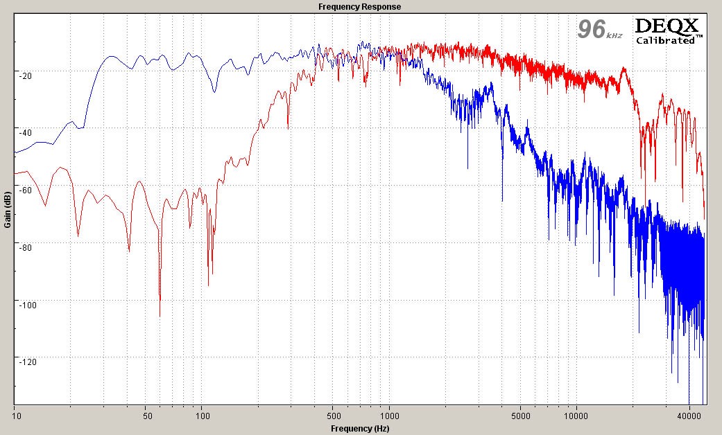

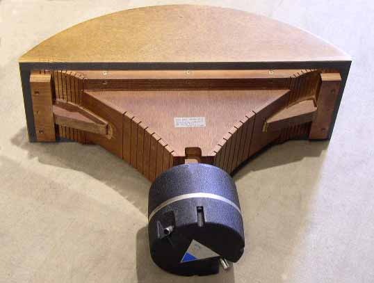

TD-4001 is rated from 600Hz-20k. How can this be x-over-ed at 425Hz?
Translated from Japanese:
"What is important here is the characteristics of Rey Audio's RH-3 wood horn. I don't think it has been open to the public in the past, but it is loaded up to almost 300Hz, and you can see that it is a very excellent design. Compared to the Pioneer (EXCLUSIVE) TH-4001 horn, the difference is that the low range around 300Hz is slightly extended, and both are excellent horns as they are reputed.
This 300Hz cutoff RH-3 wood horn is combined with the DEQX digital channel divider's rapid cutoff characteristic (96dB / oct) and the FIR filter with zero phase rotation characteristics to make full use of the RH-3 wood horn. It is the setting of our RM-6V that lowers the crossover to the low frequency limit of the horn load.
By setting the crossover as low as possible and expanding the band covered by the wood horn, most of the band for female vocals and trumpets are now reproduced by the horn.
Female vocals, which had been influenced by the high frequencies of the woofer and had a slight "nasal signature", have become even clearer, and the muted trumpet has become more realistic."

Many thanks. 96/oct... Now some things are becoming clearer. iirc the RH-3 has only a slightly larger mouth because of the flare but almost the same length as TH4001. So no big difference wrt loading. Both are excellent design but obviously the designers may have "overseen" that the fin arrangement is sub-optimal.

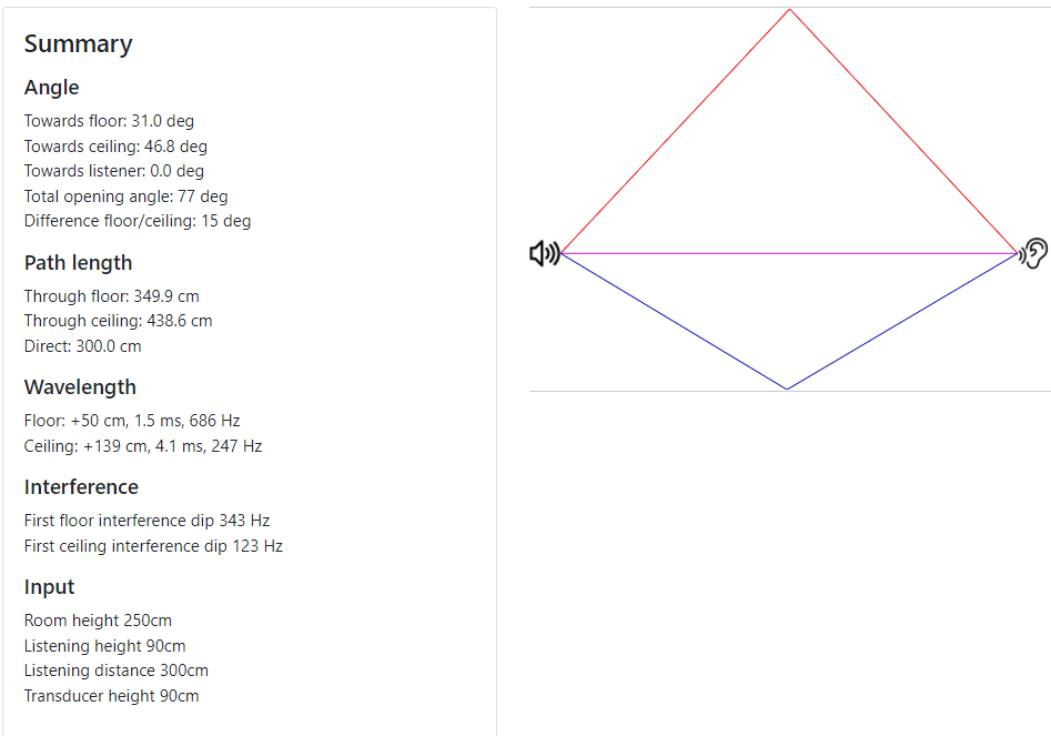

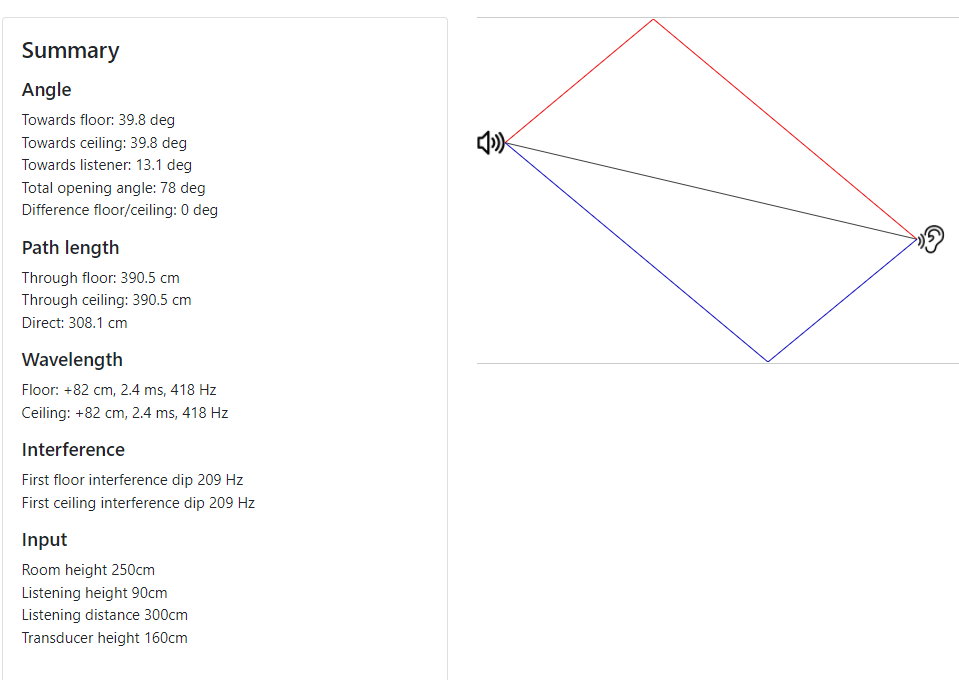

Hi, can you talk more on this or where to find more info? Speaker height doesn't come up very often in the forums, especially vertical reflections in mind.
By 70% do you mean that the speaker (tweeter) is about as far away from the ceiling than the listener is from the floor? In which case angle towards first specular reflection point on both floor and ceiling is maximized (equal) giving most attenuation towards both these first vertical reflections. Also delays for both these reflections would be about the same.
But the speaker is now quite high leaving the listener quite far vertical off-axis. Do you then tilt the speaker downwards towards listener? In which case the ceiling would be again at high off-axis angle and floor low, like if the speaker was around listening height, except the delays of reflections would still be different for this position than typical close to floor speaker height. How does it work out, why is this better than having the speaker lower at listener height? If it is then do you know why? because the delays through floor and ceiling are equal or something else?

All true and such a solution is not without compromises (which loudspeaker concept is that?).
You lose some, but get a lot in return.

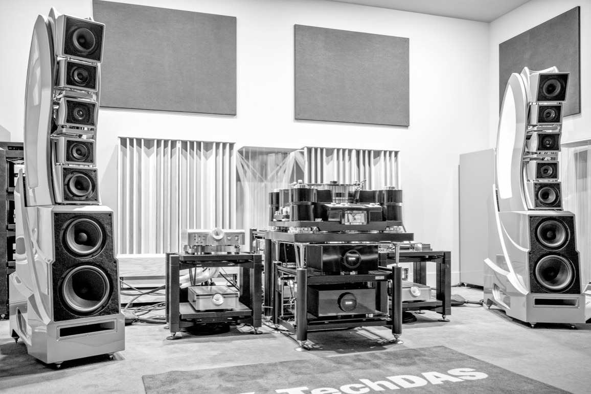

A sub-optimal example of an MTM-concept are the top models from Wilson Audio, because of the asymmetry in the vertical plane and the unnecessary complexity.
When complex solutions are applied to overcome certain acoustic phenomena, it's often at the expense of the reproduction quality.
The magic of an array-like setup is lost because the lower frequencies are only coupled to the floor and the mid/highs are not embedded symmetrically.
This solution is much simpler, 20x cheaper and makes more sense imho:
