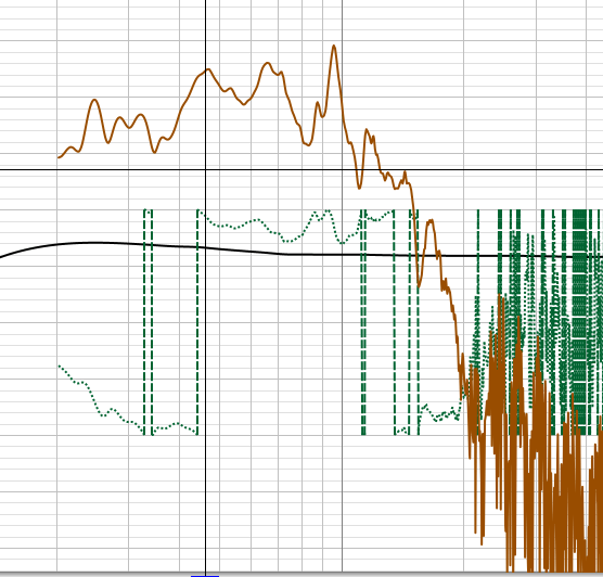

Bass guitars can make other noise the don't involve plucking if you are familiar....I don't play bass so I dont know the correct term for when a bassist bumps the strings to create a LF bump....if you are a musician you know what I am talking about it...bassist are known to use their hands to create percussive notes. In the video the "bass bump" ie the percussive note the bassist is creating, is at about centered slightly above 20hz according what the rta looks like,
For a free lessen turn on just your sub and watch the bassist's hands during the groove I time cued. Its on 2 and 4

So can many other instruments, have a listen to this and analyse the spectrum, the thumps and pops are very low.Bass guitars can make other noise the don't involve plucking if you are familiar....
This feels quite different on something that can reproduce the infrasonics vs something that cuts them out.
