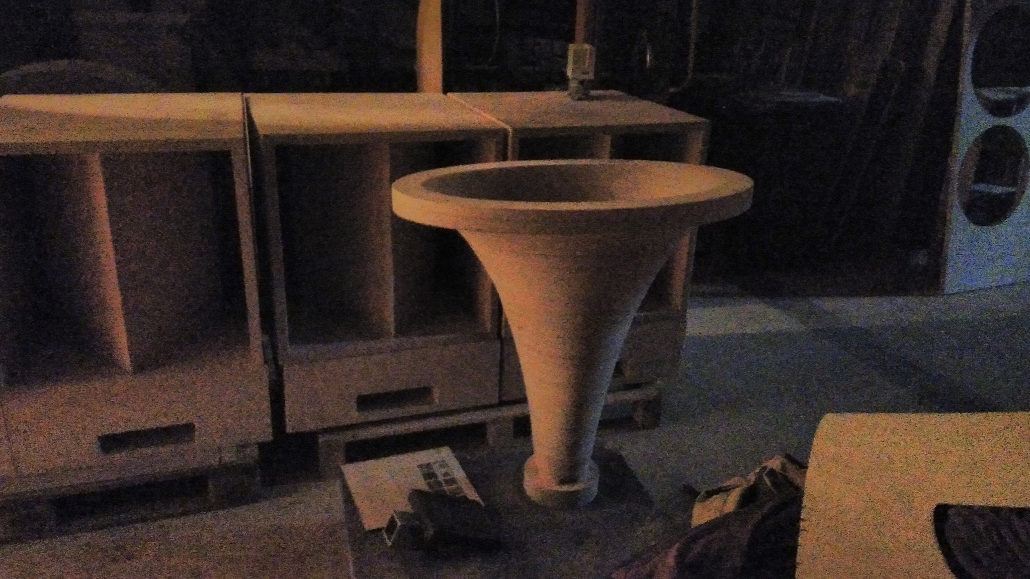

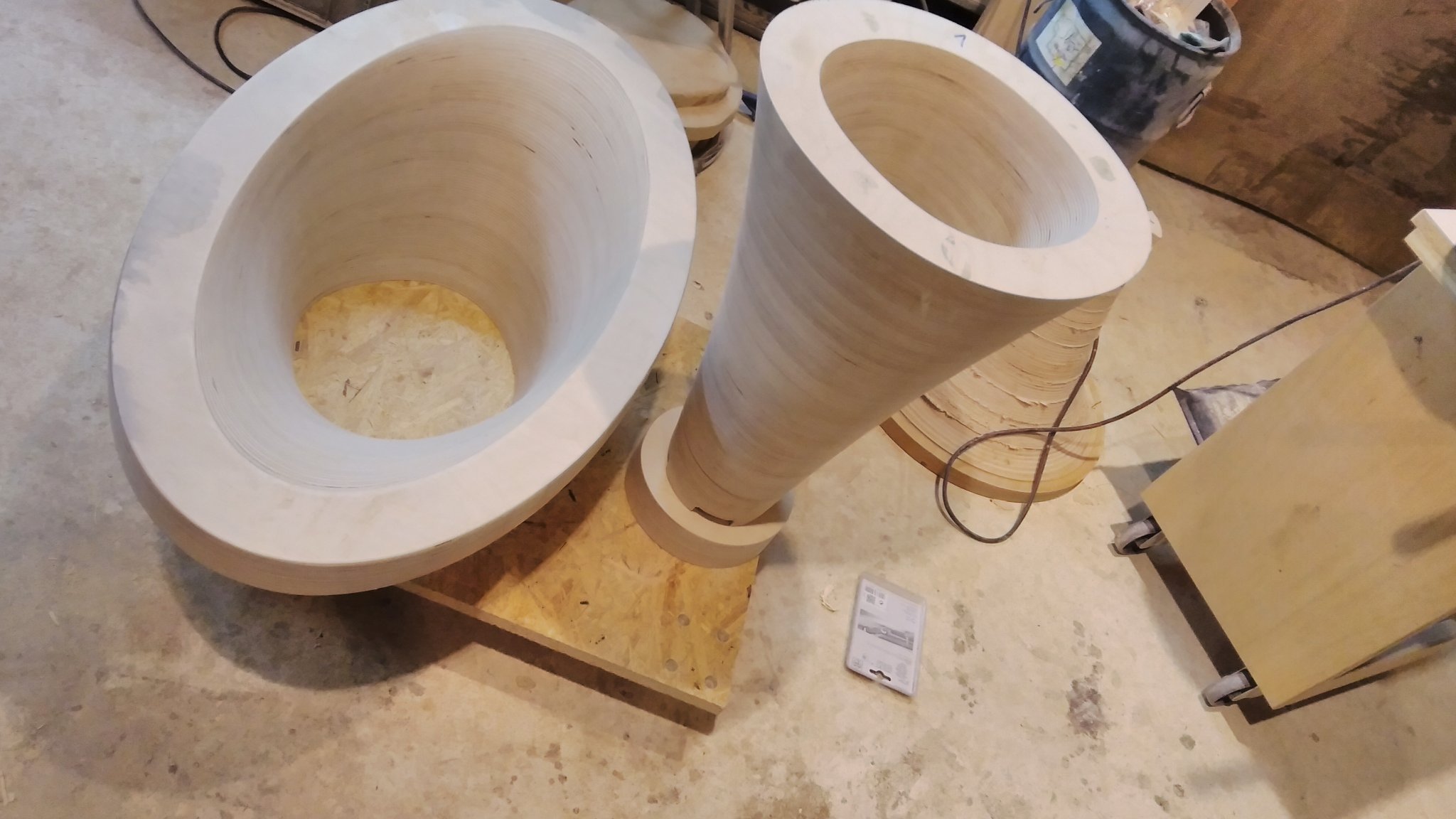

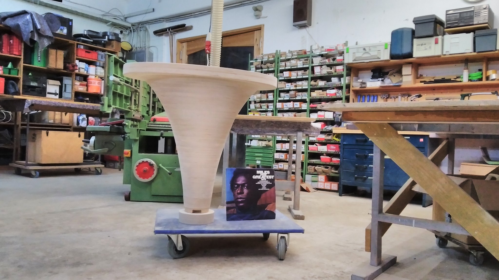

I don't think they know how they want to ship it to me....they suggested in separate pieces, but I rather receive it whole....I think I might have to spring for a crate...anyone have advice on shipping large things from Germany?
Where are the trumpets located? Maybe I can help with shipping? It looks as they are located on the other side of Stuttgart airport, 10 miles from me?
