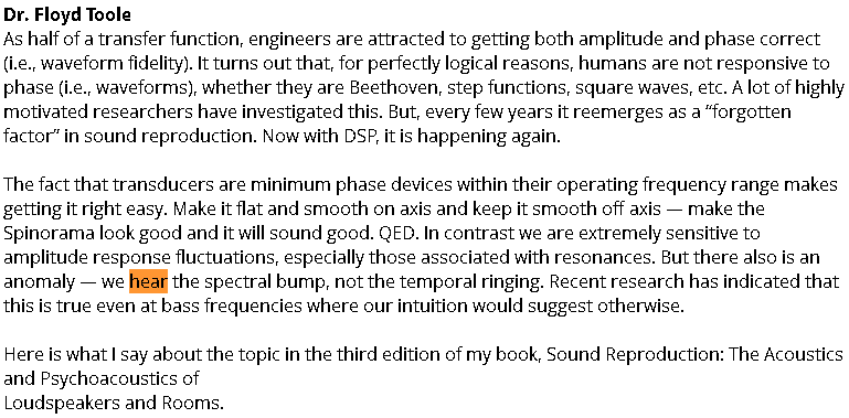

The snippet was from this link here ->https://audioxpress.com/article/zero-phase-in-studio-monitorsView attachment 1023838
I was reading the part about "we hear the spectral bump, not temporal ringing....Thats not 100% true right? I mean all the driver manufacturers are aiming to rid diaphragms of "temporal ringing" for no reason apparently?
Linear phase reproduction has its place, primarily in professional sound installations or shows where multiple speakers of different size and configuration are needed to achieve the required coverage and pressure level. Knowing that each box is ‘phase compatible’ to begin with makes the job of alignment and tuning easier and more predictable.
In and of itself, in theory the removal of two or three phase rotations isn’t audible. Properly running a listening test for this is quite hard though, as it’s difficult to only ‘fix’ the phase response without making changes to magnitude and polar behaviour at the same time.
The other issue is the temptation to let automatic tools make a ‘magic’ impulse response inversion that makes a lovey chart at one position, but creates a horrible mess and bad sound everywhere else.
But as ever, you’re quite far ahead of yourself here camplo. I wouldn’t worry about trying to make an FIR correction until you’ve sorted out everything else.

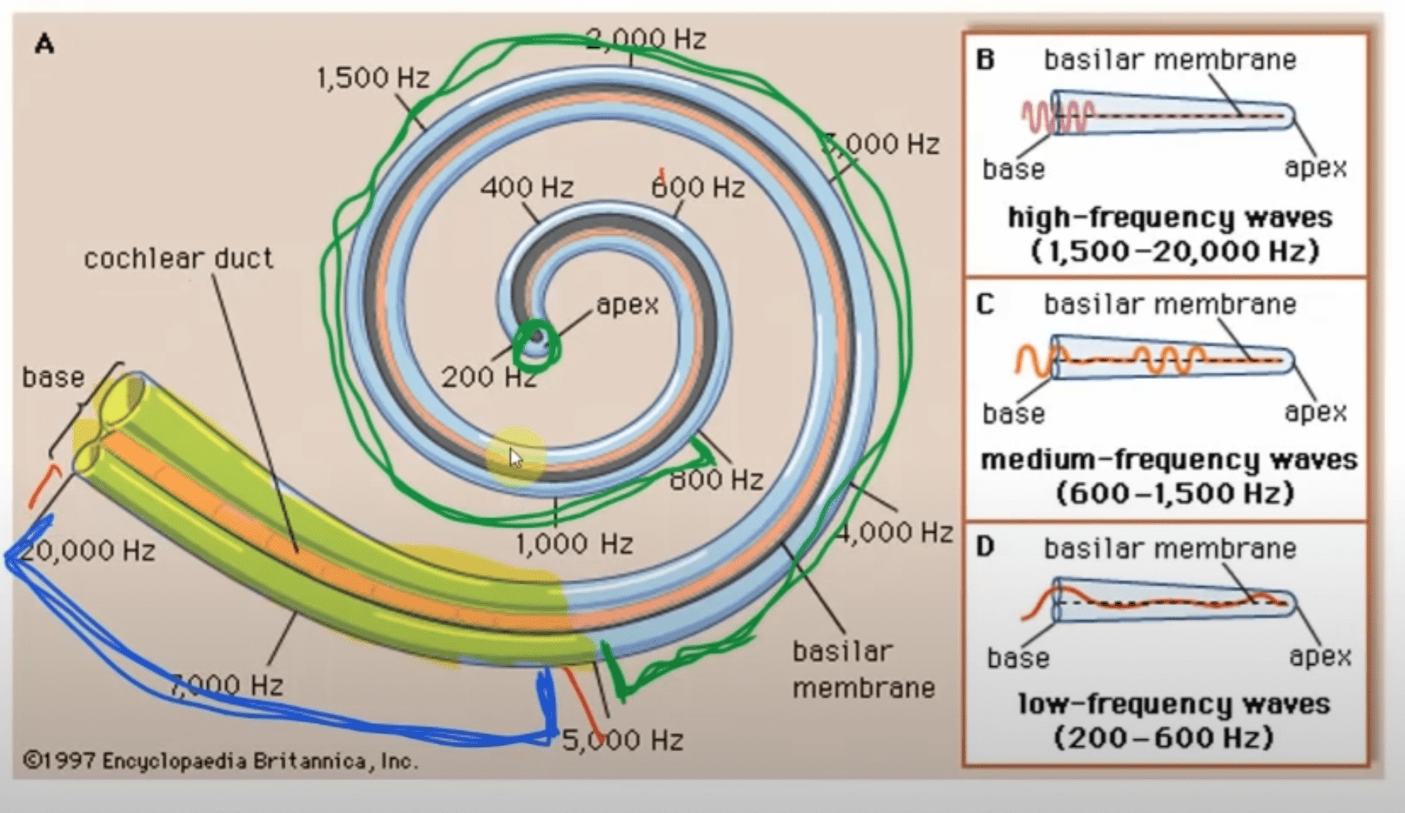

This is the range you 'naturaly' loose with age. And which is more easily fryed too ( it is closer to tympany so exposed to an higher degree of energy than the parts closer to the apex of cochlea- the vibrations are transmited through a fluid so there is damping at play).
I don't think there is a range which is more suceptible to damage because: if you experience something really bad in the low end, there is chance this will be definitive. If you have tinitus you could 'live' with them ( not easy and depends on severity but much less annoying than hyperacusis...).

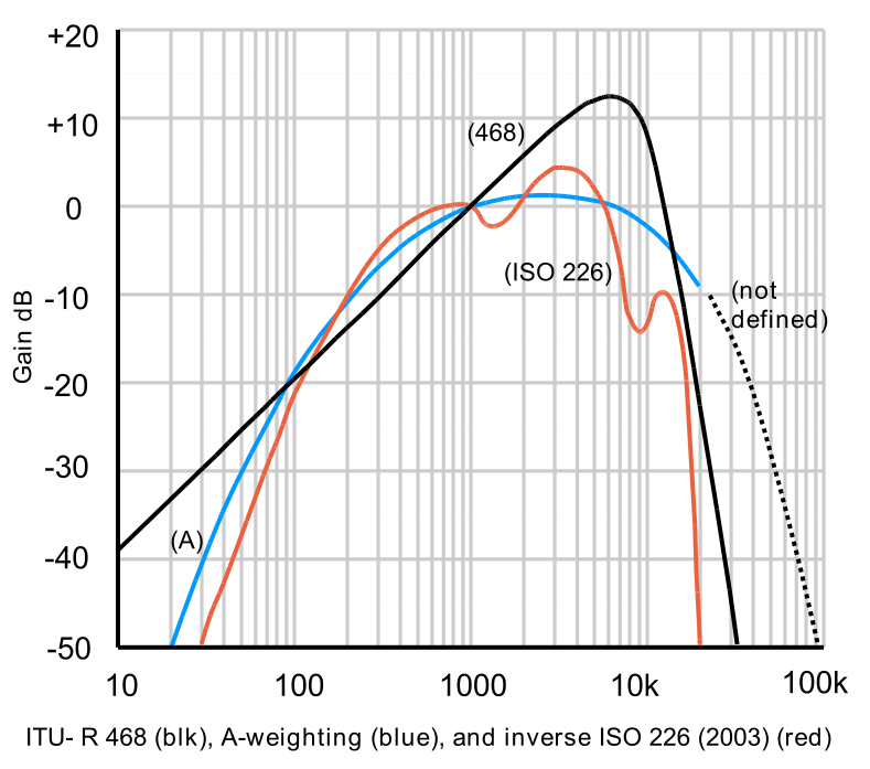

A-weighting might be order don't you think? Or an inverse of ISO 226:2003I don't think there is a range which is more susceptible to damage....
What for?A-weighting might be order don't you think? Or an inverse of ISO 226:2003

https://emedicine.medscape.com/article/857813-clinical#b1IN that video that guy claims that 20khz-to 5000hz is most susceptible to damage is this true? Anyone have any articles on the topic of ear damage vs frequency?
Power tools and firearms do a good job of causing loss at 3 to 6k.

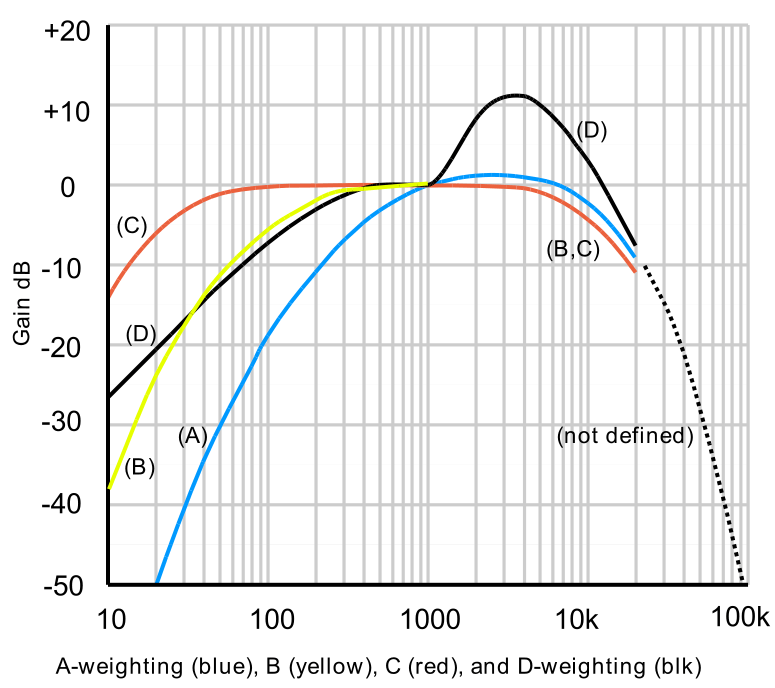

when judging safety levels for hearing safety, you should use A-weighting is what I am guessing... Our lack of sensitivity to bass provides some protection to bass....from what I'm reading, different weightings are used for different safety standards, non of which are Z, so it would seem practical to use A weighting for general spl analysis concerning human hearing.

Trying to measure SPL of bass with an A-weighting applied is daft, just look at the curve applied for the weighting to see why. It also isn’t as applicable at concert levels, because the curve is based on the lower phon equal-loudness contours.
You should really be a C-weighting (or the now-defunct B, but that’s another matter) to represent ‘loud’ listening with modern levels of sub-content or tilt. Unfortunately, that limits the use of phones as the mics distort very quickly at low frequencies.
The ELC often causes misunderstanding that exposure to bass is less dangerous, which is not true. The opposite is true, in fact. Those curves are for perceived loudness, not physical effects, and the strong vibrations at your ear and body’s bones and fluid created by loud subwoofer content provide a different, potentially much higher risk of damage. The problem moves out of hearing loss specifically and starts to become a whole-body vibration issue. WBV was extensively researched by the likes of NASA, and they found that long-term high exposure creates lasting cognitive impacts, among other things.

OK thank you for info. From wiki it says "G-weighting is used for measurements in the infrasound range from 8 Hz to about 40 Hz".....I spent time looking for G-weighting....After reading your post, I the Wiki page has a typo and the G is likely a CYou should really be a C-weighting (or the now-defunct B, but that’s another matter) to represent ‘loud’ listening with modern levels of sub-content or tilt. Unfortunately, that limits the use of phones as the mics distort very quickly at low frequencies.
"C-weighting is used for measurements in the infrasound range from 8 Hz to about 40 Hz".
Sounds like there is some truth to damage level, based off of transfer function vs using no weighting at all.
There are things that I don't understand about weighting and ELC. If the ELC represents our ears transfer function, generally......Then I should be able to place a filter of the inverse, like seen above in Red in left graph, on the microphone, and the resulting signal capture via 1 octave RTA results will, mean something relevant to my ears.
