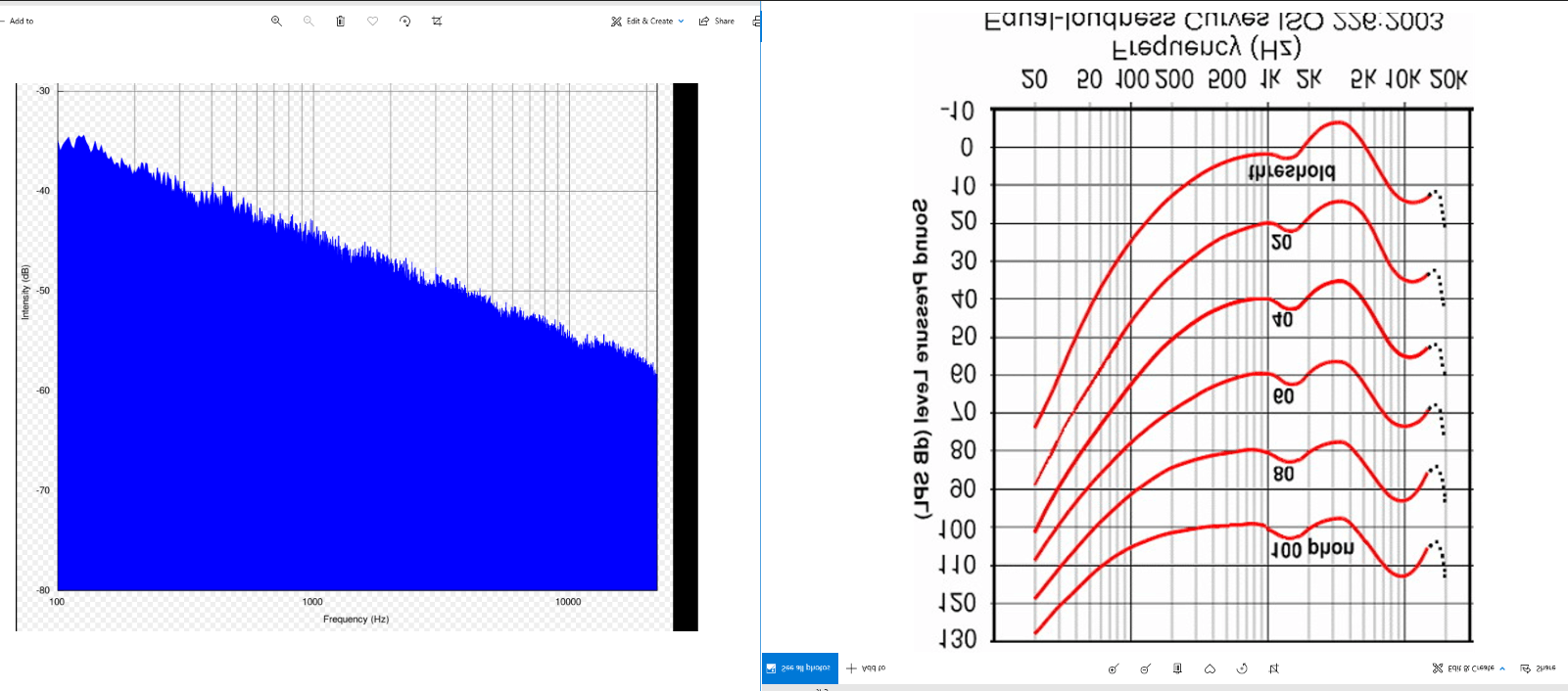

G weighting is specifically for infrasound, as it says. That’s more useful for characterising industrial nuisance noise, rather than audio. But as you can see, the A curve is -50 dB at 30 Hz. A system with subs can be running at 100 dBA, but be much more annoying to neighbours compared to a system without subs doing the same level. Hence the use of multiple readings at events and the like.
The B curve actually matches our 100 phon hearing better than the A curve, but you won’t find it used anywhere. C perhaps overestimates perception, but is a good approximation for ‘annoyance’ in practice.
You can easily make your own weighting curve, if that’s what you want. You can even trace the contour in VituixCAD and export it as a text file, then import it to whatever software you want.
The appropriate curve is the one for the phon level you’re going to be listening at, which is where the problems begin for this simple idea of ‘EQ to match the contour’.
The phon rating is the equivalent of a pure tone at 1 kHz, so for a 100 phon curve, you’d start with a pure tone at 100 dB(Z) SPL at the listening position. So far, so good. If you want to do this the easy way, just take the measured trace, and automagically fit it to your ‘ELC target’ curve with an FIR filter. Taps be damned for now, have a go at it and tell us what you think.
Perhaps there’s a reason this isn’t often done. For a start we don’t listen to pure tones; music is far more dynamic than that. So is pink noise, for this same reason. M-Noise is even closer to real music, and goes from 12 dB crest factor at the low notes to almost 20 dB CF at the highest.
Perhaps this is becoming clear - if you tune a loudspeaker to have the same magnitude response as the 100 phon ELC, it’ll be wrong for peaks which either go to 120 dB, or wrong when you reduce the system level for 80 dB RMS, 100 dB peak.
It’s also telling to look at the response curve for the highest rated speakers on a site like AudioScienceReview. Many of them can be downloaded and opened in REW. Check the on-axis and listening window responses, as well as the predicted in-room responses. You can compare them to the ELC traces for the 1 kHz SPL level shown on the plot.
This is all for listening purposes too. Don’t you want a flat two-channel transfer function when you’re producing? I’m sure you said this currently theoretical box is aimed as studio monitoring, in the near field no less. So what goes in should come out, no boosts or dips, maximum ‘revealing’ mix, or have I got that wrong? I don’t think even the popular SoundID thing from SonarWorks tries to match an ELC, and aims for flat response with linear phase.

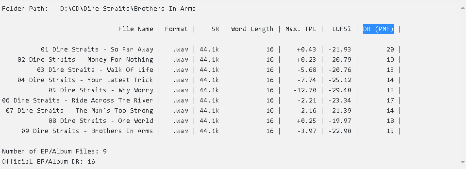

This was an album I remembered having a DR of 20. There are plenty of others. I saw one song having a DR of 34 on the DR database site. But as I wasn't familiar with it and it was listed as an mp3 I didn't link it. But there are more that go past 20.

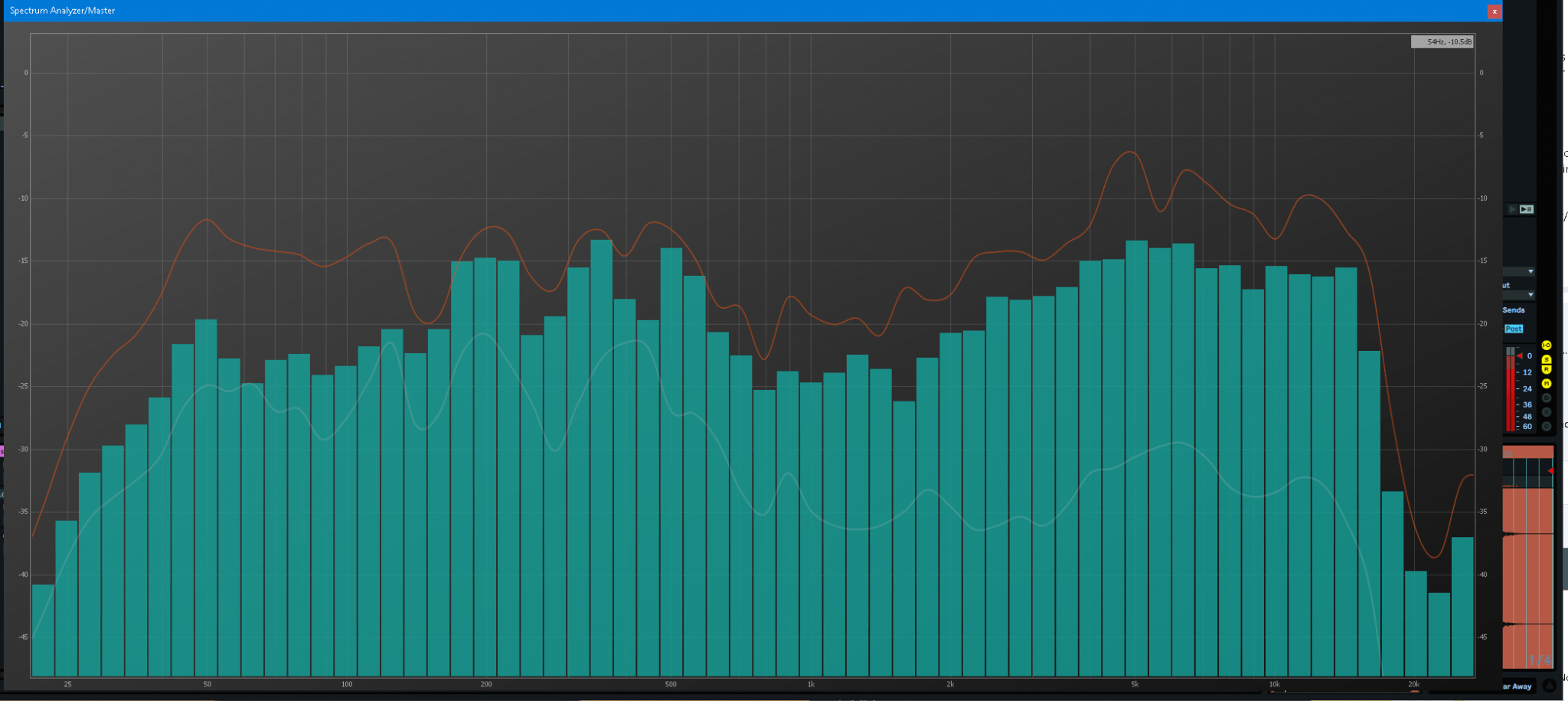

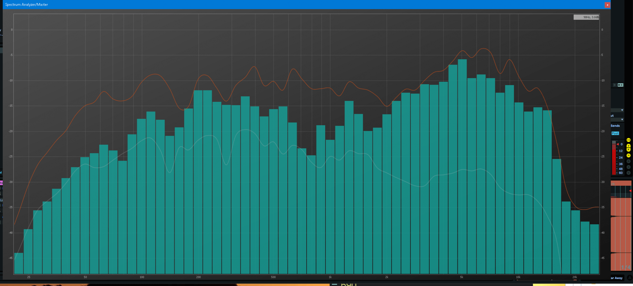

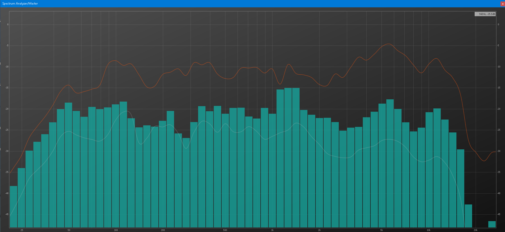

This meter is in 1/3 octave...Not sure what the units are, it says db, but who knows what that means...standard metering though.....I put it on the master channel...this is signal not audio from loudspeaker.
I hope this isn't an example of good sound engineering by the way...I can here the squeeze the snare is causing via a triggered compressor somewhere on the mix.....
Without getting into the settings of the RTA of above, I can see the headroom we are talking about over RMS.
The 1/3octave RTA suggest that 20-30db can be used against, a Pink Noise like slope, transfer function.....

Camplo does the RTA have an instant integration time?
No so i doubt you could ever have any usefull information about signal dynamic using a frequency analysis tool... ( remember that the way you look at signal influence what you can see...)
