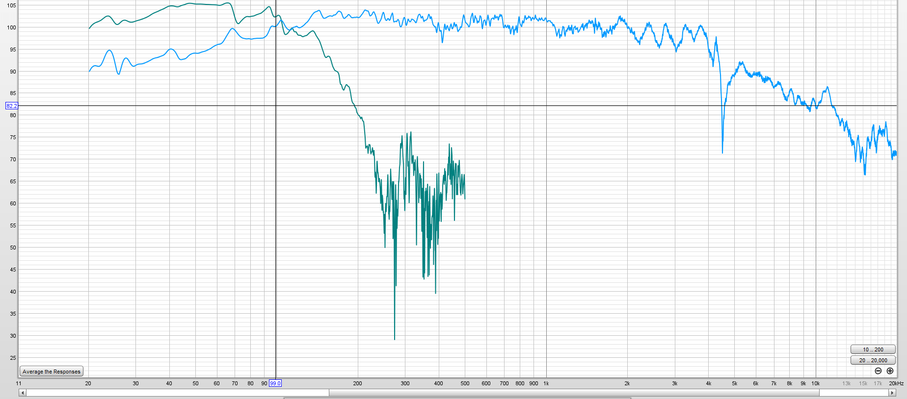

These were taken in a very crude way but very close to the driver....with the 128k length setting for the sine sweep...Looking at 65hz and up...to see if this thing is worthy of crossing above 400hz...looks good to me??? I'm sure some room is still in the Burst decay but......
Which components are used for this sweep?View attachment 1025601

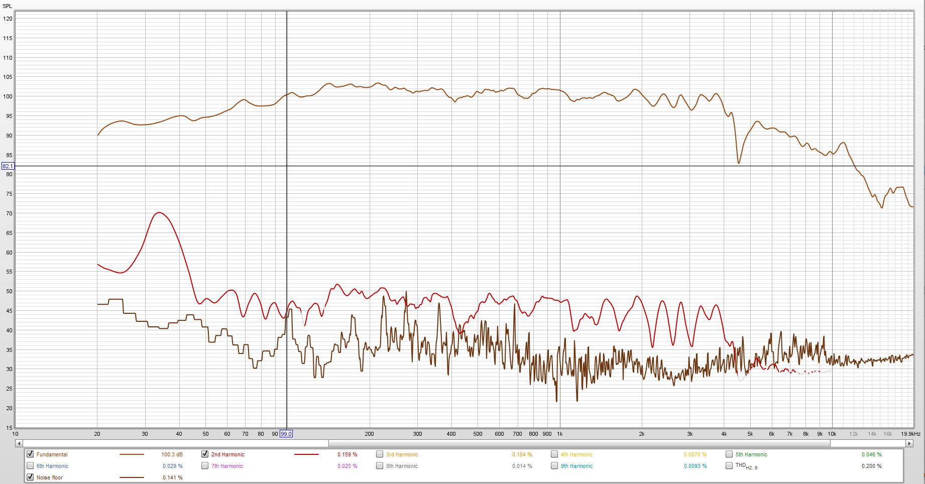

The UM8-22's look exactly like the description: "Dayton Audios Ultimax Series DVC subwoofers are purpose-built to move air and create clean, articulate, fast bass. Optimized for small enclosures".
Air pumps so to speak. They'll probably perform as advertised, but need humongous amounts of power when high levels are required.
I seriously doubt they'll integrate well with a highly efficient 2 way system.
It appears the UM8-22 isn't capable of / designed for high output levels:
"Now, it didn't play very loud, and even after I dialed it back to keep the cone from bottoming out and flapping from the test sweep, the distortion at lower frequencies was significant.
When it bottomed out, the distortion products were more than the fundamental. Dialed back down to avoid obvious bottoming out sweep results...
10 Hz Fundamental @ 72.7 dB,THD 34%
14 Hz Fundamental@ 81.1 dB, THD 56.5% (maximum%)
15 Hz Fundamental@ 82.5 dB, THD 53.9% (maximum Distortion Amplitude)
But from that as frequency rose, distortion dropped...
20 Hz Fundamental@ 86.9 dB, THD 23.1% (less than half than 15 Hz...
25Hz Fundamental@89.7 dB, THD 10.5%
30 Hz Fundamental @ 90.8 dB, THD 7.21%
40 Hz Fundamental @ 92.6 dB, THD 3.9%
60 Hz Fundamental @ 93.6 dB, THD 1.83%
80 Hz Fundamental @ 91.7 dB, THD 1.47%
120 Hz Fundamental @ 91.0 dB, THD 0.732%
133 Hz Fundamental @ 92.0 dB, THD 1.6%
From 140 to 200 Hz (at the crossover implemented) output stayed from 92-95 dB (at the particular sweep level) and distortion stayed under 1%, sometimes dropping near 0.5%."

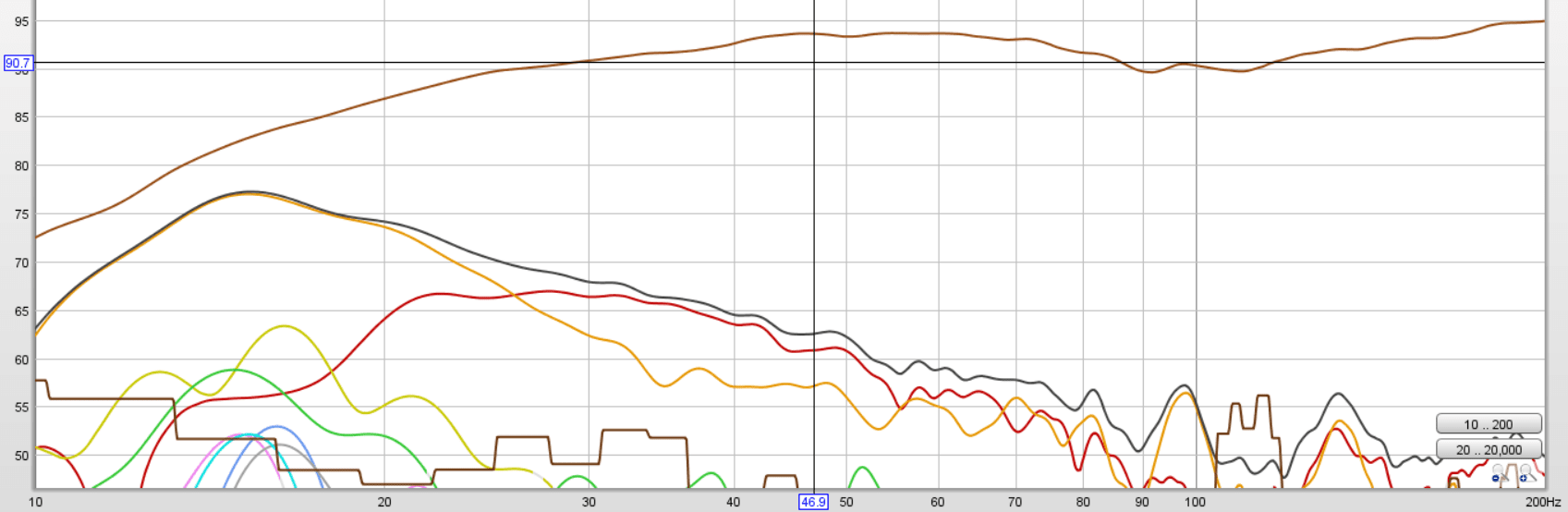

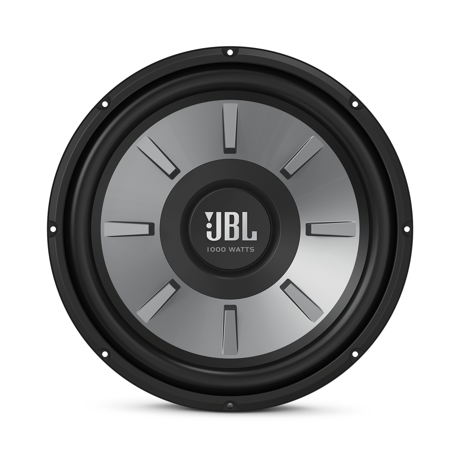

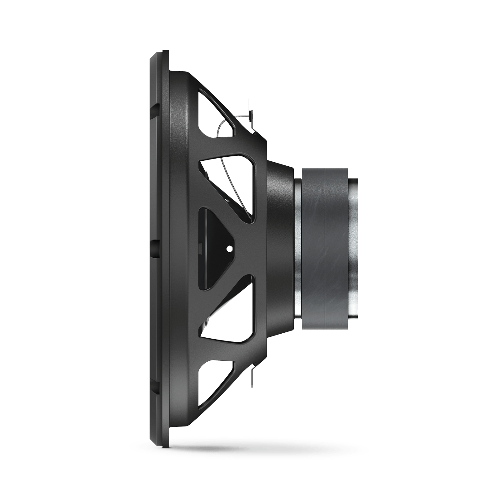

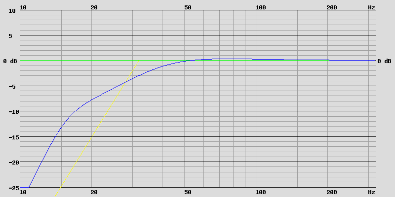

Cheapo JBL Car Subwoofer in 100L BR tuned at 20Hz.
Diaphragm displacement at 92 dB: ±0.55 mm out of 5.4 mm.
