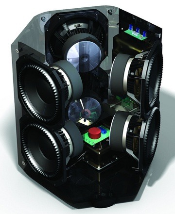

Paradigm gets close with three sides.Why Don't people build subs with drivers on every Baffle? You guys seem to think you can just put bass drivers anywhere and its all good lol....why not do that ......

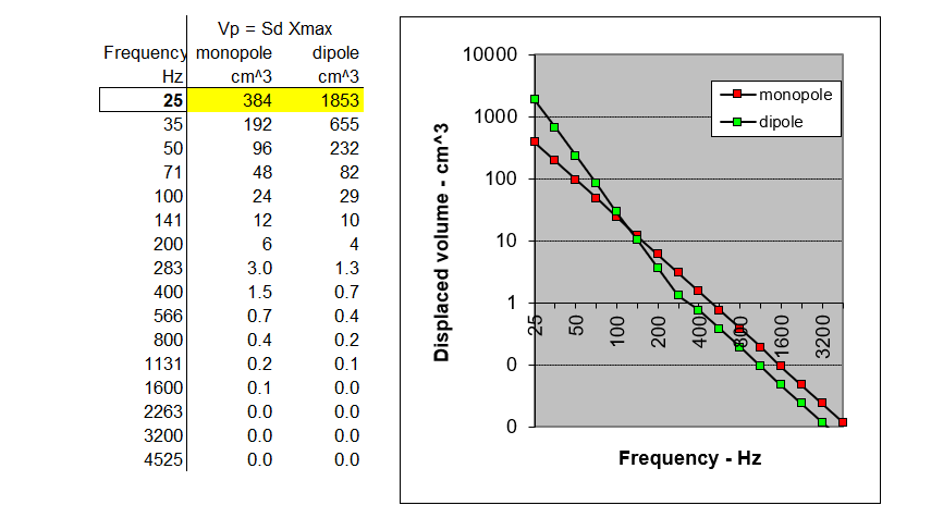

The Sd requirements to compare a monopole to a dipole at different frequencies can be done with SL's SPL Max spreadsheet.Do you feel/think 16x 21" is enough (for open baffle)?
At 25 Hz the dipole needs about 4.8 times the Sd to produce a comparable SPL.

There are implementation difficulties with the lack of volume and how the drivers need to wired. If you are a manufacturer of the drive units like Paradigm you can spec them to work.Any sonic set backs from this approach outside of having to keep the XO low?
Single monster subs can work if placed in a corner and there is only one spot for the response to be equalized at.

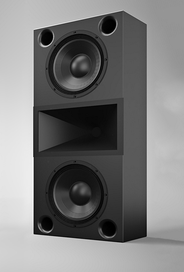

For the price of a single Paradigm Persona sub (US$6,999.99), you could easily build a high-end 2-way system, including 4 separate subs, and have money to spare for electronics.
The 2-way could be a 2x12+1 MTM, similar to this:

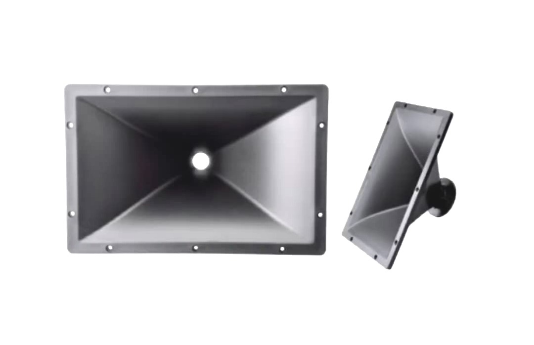

I'd use the 1" clone of the JBL SRX horn (70x50°).

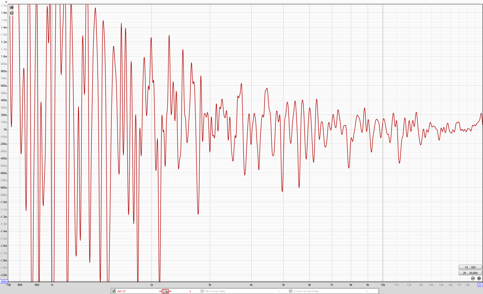

If you draw a straight line from one side of the graph to the other....Each intersection with a group delay line, represents its own FR for that period and time...and levels are not what they should be.....at the same time....ever.....unless group delay is much tighter than seen here in this graph.....I am theorizing but have no metric to say the level or perception, just an idea that our perception of loudness could be effected by these minute changes. A more static reception of signal involved may cause a better relationship of volume contrast vs the other parts of teh spectrum....but if everyone isn't showing up to the party at the same time....compare and contrast....will be less effective, theoretically....comments?
How should one weigh this out.... How much increase of loudness perception should we expect with how much increase of decay..... 1ms = 0.25 additional units of loudness?For example, there is a perceptual link between time and perceived loudness. A longer signal will be perceived as louder for a fixed amplitude. This is significant at LFs
Without scale the information is somewhat useless. Most of the conversation I remember having stemmed around the ideas that the speaker is swamped by all but the most quietest room?
