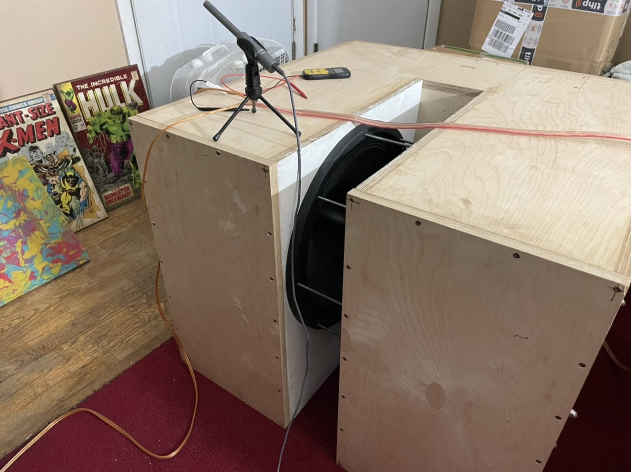

I had to take one sub apart and re insert the threaded rod....only took 8 hours....
