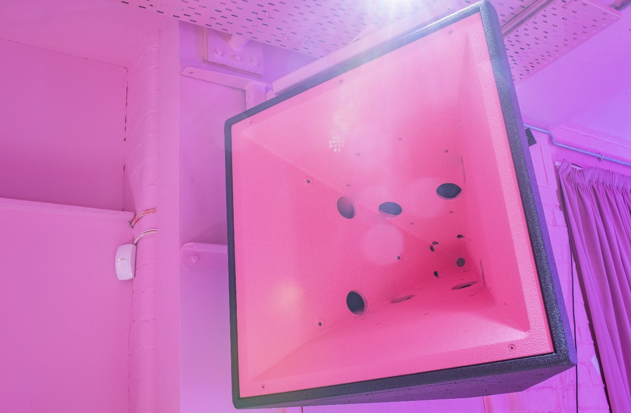

I own a pair, and have installed several more of those and plenty of other Danley products. The acoustic origin and acoustic centre are both at the apex of the horn, but the transition to far-field radiation condition occurs farther out than that. This is relatively easily seen with a measurement taken on-axis, anechoically, moving the mic outward.sorry my fault i was calling Kyleneuron on his claim that they don't sum until a distance out...
The trick is that you can’t hear the sound coming from the individual drivers’ openings, but that doesn’t mean you’re in the acoustic far field.
Don’t get me wrong, they are much better for source coherency in the near-field than other speaker types of the same size, and the transition occurs closer to the cabinet grille than you’d expect (and much closer to the grille than a direct radiating device), but there are some laws of physics that even Tom can’t break completely.

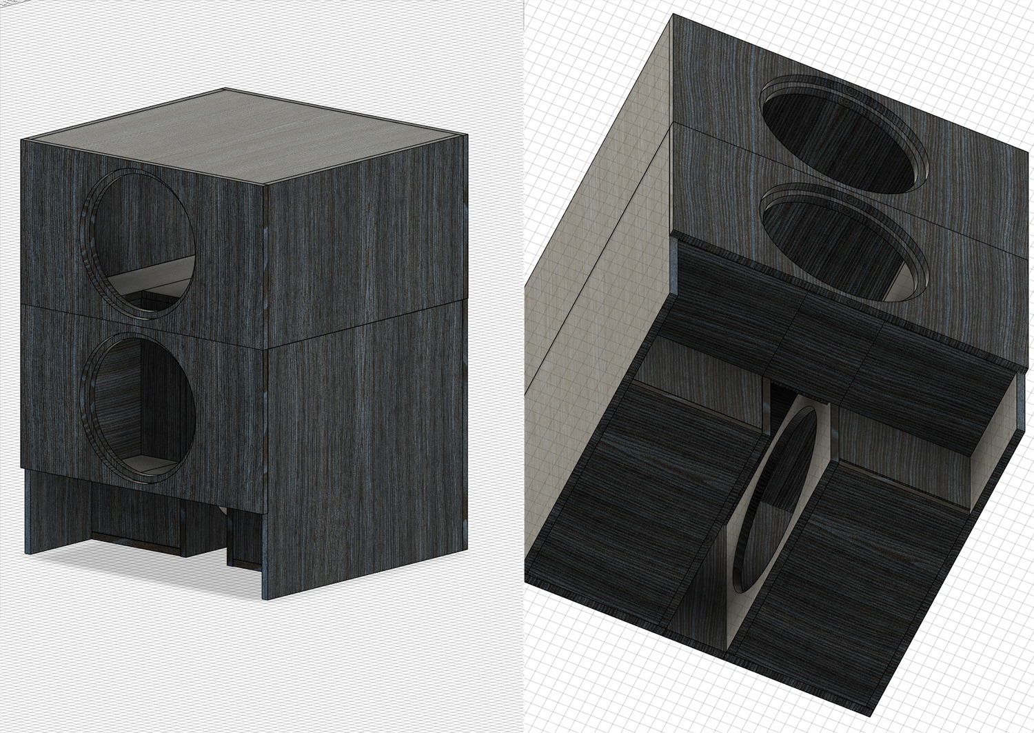

I am trying to model side firing woofers in VituixCad, when I enter -90 or 90 into "R" the polar disappears for the horizontal.
Has anyone modelled side by side woofers before? Can you give me an idea of what to expect as far as how it effects FR and maybe phase.

I don’t believe VituixCAD is capable of this type of simulation. From what I can tell, the plots are generated by purely analytical methods. The effect of source location on the baffle is likely done in a similar way to the equivalent tool in Tolvan’s Basta! and Edge software, which uses a cluster of theoretical point sources arrayed across the defined (flat) surface area.I am trying to model side firing woofers in VituixCad, when I enter -90 or 90 into "R" the polar disappears for the horizontal.

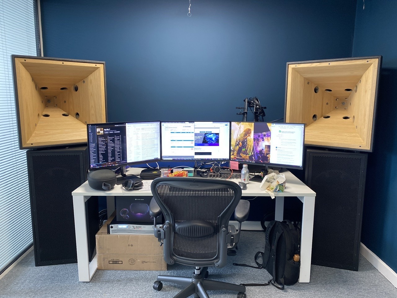

This was my desk for a good while before shows started again. We did the oak veneer ourselves, on horns that were specially finished in invisible bondo and staples. The Apex Intelli-Power amp was on demo, nice match for them though.

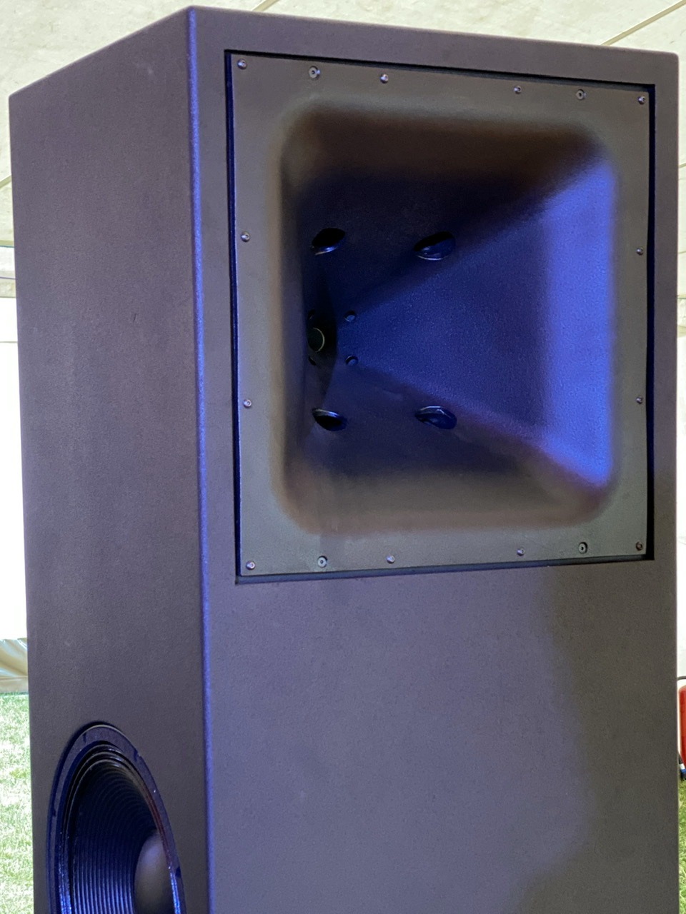

May i ask your take on the "sound of your head in the SH-50 horn"?
I've DIYed a number of similar size MEHs, and have never had all that strong of a 'the speaker disappears with my head in it feeling'.
I always mainly get the impression all the sound comes from the CD's exit, without being able to hear/identify sound from the other drivers.
So i'm always curious what folks say here.
Maybe the closest to not localizing at the CD has been with a 60x60, which is the narrowest pattern I've trier. I have the impression that greater horn depth may strengthen the phenomenon.

Vituix can do rotation and tilting of drivers.I don’t believe VituixCAD is capable of this type of simulation.
"Horizontal rotation R [deg] and vertical inclination T [deg] of drivers are also supported. Rotation R [deg] is positive to counter-clockwise from top view, and inclination T [deg] is positive to up".
For turning the drivers inwards with an air mass in between Vituix isn't going to give the whole answer, and Akabak would be better.
camplo my guess would be that if the response disappears from rotation that you have set it up in such a way that one driver is totally cancelling the other. Did you add some positive and negative X to reflect the position of the drivers when rotated?

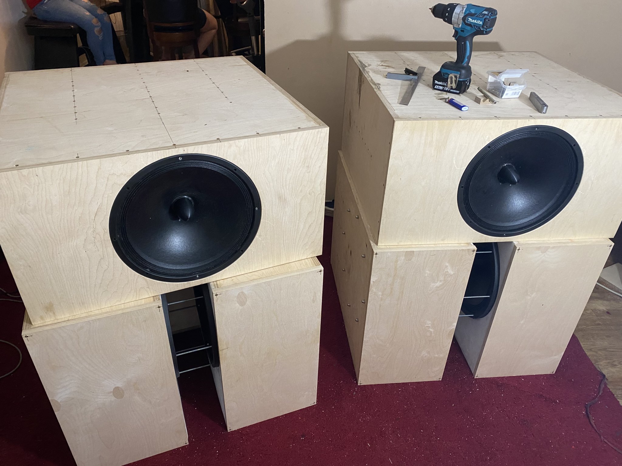

Criticism please...it makes sense to compare this to side firing woofers, regarding the 18"s....1/4wl at the baffle width is ~100hz so an XO around there would be good I guess... View attachment 1013216
Hello Camplo
Can't you set them up with the 18" slots facing the sides so they are not as obstructed. Your crossover is 80 Hz shouldn't be a problem integration wise. I would more concerned about getting something like flow noise like from the much smaller "port" at high volumes. Concern could be completely unfounded, just a thought. Rotate the 18's 90 degrees in this picture you posted.

Yes sir, that did not help, I'm not sure why, The whole polar map disappeared not just for the side woofers.....I ended up Starting with the diffraction tool and taking the virtual response from 90 and-90 degrees....then when I placed the drivers I moved X.Vituix can do rotation and tilting of drivers.

I eventually came to conclusion that the direct energy aspect should be my concern if thats the idea that I am pushing....I speculated that having the output on the front baffle is likely the best option for that goal though I cannot accurately speculate what happens as far as direct energy is concerned with side by side crossed low.
I checked the Velocities in HornResp, at max volume the peak throat particle velocity is 4.5m/s....15-17ms equates to port noise if I remember correctly.Hello Camplo
