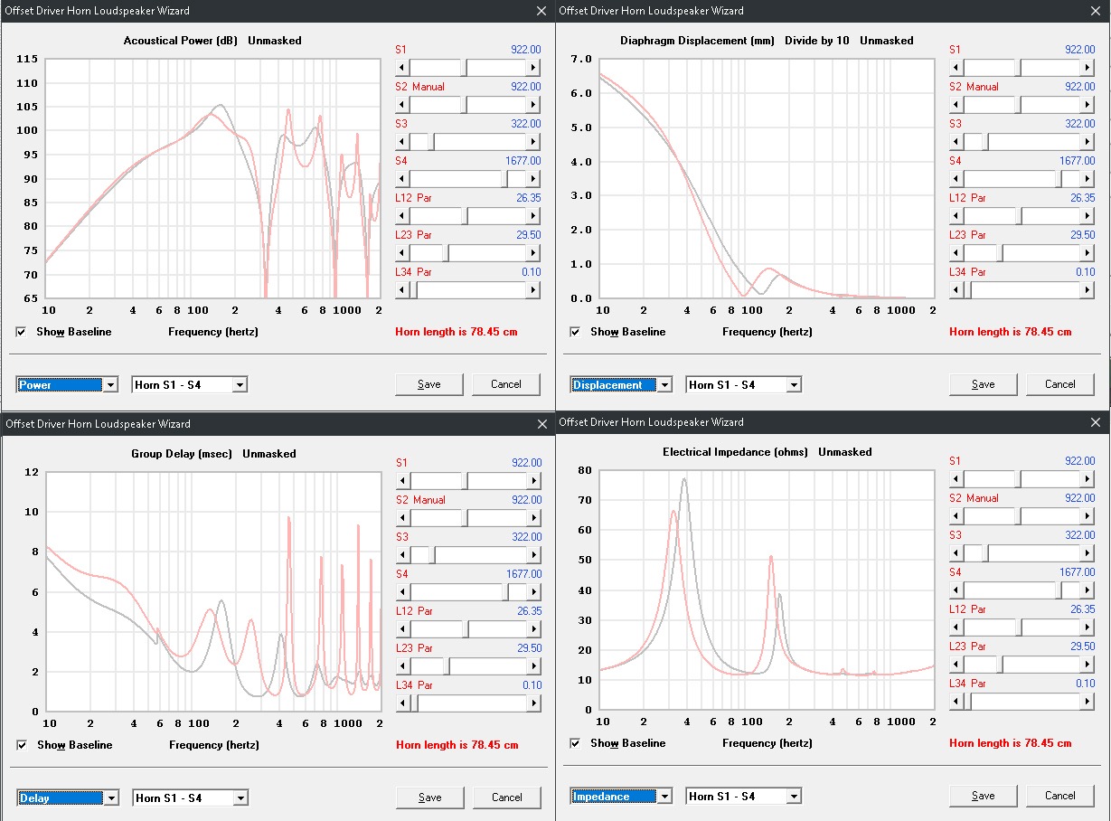

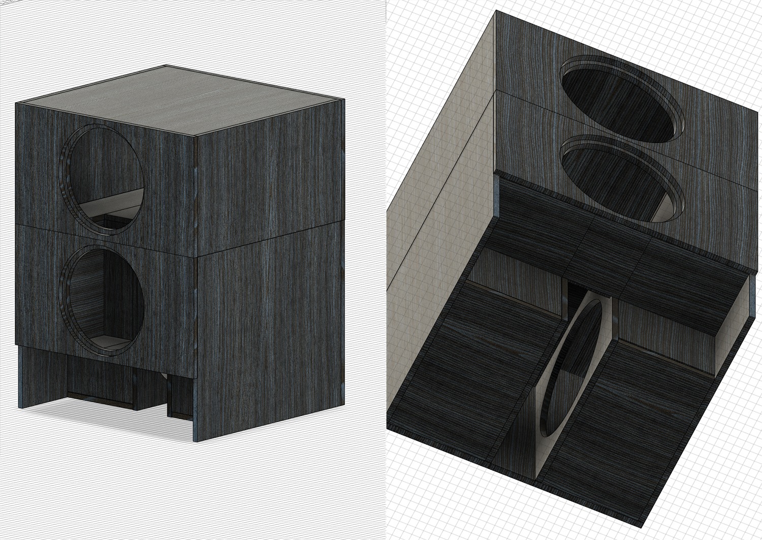

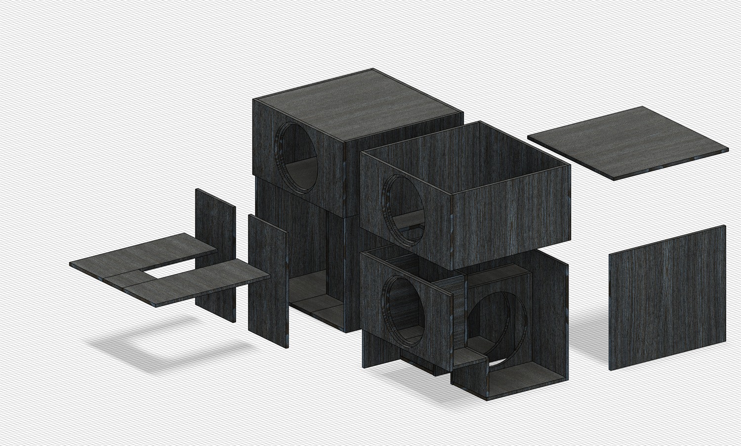

I'm working on a 3d model for you guys to see my idea of how to get dual 15s on the baffle face while keeping the PP 18"s and the 43inch height.
Pretty much have all the wood needed sitting in the boxes as is, maybe a few pieces from the scrap I have left....Up front, I created a chamber on the front baffle to house the second woofer...The opposing 18s on the bottom tucked behind the front baffle chamber...a 322sqcm csa squeeze leading to a 1677sqcm area....
The ballpark specs do not seem to yield a large difference in performance...Looking at the HR exported IR's in Rew, it things even more similar in some respects.....in either case the resonate area of the slot is above the desired high pass filter...and with 2 15"s to help instead of one, rather the 15"s are redundant or 2.5way like....not to shabby???
on on the left is a sort of early look at how the original boxes, can transition into the idea on the right...
