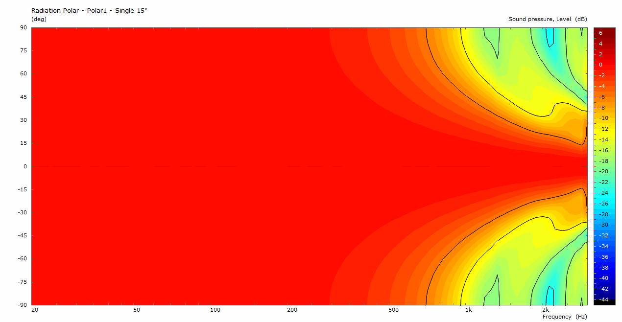

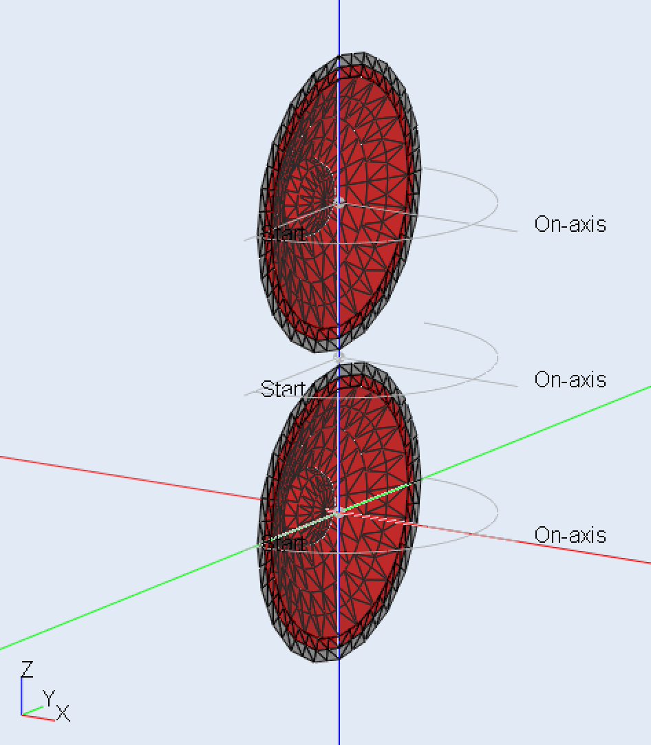

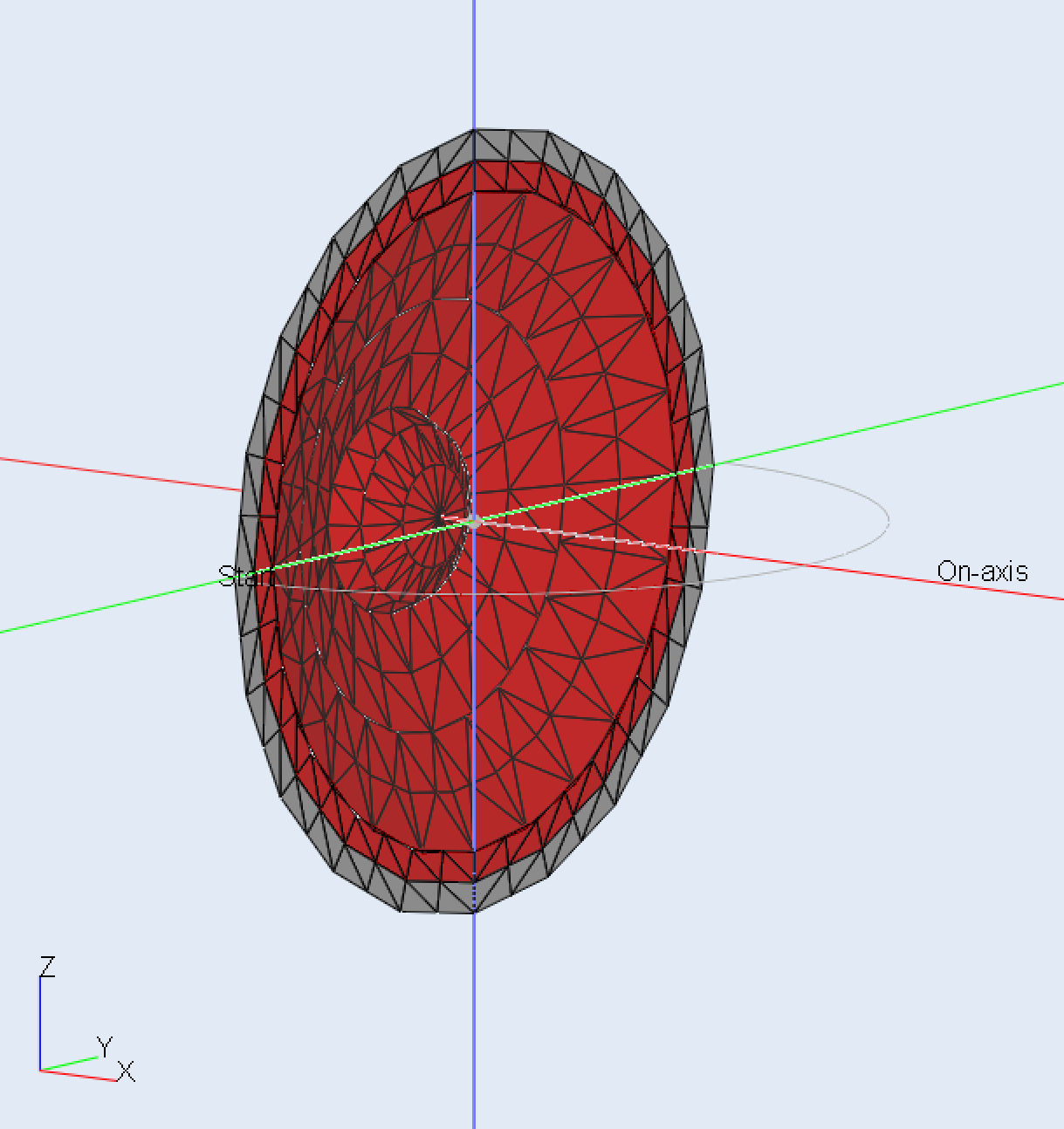

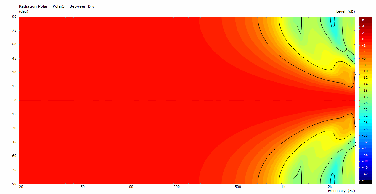

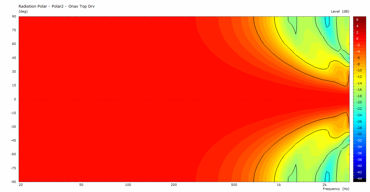

I think you might need to review your choice of sources if that's the case. Just for the sake of avoiding a spiral of 'discussion' on a basic acoustic concept, here are the normalised horizontal polars from BEM simulations of a single 15" driver and a pair of 15" drivers, mounted in an infinite baffle:
And now for the pair:
The questionable polar is my horizontal....apparently something is wrong, but I have modelled stacked woofers two different ways in Virtuix and got the same result....In the above polar sim the horizontal polar is identical very or two woofers, thats impossible.

The horizontal polar pattern of multiple vertically stacked drivers should remain the same as a single, while the vertical pattern will vary dependent on whether summation is constructive or destructive at the angle of measurement.
This is what I was trying to illustrate in response to:
Vertical stacking does indeed affect the horizontal response....it makes it wider. I have not known differently from my studies and it is what VituixCad predicts so....???
The plots are normalised to the zero degree aka axial response. Before you call something impossible, perhaps look at how it could be possible?

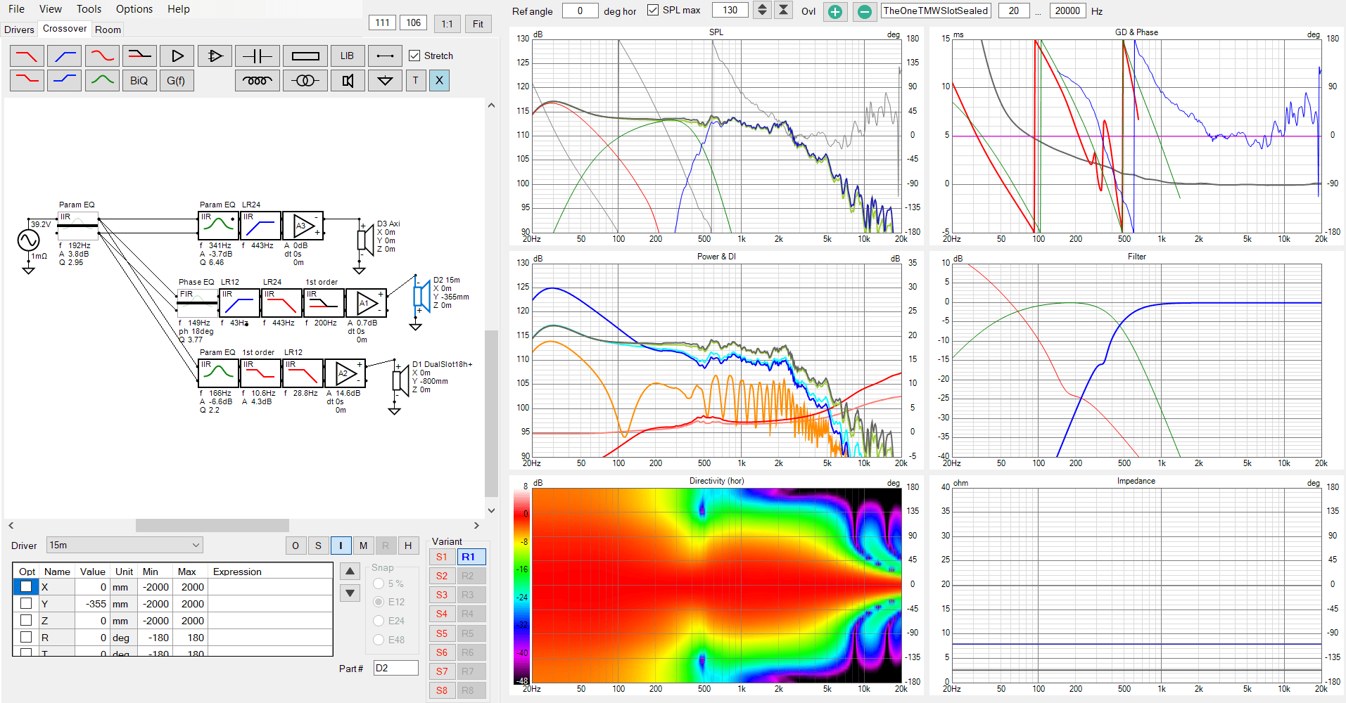

Hmm, as you say, no need to go too deep into this....I believe you guys, first of all. I read some stuff about polar vs line array some time ago...I don't recall it saying that the horizontal polar remains unchanged. I think after so many drivers it does truly get wider. Never the less, I did reprogram the drivers produced by older versions of Hornresp and VituixCad and the TMW rooms response cleaned up. Being that the null is ceiling or possibly driver height related, it is now showing is a 4db dip instead of the dramatic null as before. Phase was a little different as well but its not like the hornresp/vituixcad created result is identical to what I have in real life. Maybe I can find a way to use the independant subs to help in this area.

If the drivers are spaced vertically in a line then the horizontal will remain unchanged, this is not something to debate. All reputable sources will tell you the same as they have here. All competently simulated responses will give the same answer.
I forgot that you said that I left out too many files... I think this is the files needed.
I have had a look. Nothing was grounded in your simulation so you were getting a DC offset, this is what was making the polar look weird.
You are simulating at 39V input but still with a 14.6dB boost on the woofer. You have set a very low 2nd order crossover which is why there is a loss that is being made up with boost. It doesn't really matter how you get the transfer function in the end but this is an odd way to do it.
I'm not sure how you created the drivers responses but they are quite unusual. There is no z offset which is not representative of reality and is one of the big limits with completely synthetic source inputs. As this is active it is not too bad as the actual offsets can be altered with delay anyway.
I would not put too much more time into this unless you can get some better data to be simulating with.
