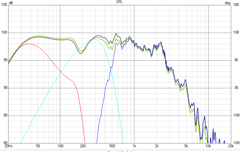

ok thanks for the reassurance. I know what Rohb is worried about. I am speaking of using the gain block to rebalance. My headroom is limited to power and excursion. Which I have too much of on purpose. Bending the lf roll off into shape using filters has always been the plan and is common for a sealed enclosure aiming for a lower F3 using a low Q driver. Getting the Hf roll off, out of the picture, as a result pushed the rest of the response so low I have to use unity gain to get it back into normal sensitivity range. Still there are limitations. I need 40db of gain to get to max spl goals. I've got 24db of unity gain at the eq and 20db at the input and 40db at the output. Seems that I should ok, as long as cut/boost in the right places to end up with cleanest signal in the end regarding noise floor.

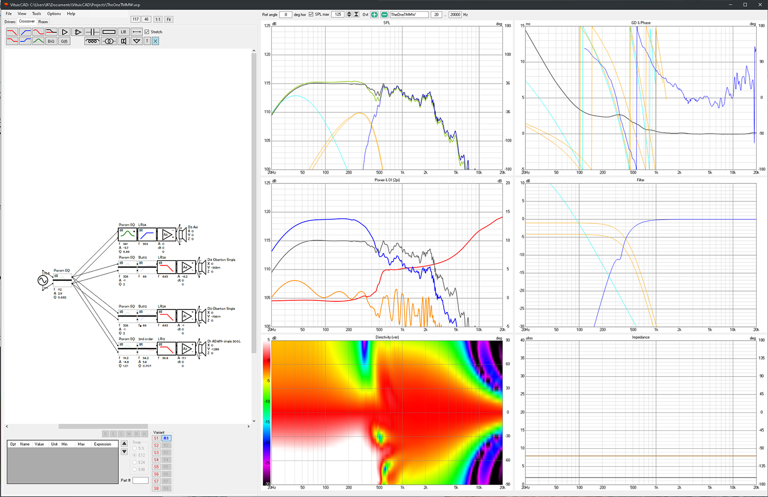

Heres my VituixCad *File*
I am flattered that you would take the time to help. I am not against reconfiguring the woofers but truth be told with this configuration pulled off excursion is very low on the middle woofer.

That is a lot of gain and I'm not sure why it would be needed. You need to zip up all the measurement files, just saving the vxp file doesn't add all the measurements in.I need 40db of gain to get to max spl goals. I've got 24db of unity gain at the eq and 20db at the input and 40db at the output. Seems that I should ok, as long as cut/boost in the right places to end up with cleanest signal in the end regarding noise floor.
Heres my VituixCad
Maybe it will make more sense when I can see what you did.

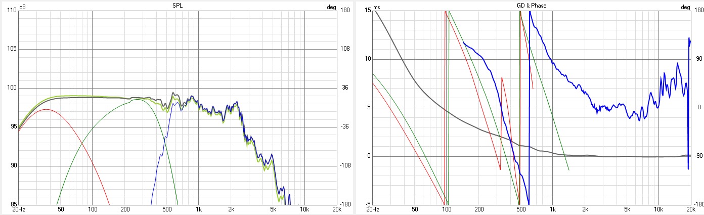

This is the best, simple, crossing, I did with the slot loaded woofers. That dip at 200hz....that even a big deal or no? I don't like how FR is a result of cancellations at that particular part of the spectrum but like I said, the slot it more trouble than a minimum phase, low order, xo would like to deal with....
Is it perceivable or something I should care about looking at it in the graph?
I can almost imagine what it sounds like...I'm looking for a reaction I guess...like "ooo thats good" or "I wouldn't accept that".....I guess if it was unacceptable someone would warn me right? That area where I actually lose sensitivity/efficiency at 200hz....maybe that was some kind of design red flag. Me not know.

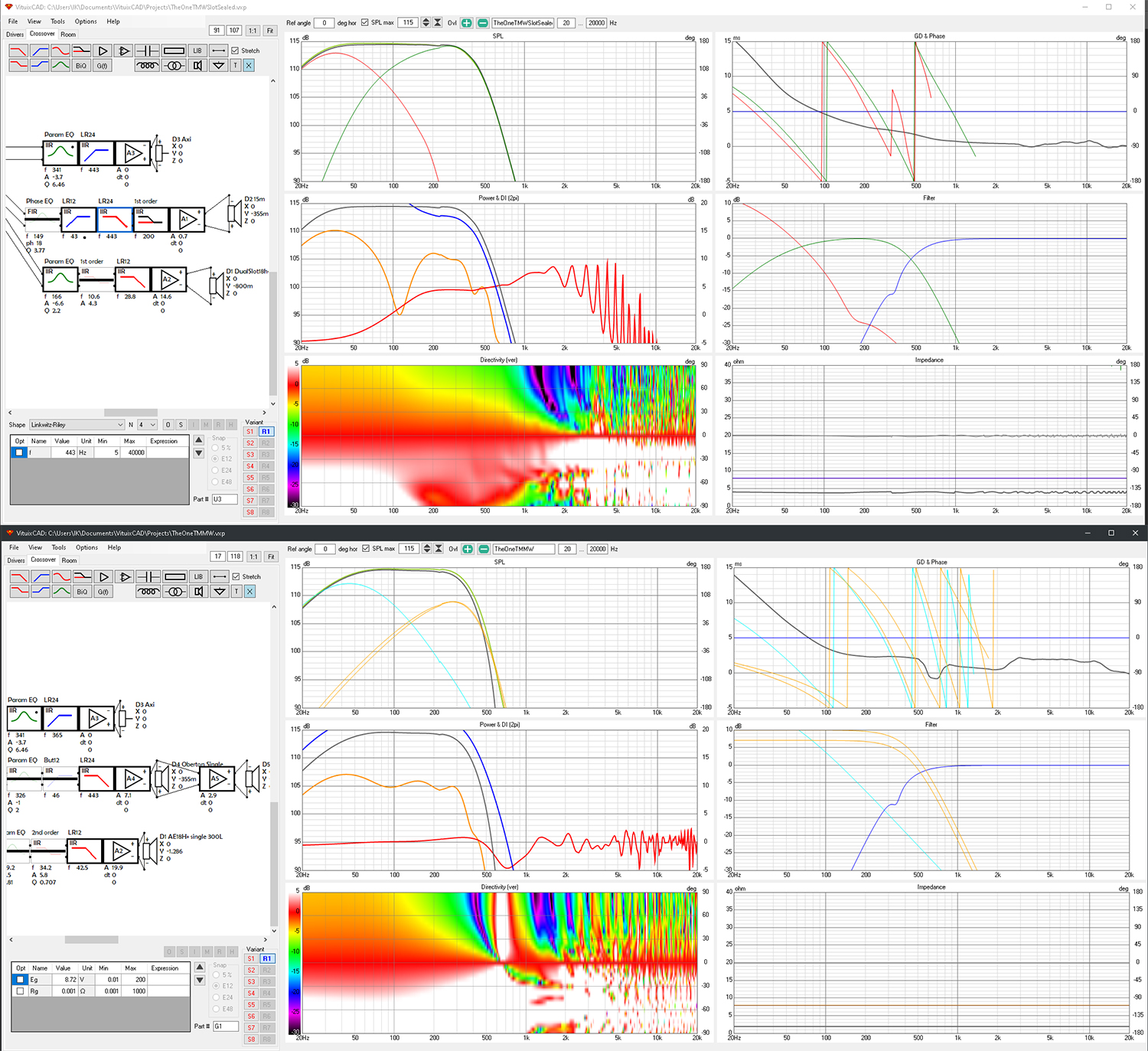

It's difficult to tell what is going on, half your directivity graph is missing the rest odd, which suggests the measurements or simulated data has some issues.
The top graph has good DI but the room positioning has a massive dip near 100Hz which is not good.
The bottom one avoids this but has 0 directivity which does not seem possible from such large drivers on that size baffle.
Dual 15's stacked vertically would have less directivity on the horizontal plane. That dip is related to short ceilings. The TMMW gives more redundant sources at various vertical positions...pretty much the multi-sub philosophy expressed vertically.
Not sure what you mean as vertical stacking won't affect the horizontal response.Dual 15's stacked vertically would have less directivity on the horizontal plane.
Considering the placement constraints and overall system response will get to a better result so your ceiling will be a big factor in what works best.That dip is related to short ceilings. The TMMW gives more redundant sources at various vertical positions...pretty much the multi-sub philosophy expressed vertically.
