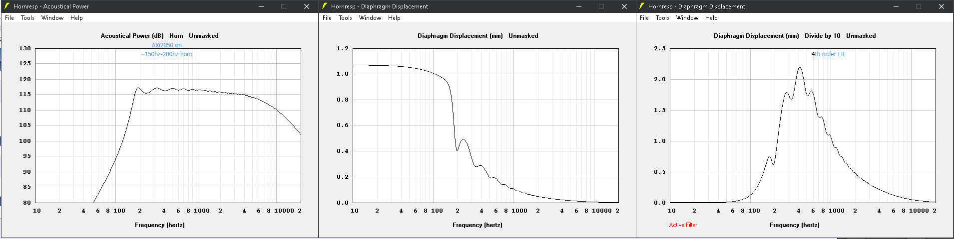

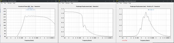

This is to show the headroom of the AXi+Horn, potentially. 300xo on the far right graph. More than enough. I think the Axi has 2mm peak to peak xmax??

No, the Axi2050 has about 0.8mm Xmax, 1.6mm peak to peak at the voice coil location near the center of the ring radiator. Since the outer perimeters of the annular ring diaphragm are fixed in place, the average is probably little more than a standard 4" diaphragm with 0.5 mm Xmax.This is to show the headroom of the AXi+Horn, potentially. 300xo on the far right graph. More than enough. I think the Axi has 2mm peak to peak xmax??
The Axi2050 used on a horn that loads well down to 300 Hz should be able to produce 115 dB at 1meter without the diaphragm hammering the phase plug, but a single 15 could easily have 10dB more headroom available at that frequency.

The Axi2050 Xmech, contact of the center of the diaphragm with the phase plug is 1mm. 0.8mm would leave a bit of headroom before the crash 😉So 0.8 mm is confirmed Vs this response's stated 0.5 mm?: New Celestion "AxiPeriodic Driver"
As Dr Jack Oclee-Brown mentioned at about 55:38 in the video describing the Axi2050:
PART 2: Wideband Compression Driver Design - Dr Jack Oclee-Brown - YouTube
“We’ve got a 1mm gap between the front of the diaphragm and the phase plug at it’s widest point which comes down to almost nothing where it’s clamped”.
He also mentions the displacement of the annular ring AXi2050 is about the equivalent to that of a 4” dome.
The AXi2050 has less low frequency (below 600 Hz) second harmonic distortion from mechanical limiting of the suspension the (presumably BMS) dual diaphragm driver he compared it to has.
As he also mentioned, “it’s not so good at high frequencies..”
The AXi2050 lack of mechanical limiting should also allow the diaphragm to hammer against the phase plug with less voltage applied, but also with less harmonic distortion before the mechanical limit is reached.

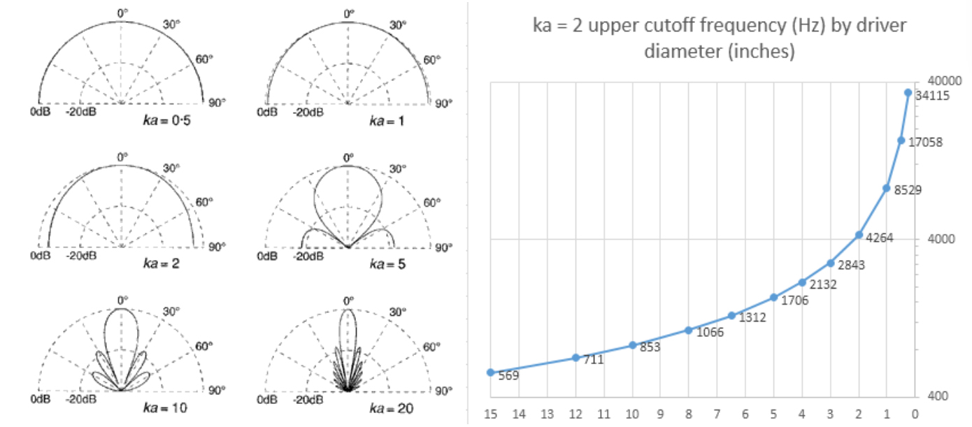

During this project I have made happy and sad mistakes. My latest happy mistake was thinking that a ka=2 had a more narrow beam width based off of the graph used in another study on directivity that used different scaling (ka=2 looks like about -4db at 90 degrees?). So the new revelation is just in time because I may have a sad mistake regarding how I can actually manipulate the signal via eq and gain vs what I thought I was about to do.

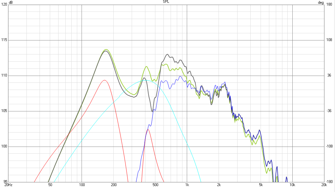

It appears the trouble area created by the slot isn't playing nicely. Its not so much my ability to create a flat response with filters....I've done so in several configurations, its just that in my ignorance I adjusted gain as if it was freely available, based on the ideas that the spl levels I aimed for were achieved pre filter. EQ filter gain is going to be limited to what, +12db? I'd probably want to leave unity gain alone here. The input or output gain might be enough but I have used numbers like 20 and higher for the +db of the amps in VituixCad. I'm pretty sure that 20 is probably getting towards the cap of gain I have safely available? If I focus on the slot loaded woofers, I have 625-2000 watts rms to use in 16ohms.
More so 625 since I rather be able to use stereo mode instead of bridged. So how much gain should I limit myself while trying to manipulate the low response into something that can useable.
In a minimum phase (MP) system that is correct. MP is generally the case, but some things, like diffraction, can be non-MP, in which case there can be GD without FR effects.
ok, when we look at using two drivers, we end up with a repaired FR yet GD is there. "If you "fixed the FR with filters," then you also fixed the GD." - In this situation have we not "fixed" FR? The way I read the above perspectives is that unless its something like diffraction, I can take a filter, bring FR to 0 transfer function and GD should be 0 to compliment. It appears that If I use two group delayed responses to accumulate to the proper FR (crossband) the area is still delayed. Which that makes sense.
"For discrete 3D modes we do generally need "more than EQ" to solve the problems - like multiple subs at LFs with EQ." - So room modes, or boundary related modes, which would include modes related to a vented enclosure and even the boundary related resonances of sealed enclosures. Eq is not going to simply fix GD from these 3d "mechanical" filters.
If the red line is an unprocessed measurement of your slot loaded sealed subwoofers, I’d argue that can’t be fixed with any reasonable amount of filtering and requires a redesign of the enclosure.
Why are you taking ka=2 as your upper cutoff? Do you want an omnidirectional response? If so, why the interest in a horn?
Also remember that a is the equivalent radius of a circular piston having the same surface area. You need to convert the area of the mouth or port from a rectangle if the drivers are not directly radiating.
The plots you’re comparing are likely different because they’re based on different analytical constructs - either a round, rigid piston in infinite baffle, duct (with or without flange and/or baffle), rectangular piston, etc.

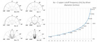

If you want to see what EQ can 'fix' just normalise your polar map prediction to the axial response.
