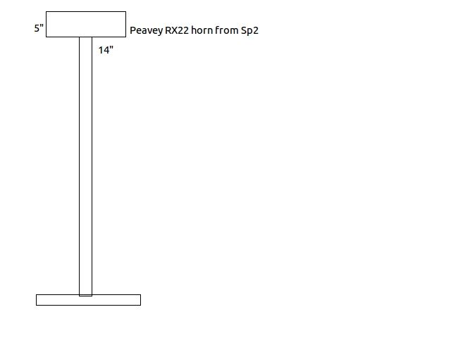

Here is a 2 way that is ugly, big and maybe will be ignored by thieves. Bass cabinet is a partical board cabinet I salvaged last week. Tweeter is a Peavey plastic horn on a 8' pole. I have 2 RX22 (1.4") Peavey tweeters with horns. Shelf in cabinet gets a hole sawed to make a 5' long path from 15" woofer, continued with a PVC pipe out the back 6' long to make a 11' long resonant chamber. 40 hz tuning, right?

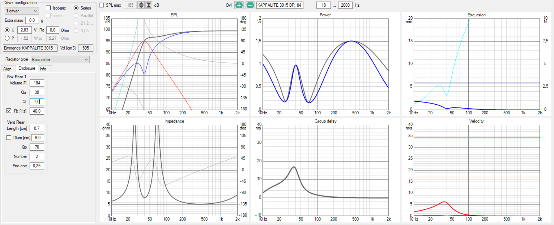

@indianajo, how did you arrive at that long (exhaust? :D) pipe for your 184L cab with Fb 40 Hz?
A quick and dirty sim yields either 2 x Ø 9.4 cm ports (at least 20 cm apart), or a single Ø 15.0 cm vent with a length of 6.7 cm.

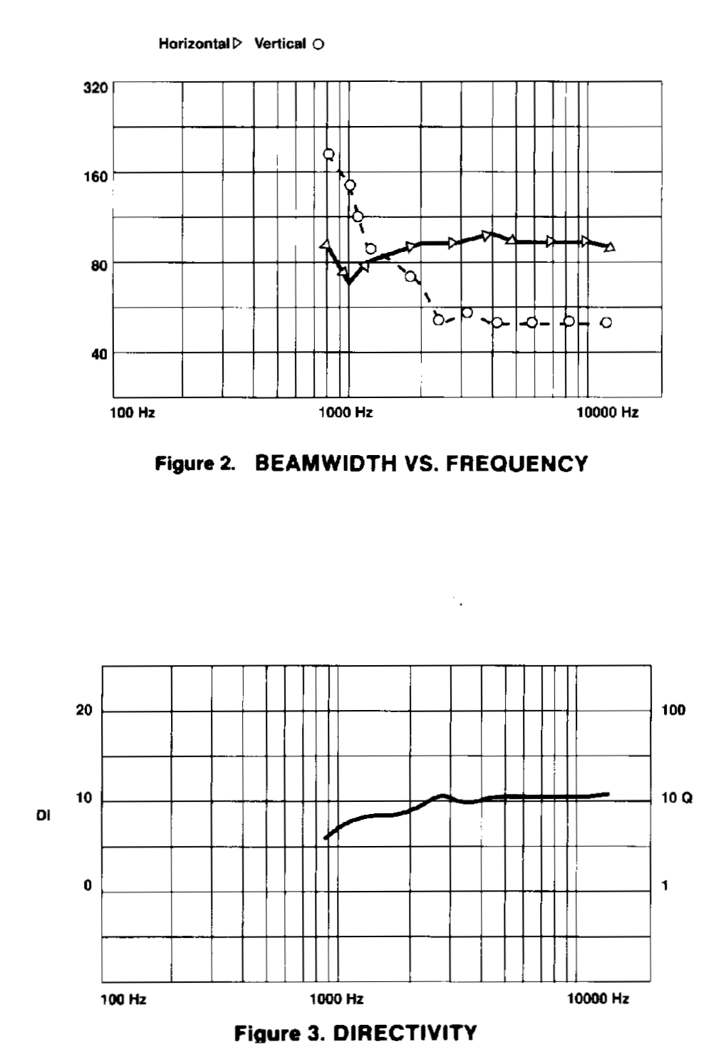

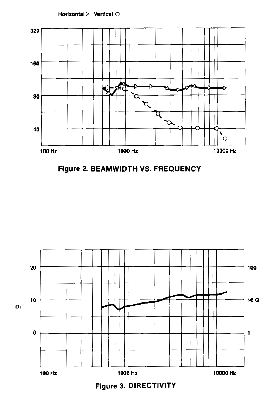

Do you intend to use either the A/A 9045-1, or A/A 9040-1 horn?
The latter lacks pattern flip in the passband.
Thanks for looking. Speed of sound is 880 ft/sec. Desired bass boost is 40-90hz. Vent has an open end & fixed end @ speaker so half wavelength of 40 hz is 11'. Will consider your vent dimensions, looks like a Peavey SP2-TTI front. Idea for long resonator came from Neil Blanchard "20 hz" reflex cabinet in a previous post with a long internal bulkhead that would weigh a lot.

I have Peavey 5"Tx14"Wx6"Dx1.4" horns from Ebay with vertical 1/2" apature salvaged from apparently a SP2-XT or close relative. No part #. Peavey SP2-XT spec plots horizontal dispersion of 1 khz & 2 khz down 2 db @ 22.5 deg horizontal & 8hz flat , which is fine for my music room. I loved my SP2-XT that were stolen.

Some explanation of the underlying math of vented reflex would be useful. Since the only eminence (Ky made) 15" driver that doesn't rise 5 db above 1000 hz is a vented kappalite 3015.
Eminence released a few cabinet designs for the Kappalite (attached).
In Vituixcad I got a similar results. The driver should work just fine in a 184 liter cab, as long as you don't tune the ports too low.
