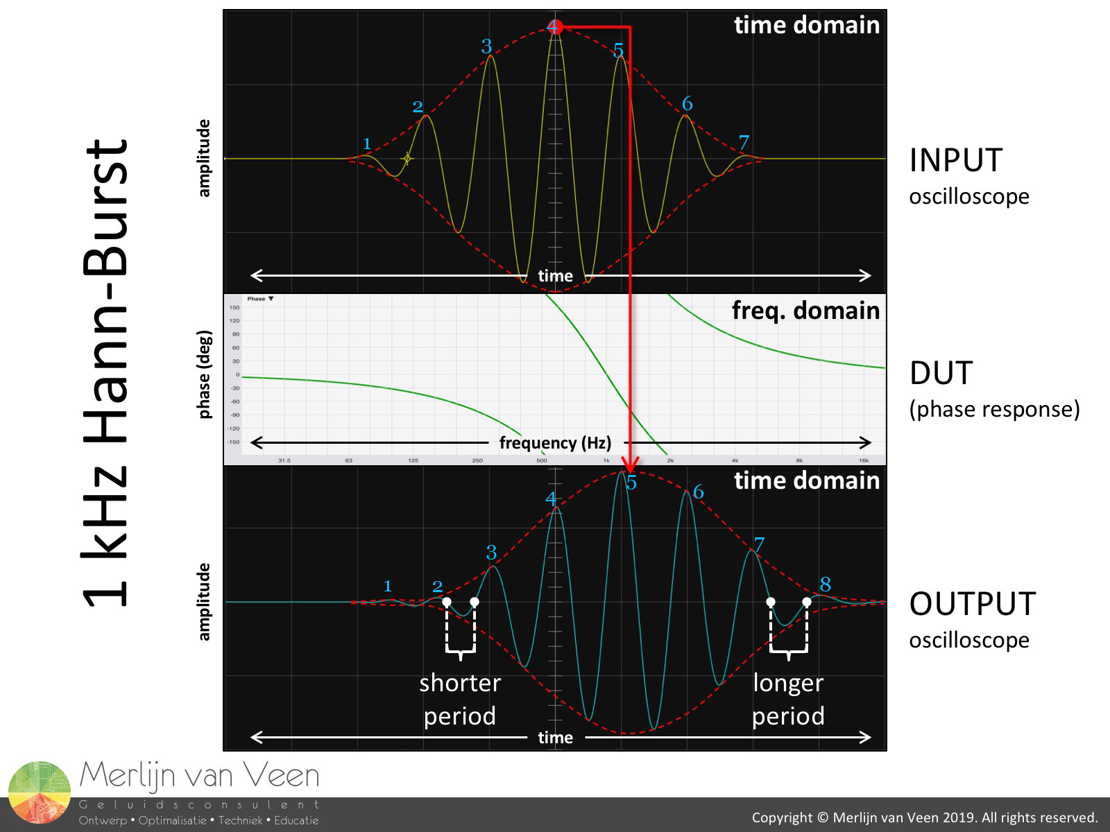

In all the examples I've seen....group delay is essentially the amplitude envelope in milliseconds....which is important to distinguish. Lets say an input signal at 0ms vs 40ms group delay in the output...the time to reach amplitude matching the input signal is delayed....hence the title "amplitude envelope". In the first article I cite, they refer to this as propagation which means to build up or increase...
Merlijn van Veen - Group Delay 101
Martin King
I know you have a very great mathematical understanding....according to your quote here "Group Delay is a very poor label, it does NOT indicate ANY kind of TIME delay."
The articles above are not agreeing....can you please explain where they messed up???....in the second article they actually play for us an exaggerated group delay example at 100hz. There are multiple articles on the internet discussing how much group delay is needed for the human ear to detect it at certain frequencies....If they are not hearing a time distortion what exactly are they hearing?
...unlike phase, group delay moves the point in time, of the output signal, where the first crest matches the amplitude of the original signal. This is what is shown in the examples in both articles. Amplitude Envelope.

From what I see there are the same number of "crests/troughs" in both signals.
To me group delay is imply the slope of the phase curve, that's its definition. Phase delay is the value of time delay at that frequency and the group delay is its slope. That does not seem to me to be very complex, but it's effects get all kinds of discussion. Many misleading and/or irrelevant.

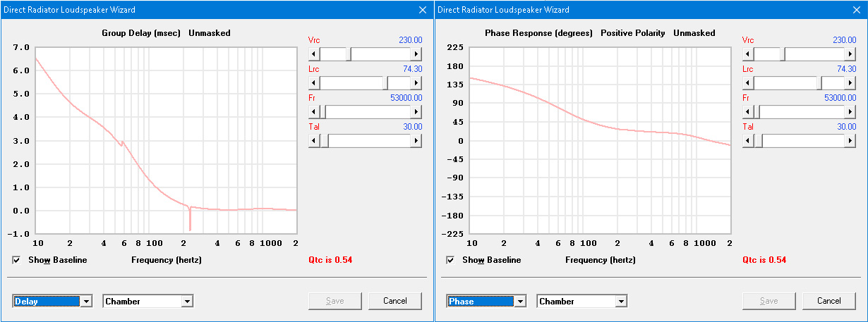

Well it depends on how sensitive you are to it....for me it apparently is a big deal...then again...as a drummer, with very good timing...I am sensitive to it....Now that I understand the lingo a little better....I can speak more confidently about it.

The higher the group delay figure the father out in time the "pressure front" sits...I have no idea how to relate that to this sentence

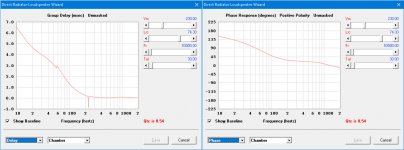

To be 100% transparent....this, for me, is an issue of vented designs where group delay has risen high due to a tuning note being placed in the passband...a vent that likely is understuffed...there are other configurations of vented enclosures as well (tapped horn) where the group delay figures are pushed way out there. Take into consideration that filters way be in play to exaggerate the group delay down low, and no less a culprit worth analyzing. As a general listener this may be ignorable for some...but as a critical listener responsible for designing signal, in particular in the bass region, this may make or break your ability to judge accurately, your decisions with compression and the attack envelope on electronic instruments. the easiest way to reference this in your system today is to listen to a song with an 808 in it, in headphones vs you're loudspeaker system....if the difference shows the bass being a little later to the party with the loudspeakers...you are hearing group delay...not everyone is as sensitive as others to this affect.

I think Gedlee is saying that the group delay curve shows phase delay? Please clarify?
No, the group delay at some frequency is the slope of the phase line at that frequency. Phase delay is the delay at that frequency corresponding to the phase value. One is the delay at a specific point - a specific frequency - and the other is the delay that a group of frequencies about that point will be delayed.
When talking phase defining zero is critical, as you imply, but group delay does not depend on this definition in any way.
That is wrong. You are reading the time delay of a signal through a system of a group of frequencies about that point, which is not necessarily the same as the phase delay of a pure tone at that frequency. Your ear cannot detect phase delay but it can detect group delay.
