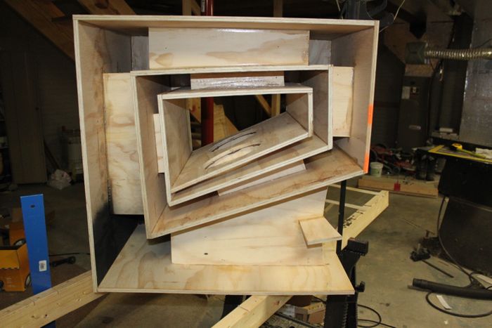

Flat to 30Hz comes with numerous limitations.
You either want to use a separate, preferably horn loaded, bass solution, or, in case of a 2 way, cross below 500 Hz.
Horn loading comes its own set of problems...I wonder why Bills horn designs do not have slot cancellation issues, now that I think about it...a flare does not fix that....I don't think...I modeled an extension of the ~930cm2 slot into a horn with no flare...it works...but phase pattern flip rendered it useless without using linear phase...i attributed that to the lack of a flare...
My thought was that the rear chamber should maintain the 0.5qts standard and the horn was tuned to 30hz... Bills design start with a very small csa...so I guess that gets rid of the slot cancellation....He claims that large woofer diaphragms are not rigid enough to withstand pressure at the start of his horns...how true that is, I don't know...the more I think about it, the less sense it makes....Csa can be increased but focusing on his builds with the tiny starting csa....a large woofer moves less...so I dunno....a PPSL is great way to start a bass horn...technically it is a 4th order bandpass with an extremely truncated horn
My thought was that the rear chamber should maintain the 0.5qts standard and the horn was tuned to 30hz... ....He claims that large woofer diaphragms are not rigid enough to withstand pressure at the start of his horns...
It's very true of all but the stiffest diaphragms and especially the suspension if the compression chamber doesn't null it out, IOW 'lock' it in place to perform as a solid piston in a bore, i.e. an electric solenoid, which is the analog of driver design, hence traditional compression horn design in general is an under-damped driver 'cycling' an over-damped bore with 0.5 sysQ the theoretical ideal goal.

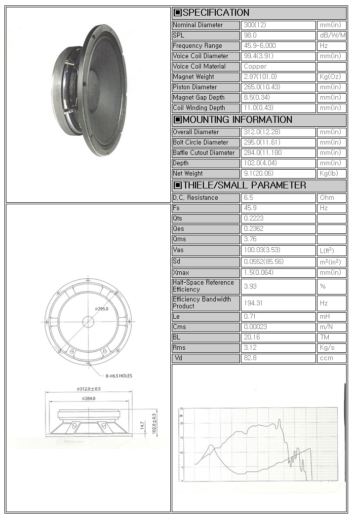

The horn shown in the previous post is Bill Fitzmaurice's Table Tuba for which the recommended T/S parameters are: Fs 28 to 40Hz, Qts .30 to .50, Vas 15 to 45L, Xmax 8mm or more.
Compare the parameters of the driver that Bjørn Kolbrek used for his first bass horn (attached).
Xmax is the antonym of η.

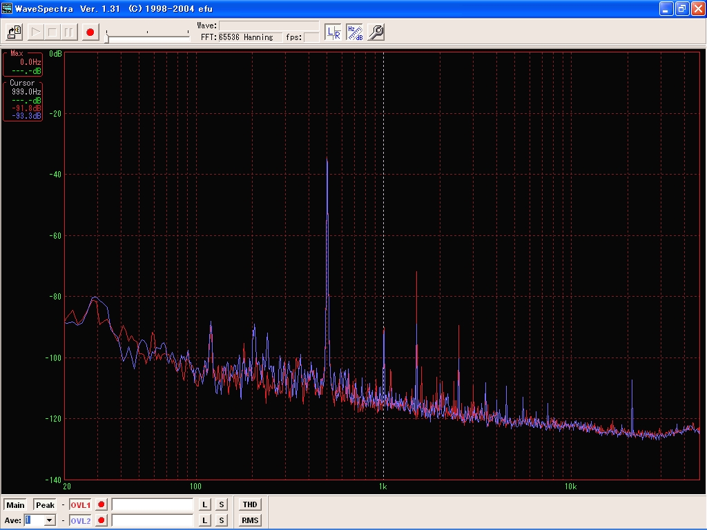

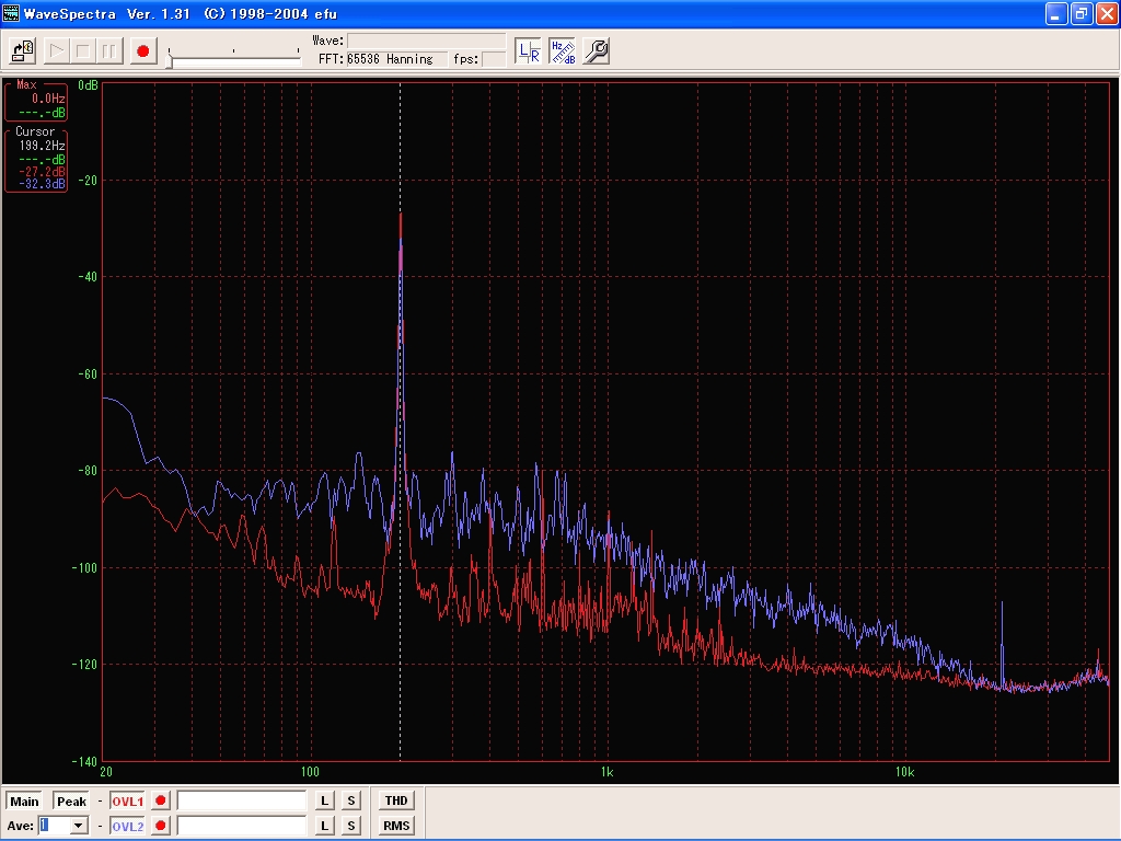

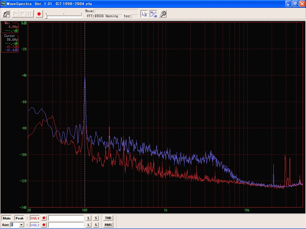

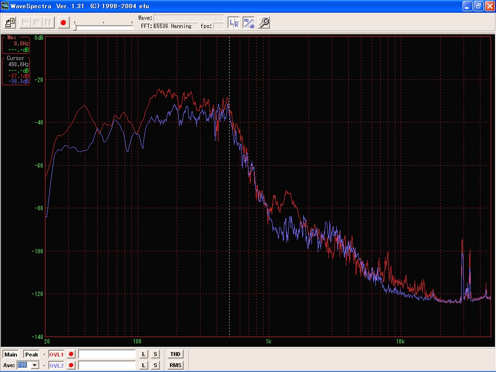

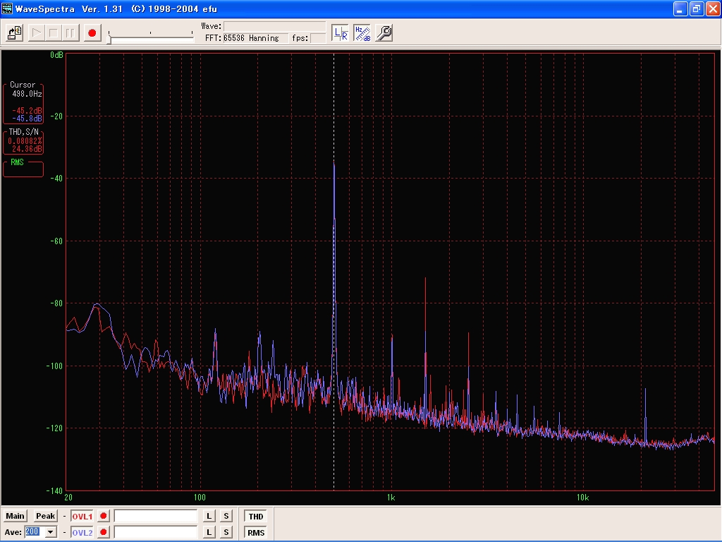

In view of diaphragm stiffness and compliance of the suspensions parts, a Japanese compared an Altec 515-8LF (Red) with the Sony SUP-L11 (Blue).
The frequency response was measured for 16-inch woofers from SONY and ALTEC. Both are 8 Ohm Alnico woofers.
Image 1. Sine sweep 20-20KHz.
I also compared the sine wave response of a single frequency.
The Altec (red) has a higher low frequency level, this is probably due to the influence of the room.
2. 100Hz sine wave
Blue has more noise than the 100Hz signal as a whole. At a 100Hz signal peak, it is almost the same for blue -41.4dB compared to red -41.7dB. However, except for the harmonic distortion at 200Hz (2nd order) and 300Hz (3rd order), the distortion of blue is on a whole higher than 15dB.
3. 200Hz sine wave
Again, there is a 20 dB distortion difference between red -27.2 dB, and blue -32.3 dB signal. Considering the signal, there is a total difference of 25 dB or more in distortion.

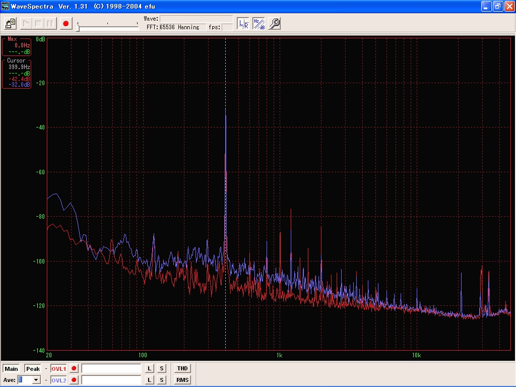

4. 400Hz sine wave
At this frequency, the response signal peak level is reversed to red -42.4dB and blue -32.0dB. Since the distortion level is about 10 dB different, it can be said that the total distortion level is almost the same. However, it seems that the number of higher-order distortion peaks of harmonic distortion (divided vibration) is clearly higher for the Altec (red).
5. 500Hz sine wave
Here, red and blue have almost the same frequency response and distortion level. After all, red has a larger amount amount of higher-order distortion.

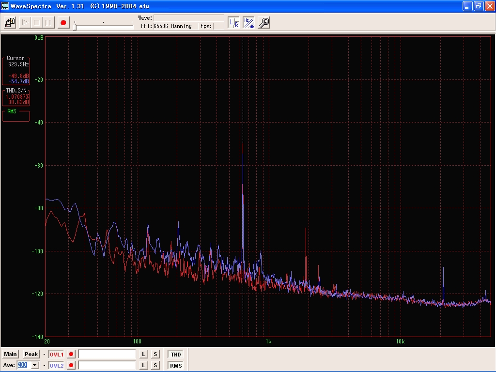

6. 630Hz sine wave
At the crossover, red is -49.8dB and blue is -54.7dB. This frequency is covered by the the horn driver, so I would like the woofer to be as quiet as possible. Again, blue has more distortion.
7. This is the spectrum of the second-order distortion at 500Hz input.
Regarding the 1kHz second order distortion, both are almost the same level: red -91.8dB and blue -93.3dB.
8. This is the spectrum of the third-order distortion at 500Hz input.
The third-order distortion at 1.5kHz was significantly different from red -71.8dB and blue -89dB. The 5th order distortion at 2.5kHz is also very different.
It is generally said that odd-order harmonic distortion adversely affects sound quality, so care must be taken.
Summary:
From the above, the noise floor of red is lower than that of blue. Especially in the low frequency range of 200Hz or less, the result shows that there is little distortion of 20dB or more. Harmonic distortion of the Altec (red) is clearly higher for odd orders. At 200Hz, the red peak and the blue noise floor distortion are at the same level. At 400Hz, the difference between the red and blue third-order distortion is clear.
Since the input level was relatively small and was 0.4W or less, it may have been difficult to attribute differences to the long voice coil (Sony) and the short voice coil.
It is remarkable that the 515-8LF sounds overwhelmingly low distortion when producing a pure tone like a sine wave.
By the way, woofers that use cones made of materials other than paper have overcome this problem with strong reinforced diaphragms. I think decentralized paper is now rather a minority. Unfortunately, with a reinforced diaphragm, you have to put up with a sound like an AV subwoofer that has too much mass to stand up and tighten. Compared to this, paper is still better.
2. 100Hz sine wave

4. 400Hz sine wave

6. 630Hz sine wave

spectrum of the third-order distortion at 500Hz input.jpg334.3 KB · Views: 76
spectrum of the second-order distortion at 500Hz input.jpg330.4 KB · Views: 78

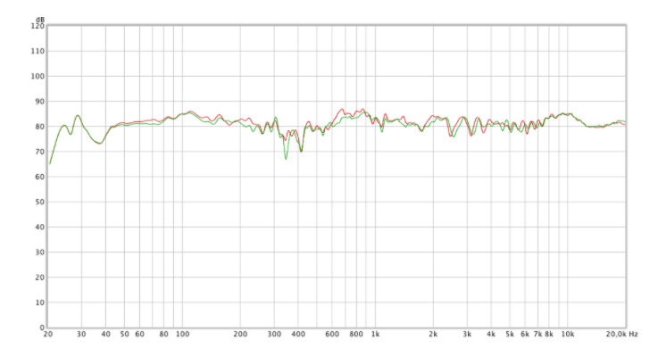

What cutoff frequency do you need fo rmastering and does it have to reach the same levels down low as it has for >40 Hz ?

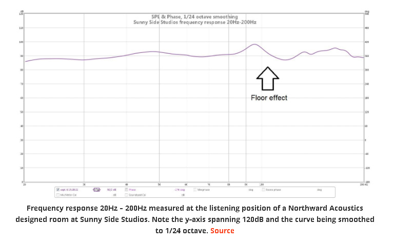

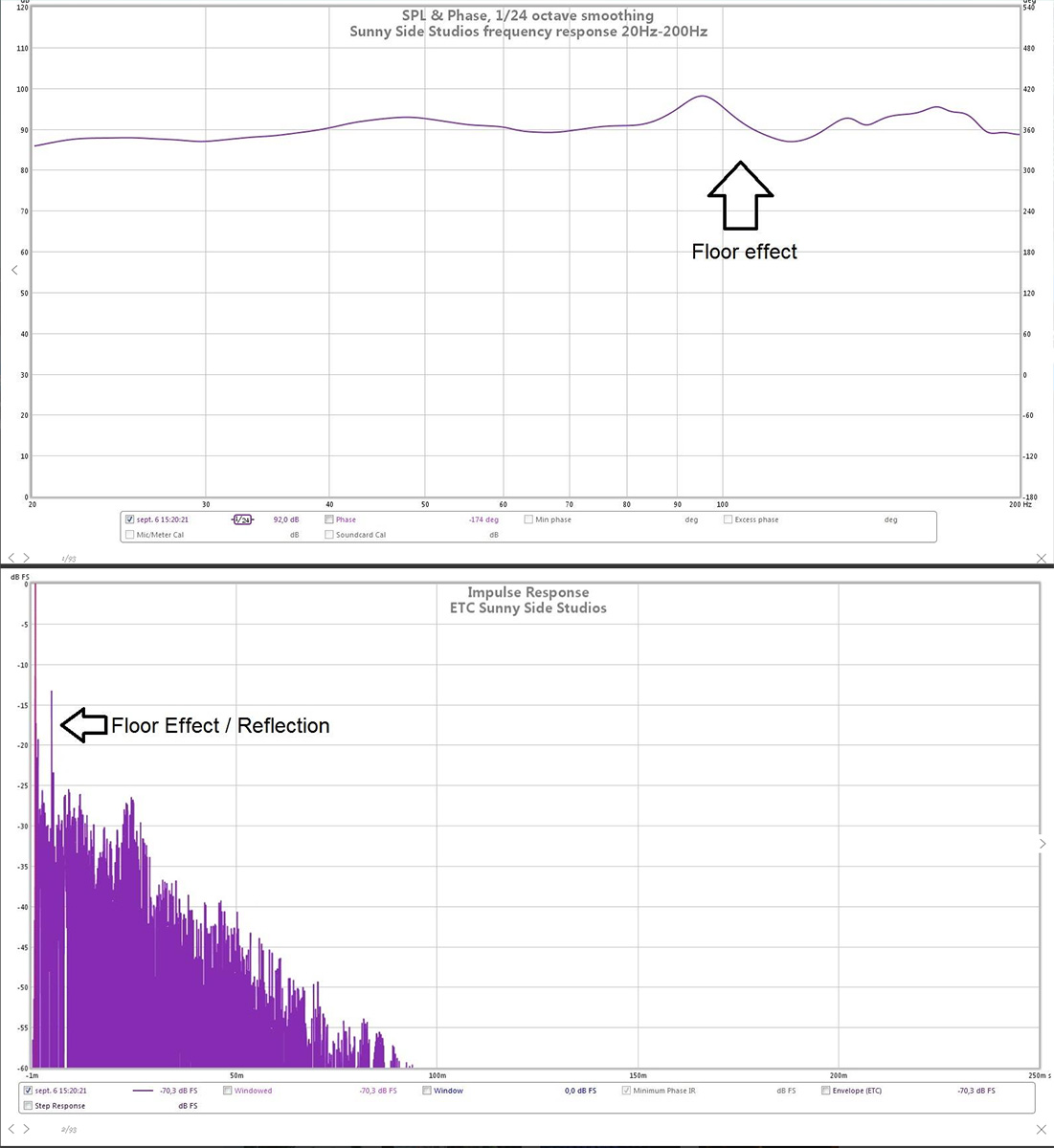

Curious also as 'flat' to me and at least one recording studio from way back when is 'flat' to the ear, so taken to the normal 20 Hz lower limit this means +10 dB referenced to 1 kHz, ergo the room could play a significant role.
At these frequencies the room (assuming a small room) plays a dominate role, making things like "flat" and woofer HP frequency and Q rather insignificant concepts in this regard.
If you don't want to call it flat, call it uncolored or neutral I guess...
Flat to 30hz is the standard for music
Flat to 20hz is likely the standard for Cinema
And then of course everything in between
I've always said that Big money is the only ones getting good neutral subbass in a room considered the challenges...
Becareful not to mix pink noise with white noise....the playback system is tuned flat to white noise...the mix is neutral in the respect of pink noise.
Maybe saying the word flat is to unnerving...can I say linear? basically smooth is really the idea...a flat line is smooth btw....even if unoptanium (expect for maybe headphones)...its just an idea I guess...I wonder what the house curve in a top cinema mastering studio looks like. I have a list of top studio house curves somewhere. The curves have names...
I'll have to dig some more but....but for mastering....+/-0db is the holy grail (to 30hz for most music and to 20hz for cinema like I said)
The mix has its own curve that relates more to the equal loudness curve depending on creative direction. Which also is related to pink noise as to how we hear sound as being equally balanced. The idea is that the playback system isn't adding character...if possible

An Inconvenient Truth About Room Acoustics (The Myth Of The Flat Frequency Response) — Acoustics Insider
Room's frequency response - Gearspace.com

If you can't take the room out of your mix, you can't take your mix out of your room.
What is required is a SMOOTH response, i.e., no nulls or resonances (nulls are especially bad)

Heres a nice home mastering studio FR
THis is what I mean by flat to 30hz....I guess flat isn't implied as literal. Flat means the most neutral you can muster down to whatever....yet....If flat were possible....why not...might as well just call it flat. Its flat as possible and literal flat is unachievable. Ill say Flat as possible in the future to avoid confusion.
Double the scale to 240 dB and it will look even flatter. Anyways, it's an anechoic chamber, not usually a good listening room.
There are different philosophies for mastering rooms...this is just one of many...but generally accepted, even by yourself I think, Is a FR that is smooth/linear in nature, house curves are personal preferences that do not deviate much from "flat" as in, flat as possible... I prefer a tilt with bass in favor...In regards to reverberation, as you say, the above is basically an anechoic chamber, I know of another approach that seeks to diffuse everything....in regards to the comment you made about an experience you had within a gymnasium where the time aspect was elongated and somehow turned into resolution...I think I would like something along the diffusion approach.
That doesn't look very nice or flat to me. Almost every speaker needs to have some tilt down from the bass to the treble to sound right with already recorded music. The amount depends on the speaker directivity and the room it is in. A cone and dome system in a fairly ordinary room (which is what many mastering rooms resemble) should have a tilt of somewhere around 1dB per octave from 100Hz or there about. A good speaker with flat on axis anechoic response and smooth off axis response will give this when put into a room.Heres a nice home mastering studio FR
This is not per se a room or house curve, it is just what a well measuring cone and dome speaker does all by it's self. A speaker with a flatter DI tends to have the on axis response designed to fall gently to compensate.
The 5dB bump at 600Hz will sound off and the similar bump at 8K will be quite sibilant. The treble being louder than the bass will make it sound bright. Flat anechoic and flat in room are not equivalent.
Yeah I dont know whats upwith those bumps but Id think/hope they could easily be corrected

Fluid what do you think of the sunny side FR and impulse response....This is just some random stuff I found in the heat of the moment to help paint the picture for Phase_accurate.
Once could potentially learn to sound engineer in a quasi anechoic room....or headphones....but I wonder why the challenge exactly...My first thought goes to room gain or room domination....I can mix/master in headphones ok...using wavesnx and hd600's...really its the headphones that are helping since waves nx barely has anything to equalize....then the room simulators I dunno....I haven't touched a mix since I started this journey of building mastering monitors....but I know so much more know thanks to this forum....I feel like Bass should probably be monitored in the far field to allow much room....but then the room has to be standardized....like the average American living room or the Average Club dance floor oir Average Cinema Theater...someone in the averages lys the happy medium for mastering, In my opinion. basically We needed to "dominate" the room aspect since the room dominates...removing the room is a broad sword approach.

Gm you are hilarious lol!!!only showing significant gain down around 14 Hz and then only just long enough to shake it, causing ~1/3 of the ceiling beginning at the sound wall to come crashing down on us.

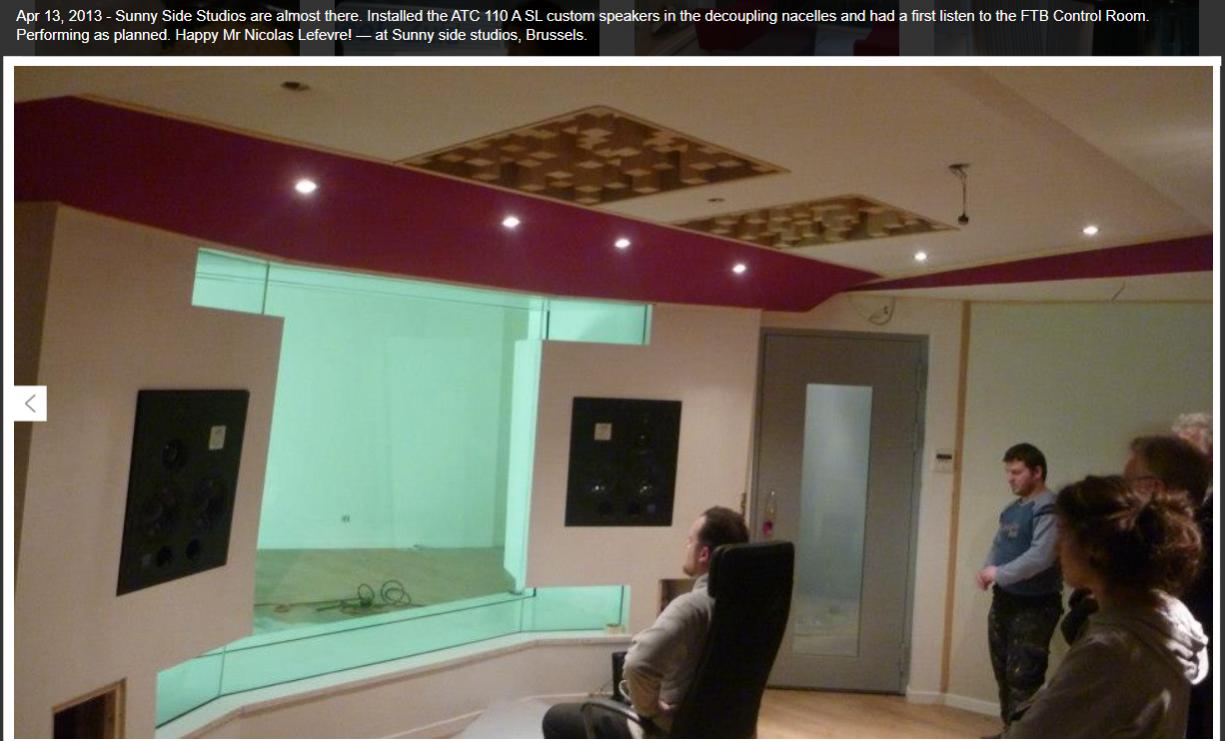

It's a Jounjean room designed to be practically anechoic and he does a pretty good job of getting there at -60dB by 90ms. There is a little bit of a Haas kicker at 25ms from the rear diffusors. The measurement was taken as seen in this photo with nothing in the room. With the desk and equipment it would not be so clean. The response in this environment should be flat so this can be confusing, if you end up aiming for the same in an ordinary room it won't sound right.Fluid what do you think of the sunny side FR and impulse response....This is just some random stuff I found in the heat of the moment to help paint the picture for Phase_accurate.

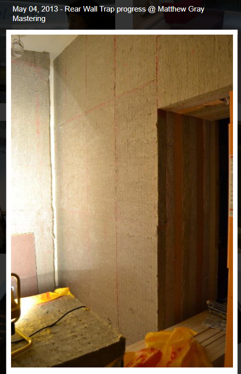

You can see the amount of rockwool being used in another mastering studio in Brisbane here
I think mastering rooms are too wide & too short, to put more floor space out where the musicians are. That is why IMHO they have to be non-echoic.

- Is it possible to cover the whole spectrum, high SPL, low distortion with a 2-way?
