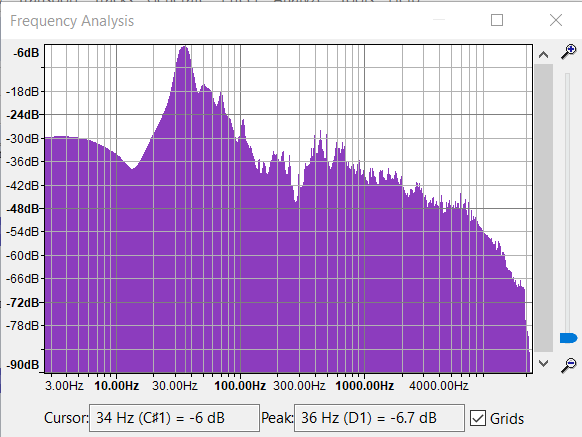

Lol at both comments regarding The bass in the Drakes Upset....that is exactly why it is one of the best reference songs to judge bass vs midrange performance....it is one of the lowest 808 notes (just above or right at 30hz) I've come across in a modern rap song, in particular, one with tons of radio play.
Either your system can handle it...or not.

You don't have to measure the song, set the volume up at the level you are listening and then use REW's RTA function to play pink noise and see what the level is. If it is a UMIK then the level is calibrated as well, if not then you will need some other way to calibrate the level like a cheap SPL meter or a phone app. iphone apps can be quite accurate as the mic capsules used in them are the same across many devices.Thanks Charles,

Played about with REW and the RTA function, very interesting, looks like I usually listen at about 75-80db.
Also had a look at that Drake track and saw much the same as fluid showed in his graph, big peak at 35hz.
