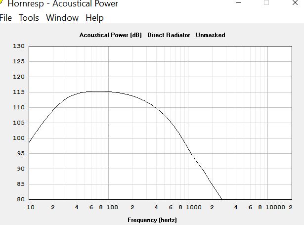

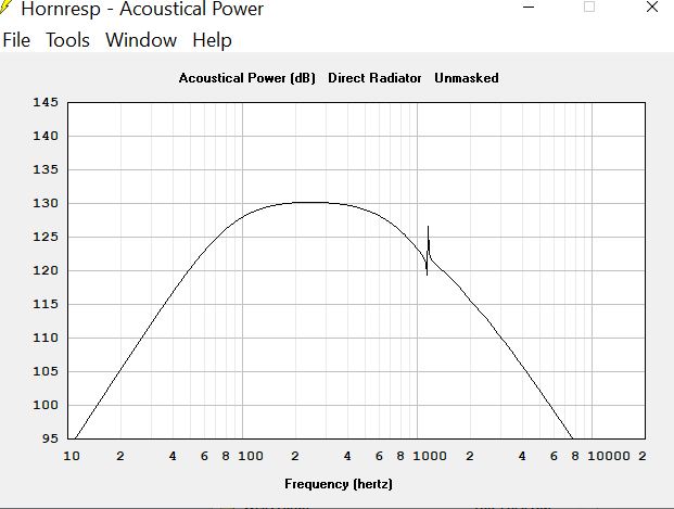

Hi Camplo, i am not an expert on T/S parameters or Hornresp by any means, but here's a few things i look at when comparing sub drivers....that might help sort out the 18+ vs Ultimax comparison.
Starting with sealed.
In Hornresp, i put the drivers in a box volumes that gives each a 0.7 qtc, and look at their power curves, small signal.
For instance the 18+ centers and peaks around 250Hz, whereas the Ultimax centers and peaks at around 80Hz. (see plots below)
It's a sub, so i just look at the low end extension i'm interested in...let's say 20Hz.
I see the 18+ is down 25dB from its 250 Hz peak/center. And the Ultimax is down 6dB from its 90Hz peak/center.
So now I have a sense of what frequency range they were optimized for. Time to bump up input voltage until diaphragm displacement hits xmax, to see what SPL they can really make.
Came to 1300w at 8ohm, 102v for the 18+.
And 850w at 4ohm, 58v for Ultimax.
With these net usable response curves, first for the 18+, then for the Ultimax.
My guess is you're probably already doing all that.
But here's the real comparison imo....
Look at the lower bound you want, let's just stick with 20Hz.
It's about 105Hz for the 18+, and 109Hz for the Ultimax.
Ime/imo, Any further extra response, sensitivity, efficiency above those levels ...whatever you want to call it...
is immaterial in comparing these drivers if flat frequency response down to the corner is the goal.
It's just excess, unused capability.
So the 18+ 130dB peak capability above 105dB @20Hz adds nothing,
just at the Ultimax 115dB peak above 109dB @ 20Hz adds nothing.
IF flat response is the goal...which for me always is.
Let's say 30Hz works for low extension.
Now it's about 112dB for both.
Once above a 40Hz corner, the 18+ starts to rule.
From 100-700Hz she rocks in at about 127dB net usable!
Oh, and another biggie.. EQ at the bottom cannot be used to improve low end beyond those curves...all that happens is xmax is exceeded.
This is the Achilles heel of sealed subs using EQ like a Linkwitz transform to get low end extension.
Makes for perilous excursion, and also requires a doubling of amp power per each 3dB boost.
Come to think of it, in home audio without amplifier output meters or at a minimum clip indicators, how do you know:
a. when the amp is clipping, when you're short power
or b. when you hear distress, whether it's the amp clipping or over excursion
or c. maybe both Lol....
How can you sort out the distress without knowing amp output???
Anyway, hope all that helps. And i hope that you can see where some folks were coming from with their 18+ evaluations..
This way of comparison of course ignores box size differences, amps required, and other factors, but i do think it's a pragmatic beginning in comparing how to obtain real world SPL...flat that is
