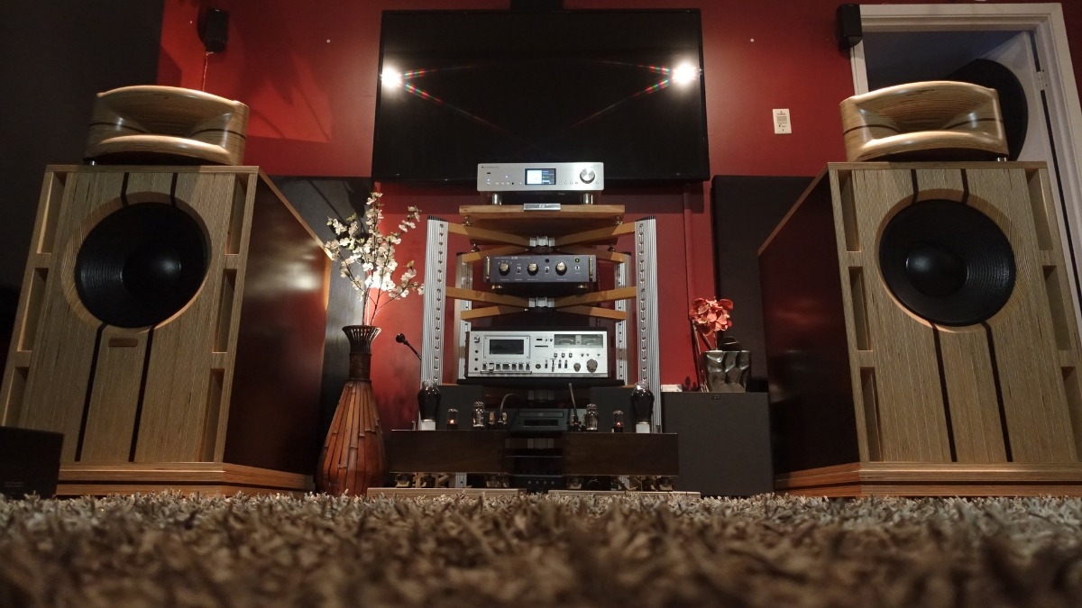

So how do I feel? I think that with a large enough woofer vs a low enough playback (Domestic?)....IMD is not an issue...I feel that for compression drivers IMD seems to be less of an issue concerning domestic levels...as I can play the Axi2050 with no crossover and levels reached loud enough while distortion figures raised though I never found xlim...with or without horn....I have not idea where xlim is and I am glad that it is beyond the dynamic needs of domestic volume. Its hard to say when or where IMD may have become an issue because we all know that there is resolution in directivity and with my horn attached directivity is raised.
Plenty more experimenting needs to be done, on my end. Understanding how to get it to play best is a good focus and no one has ever argued against lowering excursion lol
I know I didn't need a subwoofer per say and I have dual sets of 18's but this system is meant to be a flagship model. Decreasing excursion is the goal period...I like bass too, so outside of analytical work (sound engineering) I enjoy movies and video games as well and the tactile experience of bass is fun.

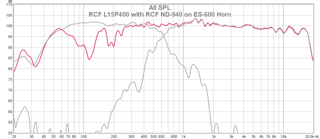

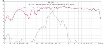

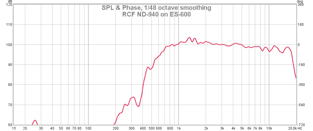

Joseph Crowe developed a 2 way that would comply with this thread.
It's based on RCF drivers, that I have also come to appreciate.
The woofer is a bit heavy duty for my taste, but at least η0 > 2.5 %, what I consider a kind of benchmark value for mid-range suitability and fitness for low power amps.
A SET or low power Class A amp won't breathe life into an inefficient woofer.
It's the exception rather than the rule that the response matches the one in the specsheet, despite the fact that the horns are completely different. The few subtle resonances can probably be further reduced by a simple Crowe-mod: putting a small amount of 30ppi open-cell foam into the rear chamber so that it gently presses on the center of the diaphragm.

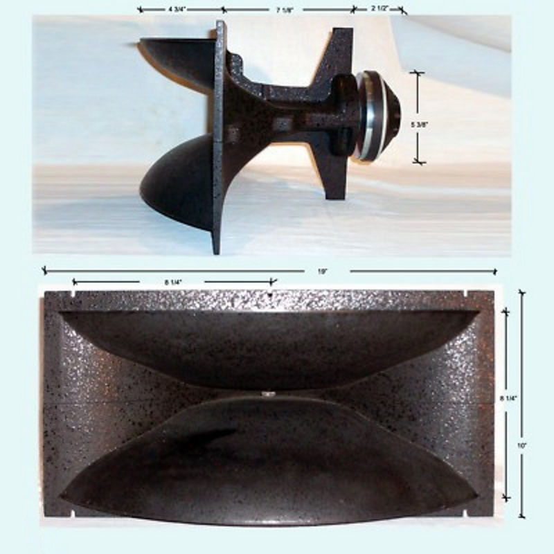

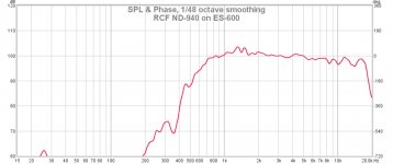

Thanks Ro808 for Joseph Crowe ES600 link & picture. I want to mount the 1200-17khz horn outside the Bass box. 22XT. I cannot lift 94 pounds onto stands, had to hire somebody to do that to my SP2-XT. So separate HF horn has been done by others. The box doesn't have any effect on the HF horn - as I suspected. Messy crossover wiring is a plus, IMHO. The burglar that stole the SP2-XTs 2600 LP's and 100 lb electronics parts left all my point to point wired amp projects.
ES600 appears to be 5 db down at 50 hz. I want 3 db down as the SP2-XT were specified. More sealed volume, I guess.
Thanks for posting the link, the solidstate v tube REW spectrographs towards the end of the page are most intriguing.

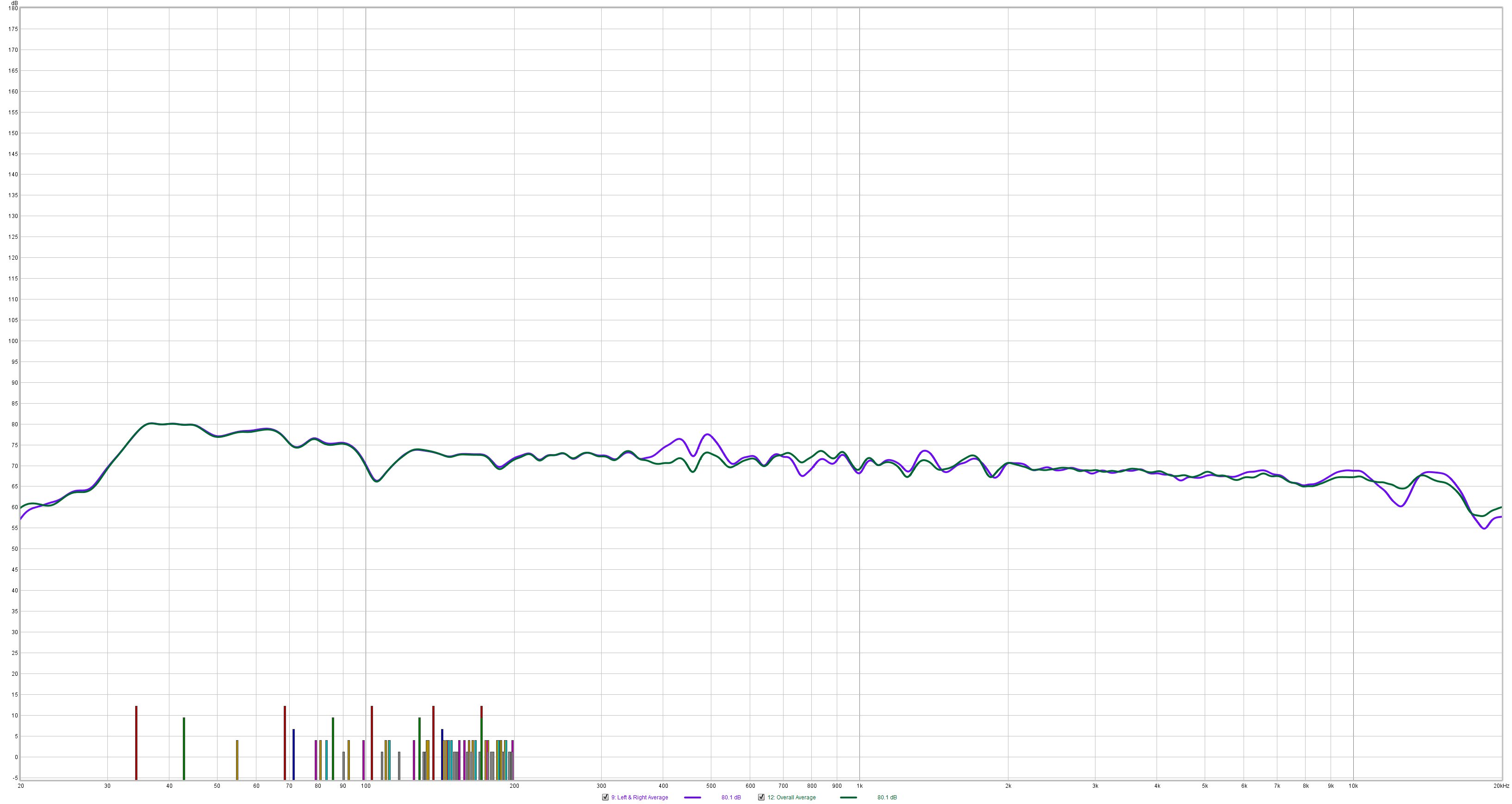

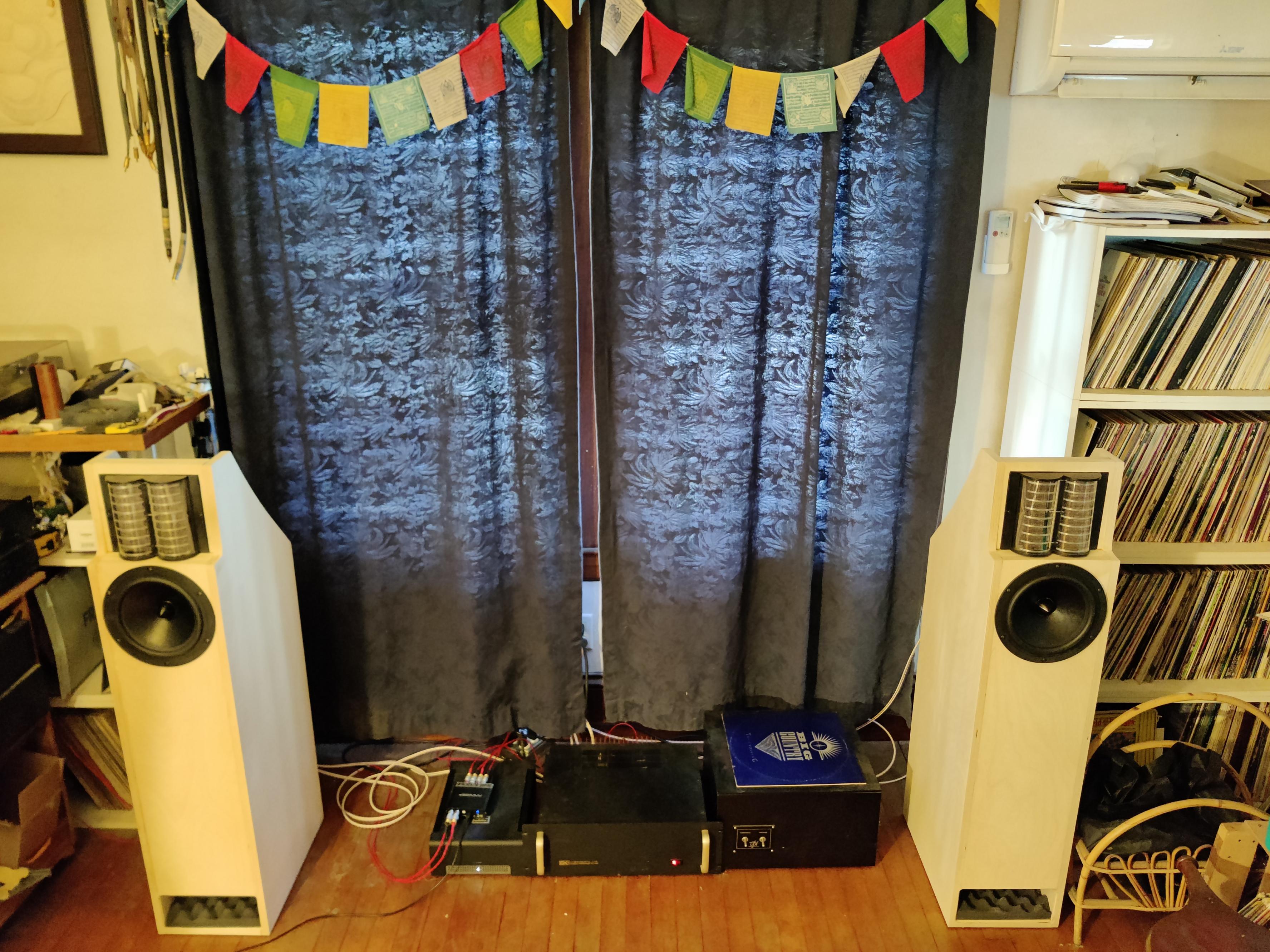

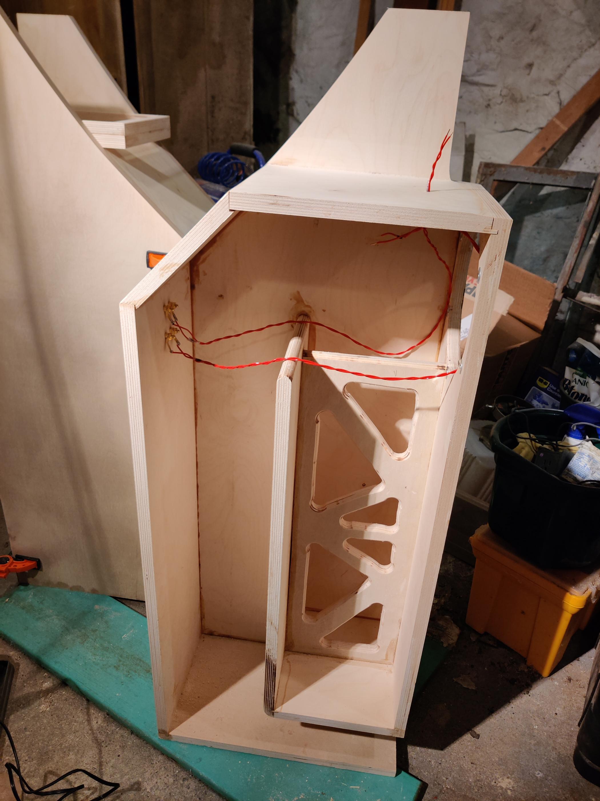

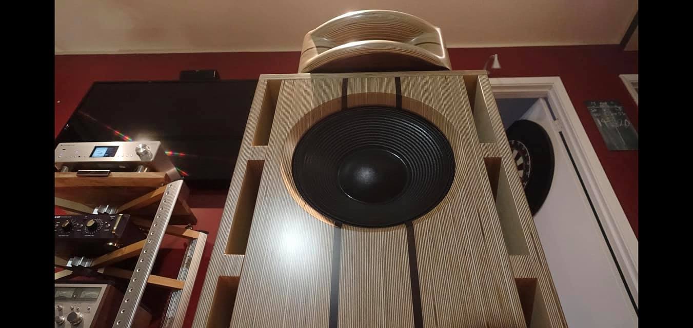

The MLTL speakers that I designed and built a few months ago are 2-ways that cover the audible spectrum.
The green trace is the average left and right in room response, on the listening axis (so about 20 degrees off the speaker axis) @ 1 meter. The purple trace is before the final PEQ was applied to the miniDSP 2x4 HD active crossover.
The Linaeum TLS (true line source) tweeter is crossed over at 480Hz, and driven by the B&K ST-140 amp. The Dayton Audio RS225P-4A woofers are crossed at 440Hz and driven by the Schiit Audio Vidar. My preamp is an Audible Illusions Modulus 2C.
The Linaeum TLS tweeters are from a model called LS2 made in the early 1990's . The two curved leaves (with fiber tape as damping) are driven by a 5.5" high voice coil etched on a rectangular film sheet, at the center. There are two bar magnets, one on either side. It is about 94-95dB sensitivity. I measured the TS data, and they are about 3.5gm Mms.
The woofers are wonderful - these are the same drivers used in the Alta Audio Alec speakers, which are also transmission line speakers; though they have a constricted terminus - it looks like a port. Mine obviously are a more conventional mass loaded transmission line. The woofer is about 1/3rd of the way from the closed end. The bass clarity and "speed" and power is better than any speaker I have ever heard. It is strongly down into the upper 20's and I am surprised by how often there is low bass in recordings I have listened to many times over the years.
These speakers (and the stock Linaeum LT1000) are my pandemic wonders. I bought a pair of LT1000 speakers from a pawn shop in Danbury CT on March 8th, for $400. My son, after hearing how good they sounded, found the pair of Linaeum LS2 speakers, just a couple of towns away; also for $400. We own the only Linaeum TLS tweeters that were available for sale last year, as far as I know. These are very rare, indeed.
Paul Paddock, who designed this driver, has not stopped developing it. I would LOVE to hear the newest version, called the WBLS (wide band line source). The one model speaker they sell is called the MC Audiotech Forty-10. He has been developing it for forty years, and each speaker uses 10 WBLS drivers - as an array they are crossed over at 100Hz! Each Forty-10 speaker has two 18" pro audio woofers in an open baffle enclosure - so there is NO DOUBT that a 2-way speaker can cover the whole audible spectrum.
I think that a modern MLTL design, with a masterpiece driver like the WBLS, would be the last speaker I would need to own.

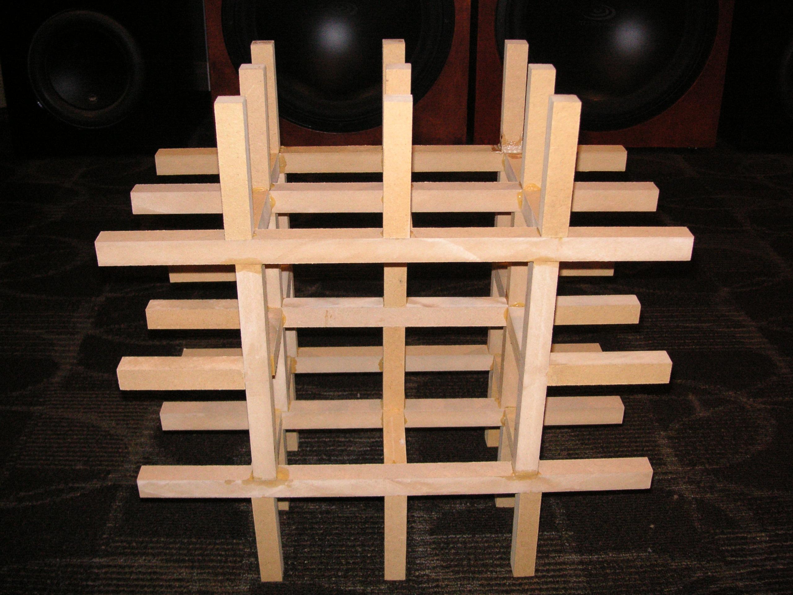

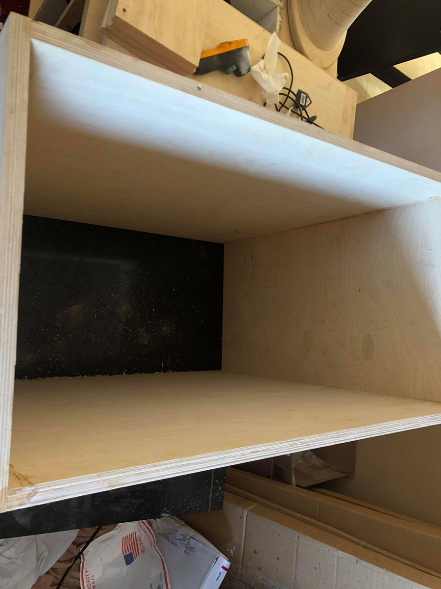

So before I do something unwarranted....
To brace these mid cabinets....my thoughts were to run a board the vertical length of the cabinets....maybe three total...one to the back of the woofer...and 2 on the other sides splitting the the space equally.
Hi Camplo,
Don't you have someone around you which can run a FEM simulation of your box, under Solidworks or another software package?
Akabak must does coffee, change baby's diaper and solve the problem of world hunger, no?
More seriously i don't know. But your best bet is a simulation of the box behavior to locate your brace.
ok thanks for the advice....the TL in me says to just divide the cabinet up into different lines...no ones looking to add extra bracing to a TL. I could use the sd of the woofer for a CSA of the brace wall spacing....matrix bracing also is an option...but I was looking for opinions from the board...I'll see if my engineering buddy has access to solid works
No really try to ask to someone using Abakak as they must know if it can. I know Solidworks have a plug in which can perform FEM.
There is a bunch of soft which can perform this kind of sim:
List of finite element software packages - Wikipedia
ABEC/Akabak is BEM and can give the pressure distribution inside the cabinet but for this type of analysis FEM or FEA is needed, Fusion used to do this for free but not now.
