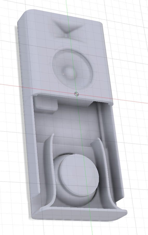

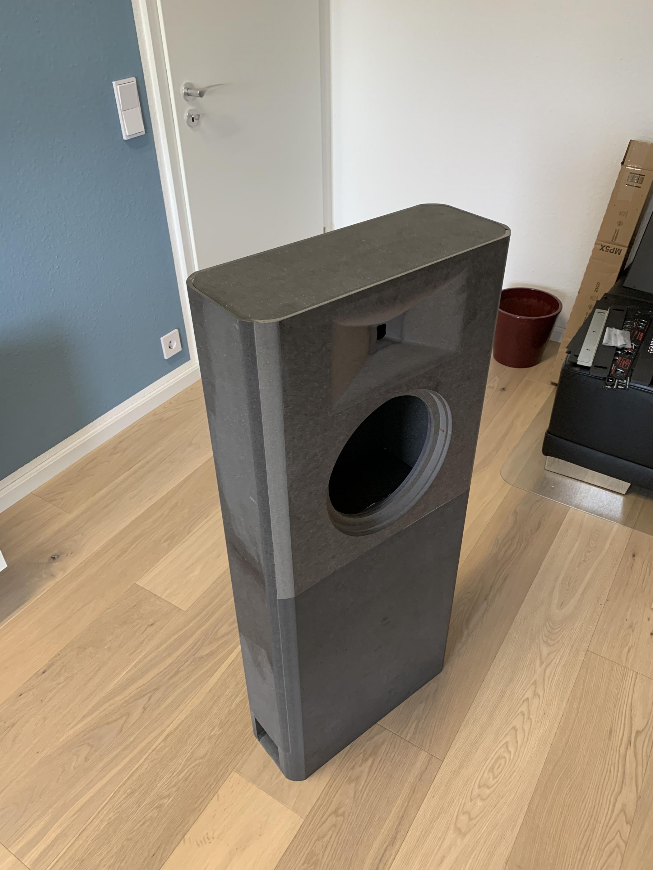

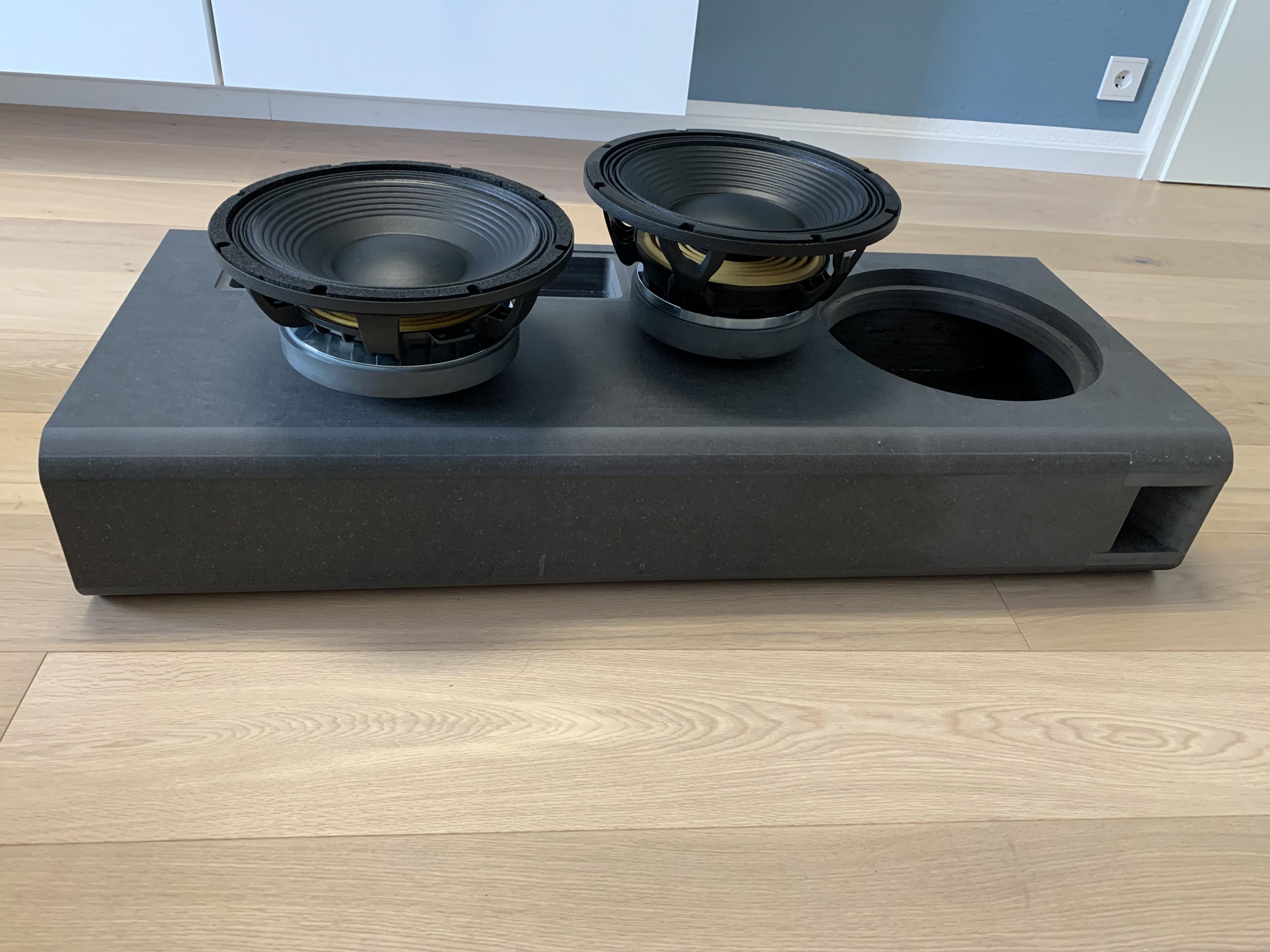

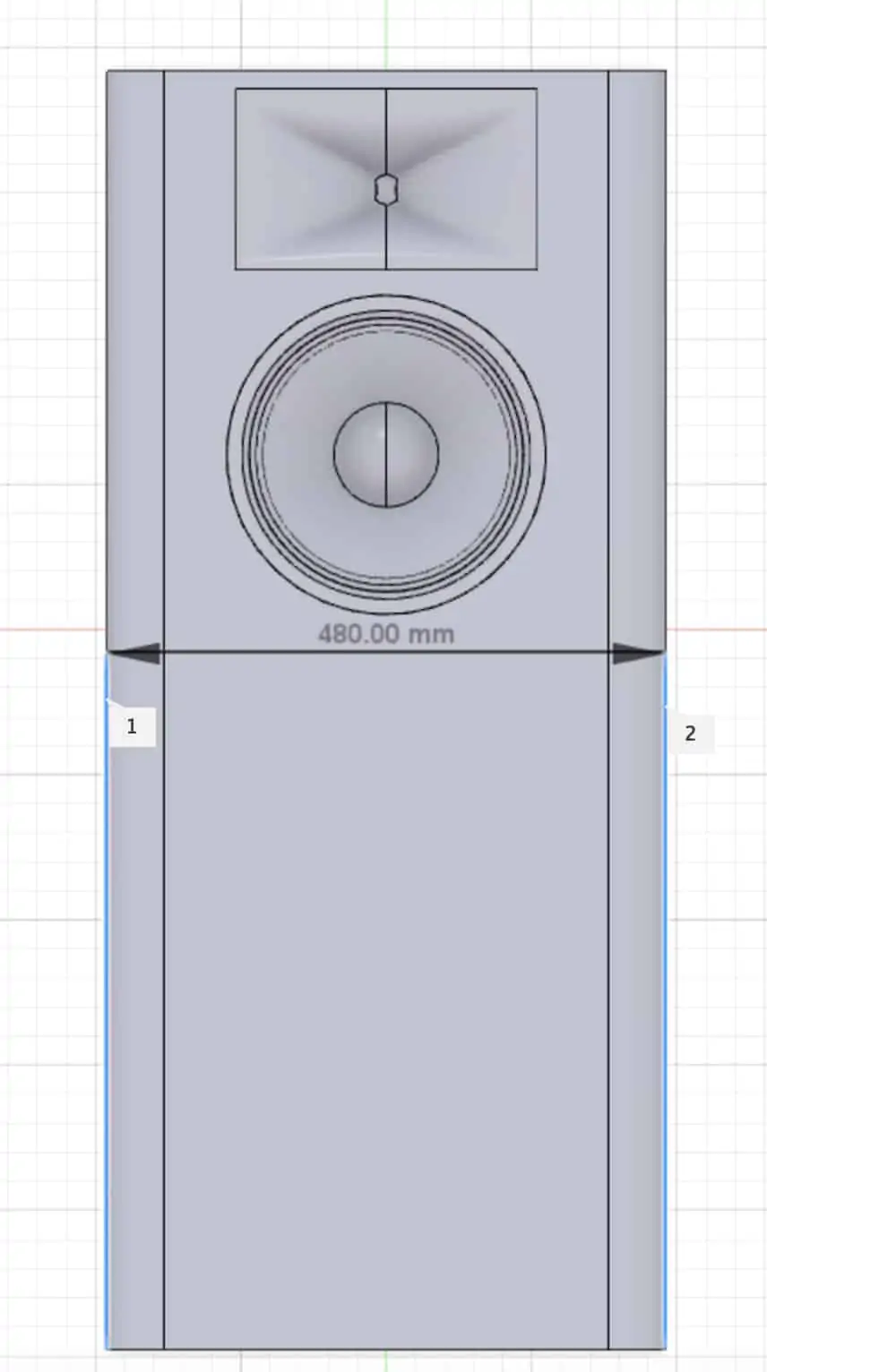

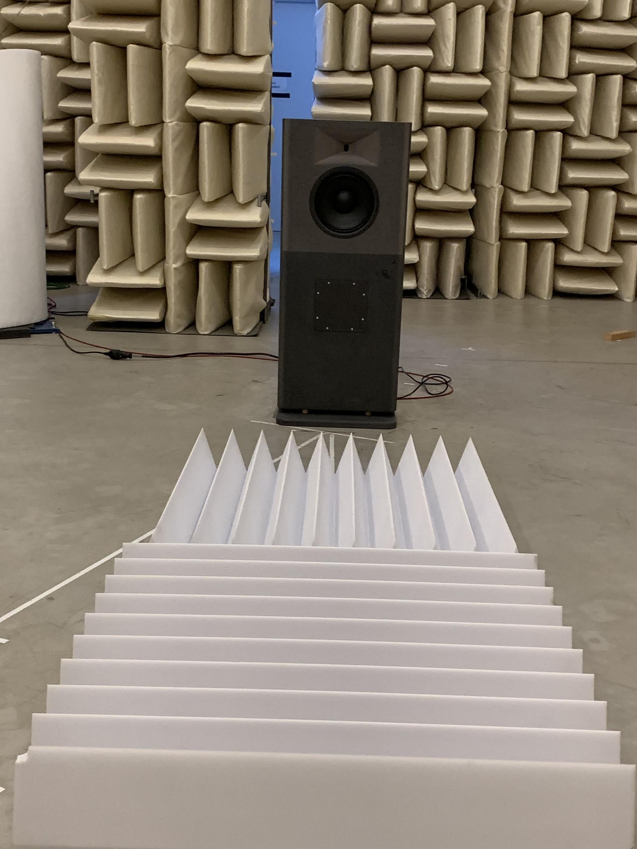

New kid on the cardiod block.
Finally one that doesn't rely on hifi drivers.
Specs:
- Wide and shallow baffle: 1100 x 480 x 185 mm (apx. 3.6 x 15.75 x 6 ft.)
- 44 mm (1.75") titanium compression driver + waveguide
- Midbass driver is a 250 mm (10") with an Nd-motor in a closed cabinet
- Additional bass is a 300 mm (12") mounted at the lower back in a ventilated cabinet (2x aerodynamic optimized ports)
- The overall concept is to shape directivity at every frequency in combination with the waveguide (heights), wide baffle (mids) and the cardioid pattern (bass)
- 1000W SMPS Class D per loudspeaker (Pascal)
- DSP filters are FIR based and linear-phase + limiters and dynamic-EQ.

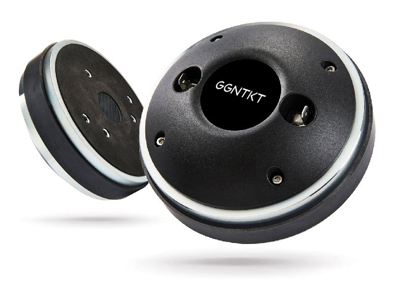

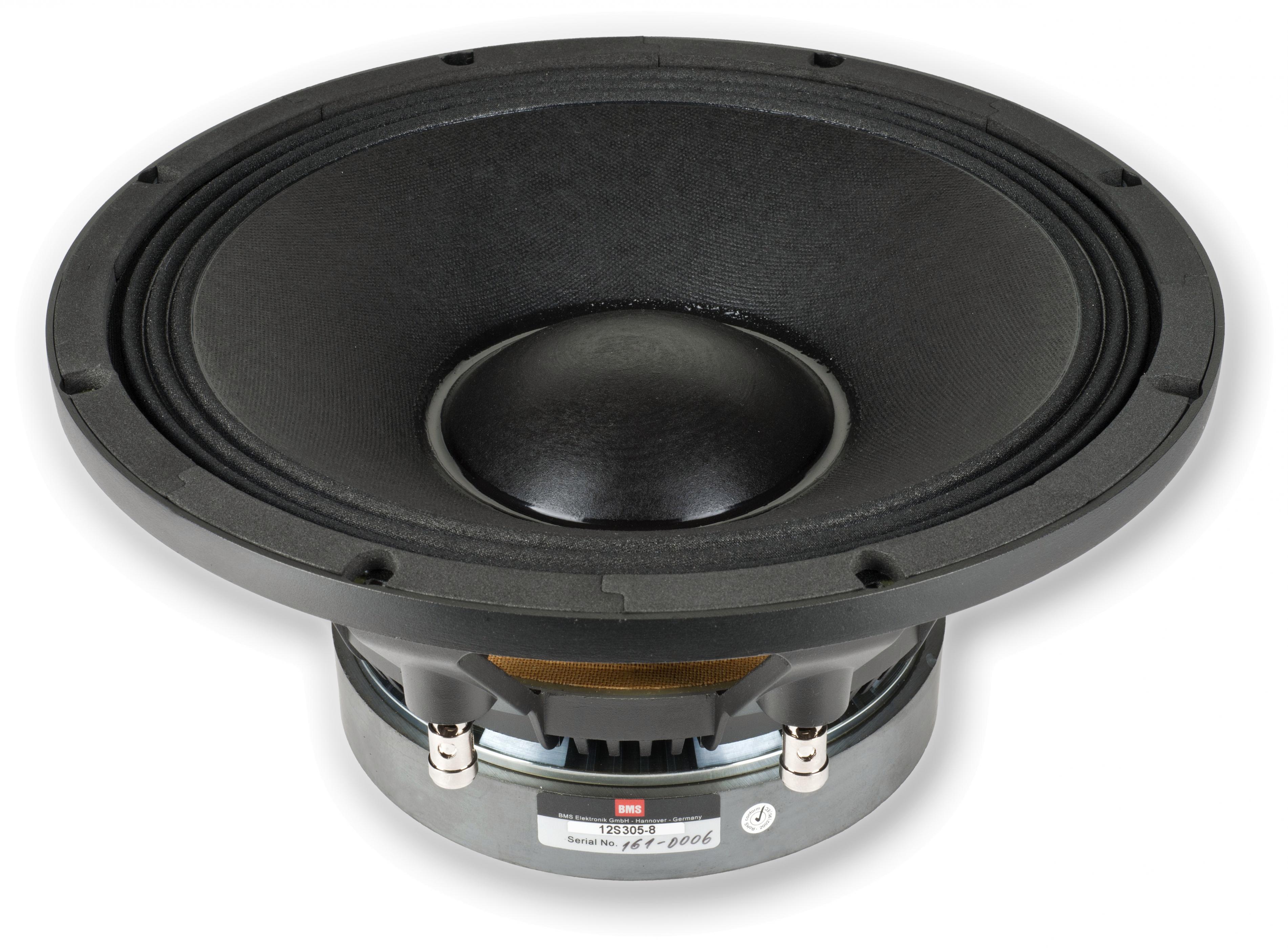

Drivers are (most likely):
- Celestion CDX1-1740
- LaVoce WAN102.50(LD) (Front)
- BMS 12S305 (Rear).

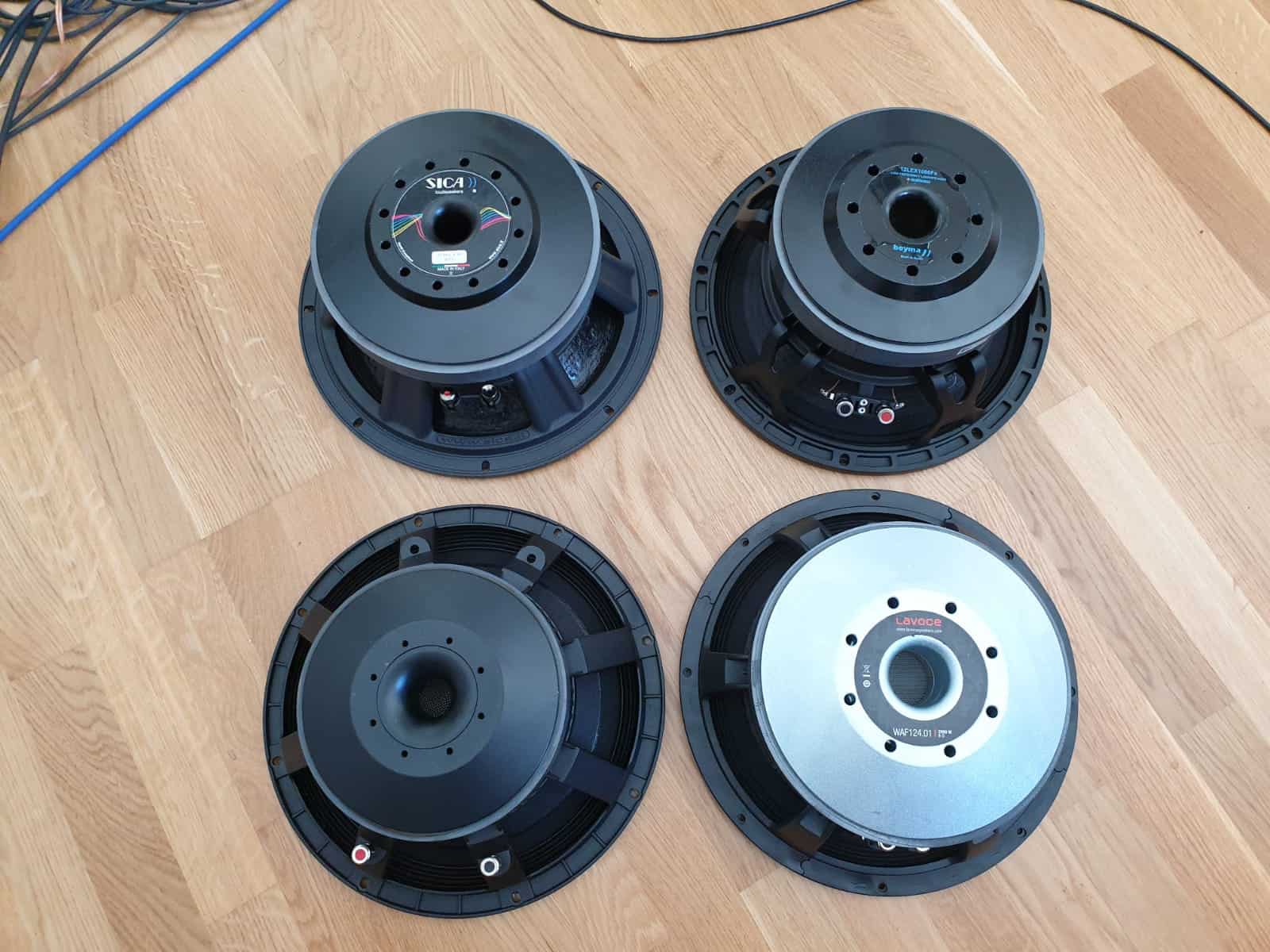

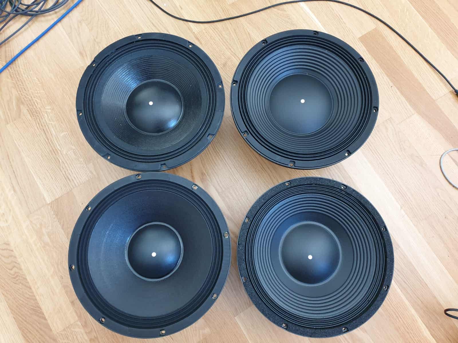

Yes, that's one of the drivers they've tested, like these 12s (the BMS, lower left, was selected):
- Is it possible to cover the whole spectrum, high SPL, low distortion with a 2-way?
