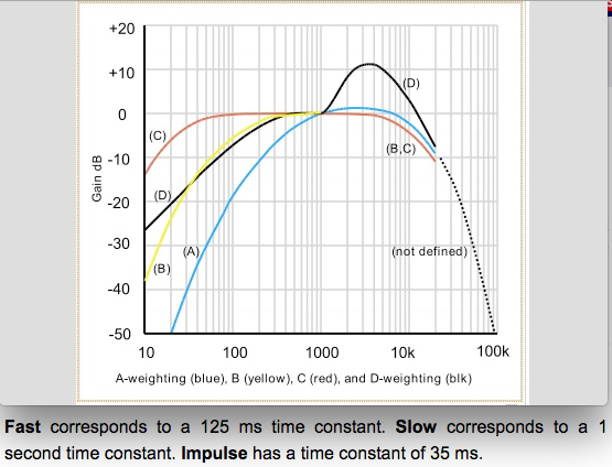

dB(A) is like a bandpass filter which cuts off the high and low frequencies. dB(C) has only a mild high and low cut. Hence for the same broadband signal dB(A) will read many many dB less than dB(C).
I did already understand the weightings but I don't think I was understanding the context of your reply. Did you mean that the true SPL could be up to 12dB higher than shown on the meter depending on the weighting used?
Depending on the weighting and time constant (Slow, Fast or Impulse) used, the "true SPL" could be far more than 12dB higher than shown on the meter.
For instance, a 30 Hz continuous sine wave would read 40 dB less than actual on "A" scale.
Dropping a spoon on a tile floor might read only 70dB SPL "Slow", while on "impulse", could read 110dB or more.

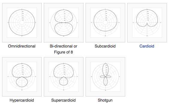

Whats the path to super cardiod for someone like us..or you...or we...or me...??
Do I need to pick up four 10" sealed back woofers, place them on the sides of my boxes and tune them with dsp?
Why would you want a supercardioid pattern?

Putting that question aside, rear or side speakers with dsp delay and filtering can change the polar pattern, like Kii uses.
Fulcrum acoustics has a patent on passive cardioid too, there is useful information on their site to look at.
I am just repeating things I've read that are likely incorrect...judging by the diagram you just provided (ty ty)... I don't know what type of cardioid pattern I'd be creating by placing one of these Beyma Speakers - Beyma 10MCF400Nd closed back carbon fiber midrange speaker with a neodymium magnet - Beyma 10MCF400Nd 400 watt AES 10" speaker for all midrange applications. Beyma 10MCF400Nd sealed midrange and other Beyma 10" speakers here. on each side of the mid box...or maybe between the the mid and horn even....those are pretty expensive though...I have enough amps...I wonder if it would be effective. What type of pattern do you get when you put the cancelling source on the sides?
I just learned you can use VCad to model it...but with something like the product I listed, used correctly...is that going in the "right" direction?
The Dutch 8c has left an impression on the Mastering Engineer community apparently....the only thing unique about it to me is the cardioid polar....The polar has been polished of course for sales but...non the less, it is apparent to me, that there is a rise in Sq to be had in every bit of deliberate directivity....so I kinda looked at it like, am I doing everything I can do....no....is active cardioid a possibility yes?....
The product I listed above, the Beyma, what you guys think of that mounted on the sides for the role? Maybe theres some better suited tactics for active cardioid?
You can get passive super cardioid by building the D&D but then opening up the back. Adjust the resistance medium, rockwool in my case. I thought it was going to be difficult but it was easy. The end result is not a product you can sell commercially or that would survive shipping but you can DIY it.
