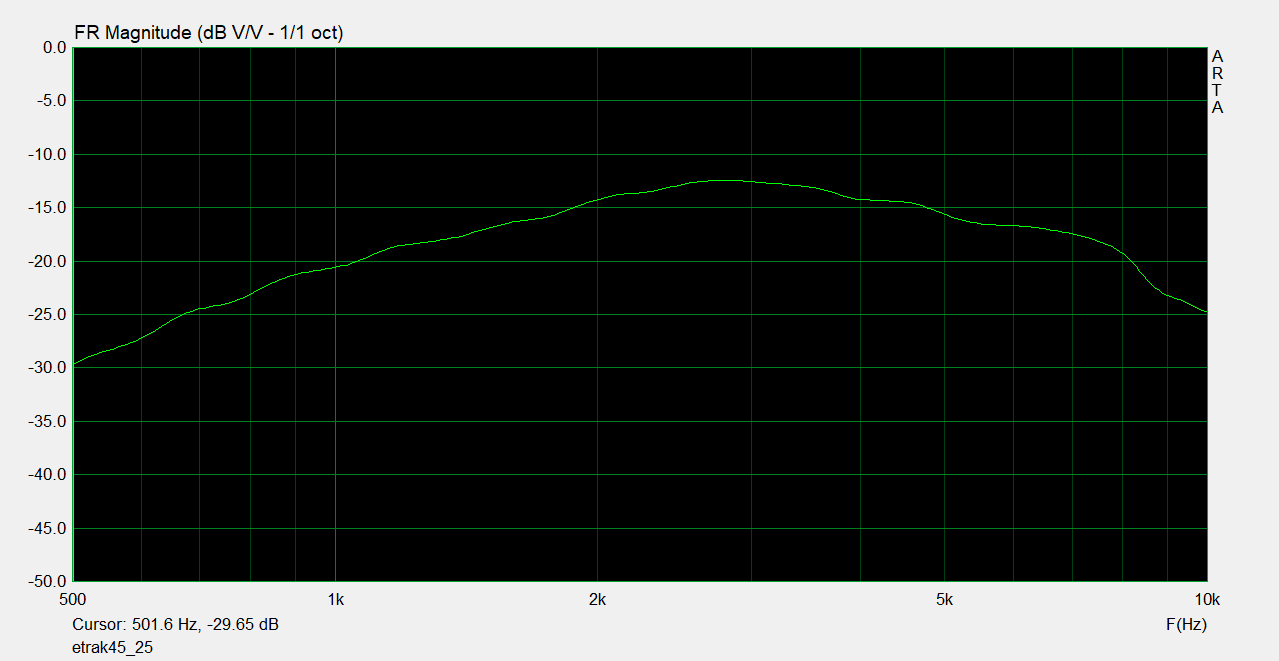

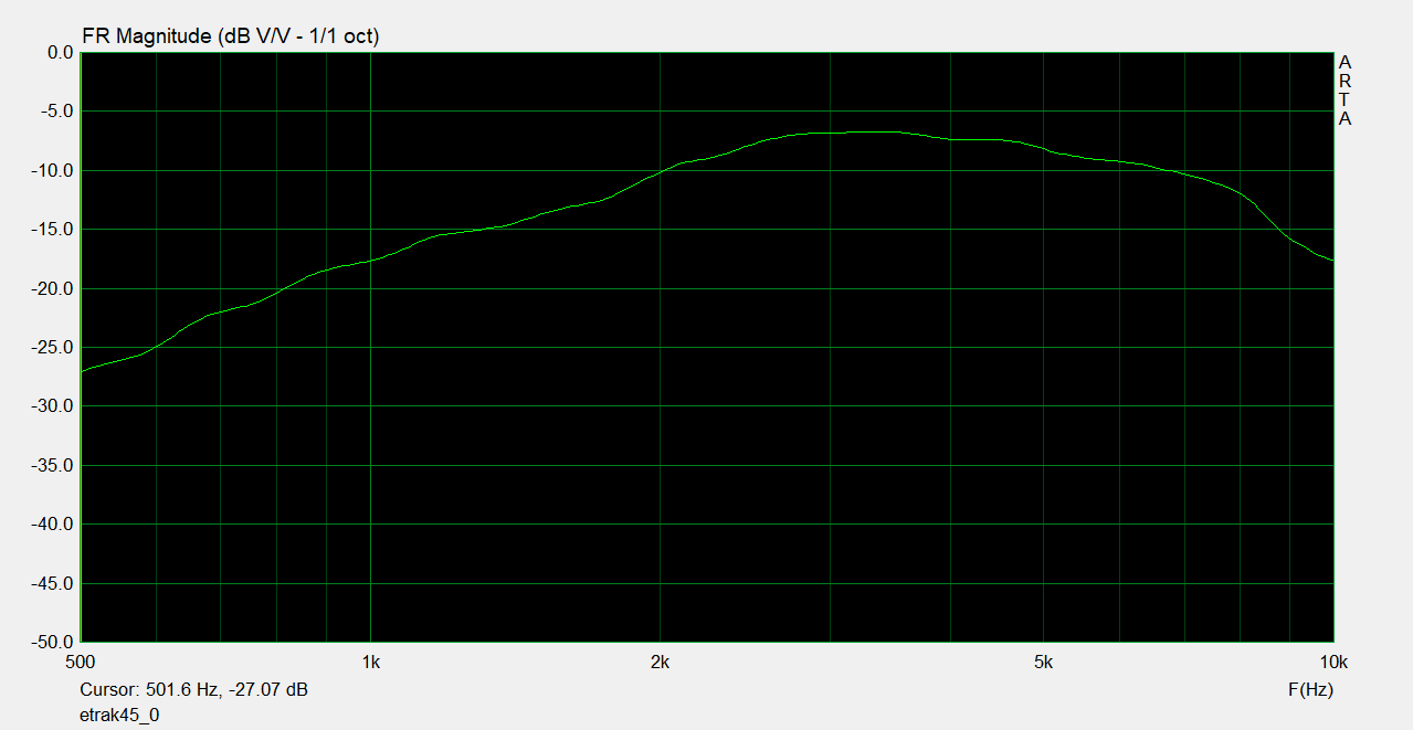

I think this started with wanting a smaller horn to widen dispersion...I sat down with a tone generator along with my current system and tried to get my impression of how high of a note I perceived my 15" covering before handing it over to this horn/cd combo...as seen in previous diaries involving the Axi, crossing at 300hz vs 400hz provide a different experience....theres 2 other unicorn type, well received designs also crossing at 400hz...(strauss and x1 uniwave)....I then modelled a 350hz tractrix horn in hornresp and checked out the polar map around 16khz (can't hear much past that these days)and down 2-3db....turns into ~ 15 degree beam width (not 15 plus/minus like I said above sorry)....which at 1 meter turns into a sweetspot the size of a basketball aka 9inch diameter circle...my head is the size of basketball...not literally but generally a human head takes up the same amount of functional space...for the experience and intent of this system, everything lives in the on axis sweet spot...I could have a 1" dome tweeter and I'm still going to "head in vice" it on purpose (when sitting in front of a computer playing a first person shooter how much bobbing and weaving does one really do with their head? non...where are you going to move too sitting 3 ft away from your stereo anyway).......thats my personal approach to applied theory for sound design intentions anyway. Jump down to 7000hz and the polar is down 2-3db at a sweet spot (beamwidth) the size of a 15"....for a person already exercising my approach I'd have to waiver back n forth in my computer chair, severely, like I had turrets... to leave that sweet spot ....from there it obviously gets bigger....and this is all at 36inches..... the other side of that coin is the idea that if I'm going to ride the slippery slope of the fundamental, I may limit myself dynamically....I ran into 7% distortion at fs(215hz)(how the fk is fs 215 btw?) at 91db....300hz and up were at like 130db and climbing(omg why is it soooo loud)....this is all at 36inches stillIs it possible to cover the whole spectrum, high spl, low distortion with a 2-way?...
Running test tones vs white noise....I can't stand white noise at 118db measured at the mouth....so my 115db at 1 meter goal that I strived for is so much over kill...but I made it...1 meter still has enough headroom to flatten the curve out at and cross at 300hz if I chose.....and play over 115db at 1 meter....which is just dumb loud.......so that means that I have enough excursion to play lower than 300hz with a 350hz tractrix horn.... No one at the beginning of this knew up from down in terms how much extension a horn and cd could have...I few speculated correctly....I forget who but someone show'd up with a ton of measurements finally proving that even normal large format compression drivers have enough output to play lower the....in short...even my readings for finding xmax at 215hz and 95db(1 meter) could be shy, I was holding the mic and kids where playing in the back ground, that should raise distortion? I just ran a another sweep came across as 123db at the mouth, reading 98 at my ear and its too loud...like for music, that would of been too loud...120db listening to music is so different than 120db a test tone....according to my hornresp Axi mockup I can play 105db and excursion is 9.7mm.....on a 350hz tractrix horn that doesn't model as low as my e-tractrix plays in real life for some reason.....so with that being said....If hornresp says I can hit 105db at 1 meter....with 0 crossover on a 350hz horn......how loud would that be if it were white noise or music?
So just did this...played white noise, brung up levels until it got uncomfortable....then ran linear sweep from 200hz-up (400hz 24db xo)......measured at mouth 81db peak....
Axi doesn't "need" a crossover with a large enough horn, sounds like....explains what I heard a week ago trying to get my eq set up....the damn thing was playing sub bass...which I heard in the form of intermodulation distortion....So the next interesting thing would be to verify xmax again without an xo...but its a side note...club volume is 115db....thats a full spectrum measurement....the Axi covering 400-20khz is never going to play that loud. 123db at 1 inch is 81db at 10 ft...thats just one Axi, able to play a sweep at 120db (measured at mouth) when I can reach near 140db (at mouth)....one axi is too loud at 10ft within xmax.....covering 400 and up.... Because I started off approaching measure with wrong idea, I have a low pass shelf with like a -10db sitting at 4.56khz....the response at 1 meter is a little bass shy so I'll have to redesign that filter, but its looking like minimal filter to get this thing to play pretty linear from the jump.
So a 115db listening session....whether 3ft or 10ft....the axi has enough to cover the actual spl for its covered (400 and up) spectrum....to be apart of a 115db full spectrum measuring listening experience (within XMAX)....which is still too loud....!!!! This is a view from one channels worth of drivers.... it seems to me that my theoretical approach is playing out in reality to my predictions.

of course can't see above 10khz.....

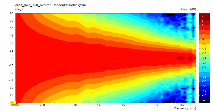

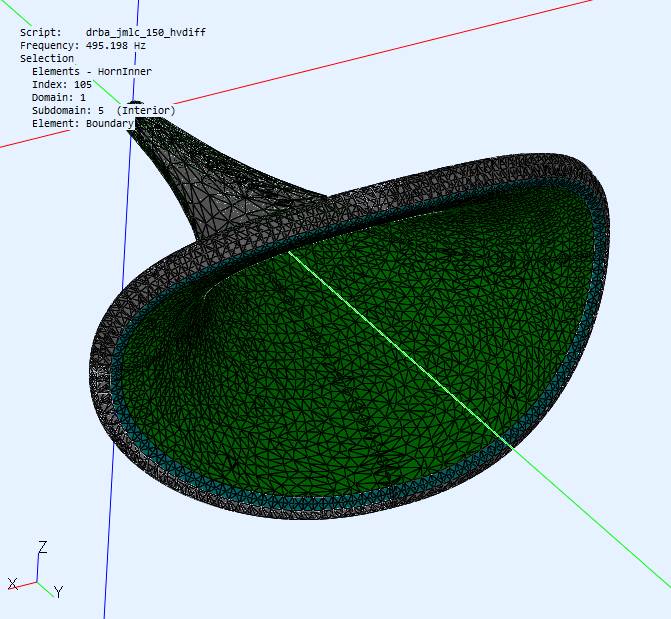

The horn profile isn't very different from the profile that we created together that Don K finished
attachment.php

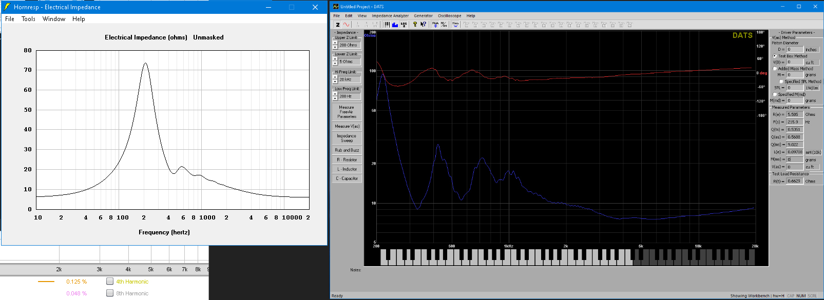

My thinking is that this horn (or any horn you guys develop!!!) as a ~300hz-350hz is going to be an improvement....over the e-tractrix...but I don't even know what the heck I have in full disclosure...
attachment.php
the hornresp is a my 350hz tractrix model....

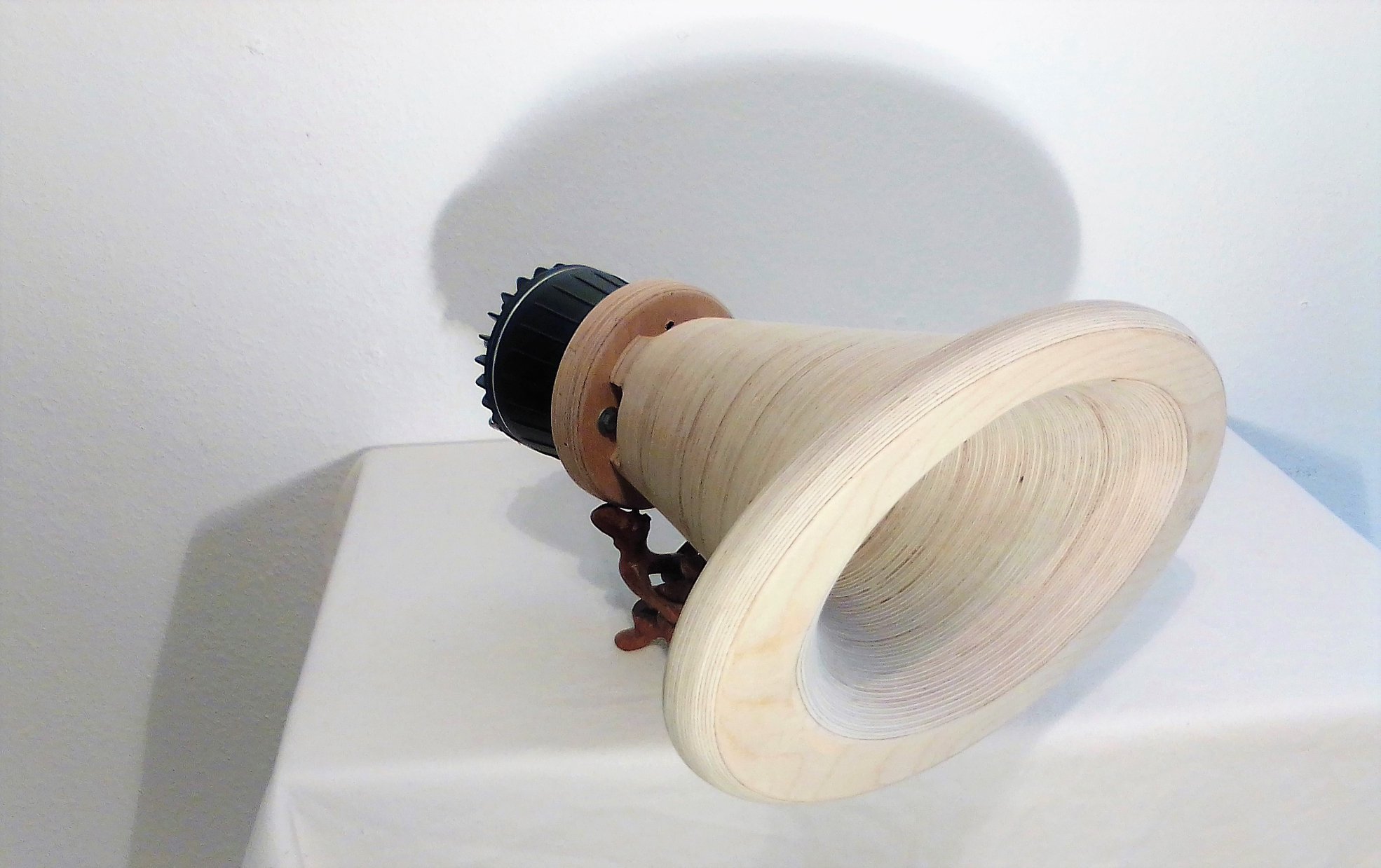

Do you even know where you want to be headed next? I think all of us were a bit surprised to see the above wood horn you had ordered.... maybe even a little disappointed...
Sometimes it's better to have a plan and stick with it...
Welt....here we are then aye....If we back track, I said that I wanted to cross a horn over at 200hz...then I theorized that horns that are generally around the 350hz tuning should be my limitation on top end dispersion....and forced my band on the cross over....
I theorized that I could likely cross the Axi over at 400hz with a 350hz horn....so far all signs say yes, but I'm not going to conclude on it until I have the system in configuration and run its courses....I theorized this by my lonesome and so far things are looking up...its at least within the Axi's ability dynamically...its acceptable of the horn via spectral decay... say what you will about the bump in GD at tuning.....still need to hear everything together to judge probably....
The first thing I did upon the horns arrival and after getting sound going...I played Billy Joel - The longest time..... the natural voicing of this setup renders near flat at 1m... (now I know that) so my first thought was why does it sound so neutral/transparent?....sounds like beryllium....first 2 thoughts within 30 seconds.....within the next minute I stood over the horn and pointed my ear at it, and moved left right searching for the obvious....this was high on the priority list because of all the neigh saying about a diminishing polar on top end of large salmon family horns...Smooth polar transition > size of sweet spot....I can say that much.
