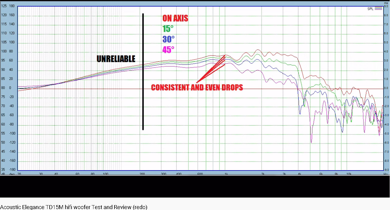

why does this seem wider than its supposed to be?
attachment.php

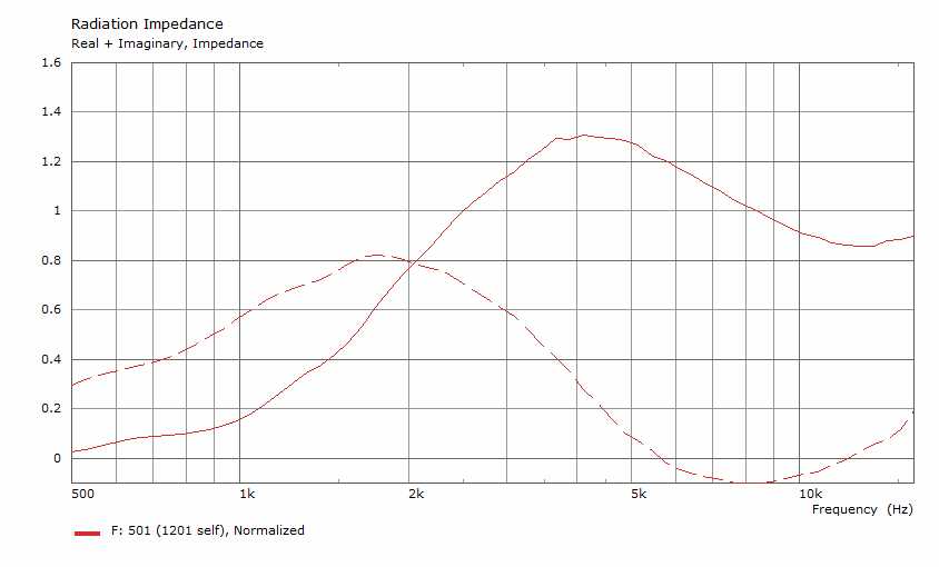

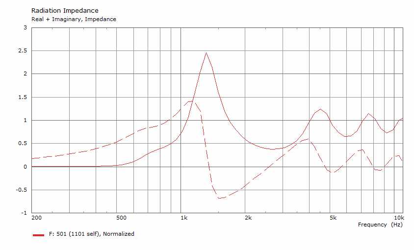

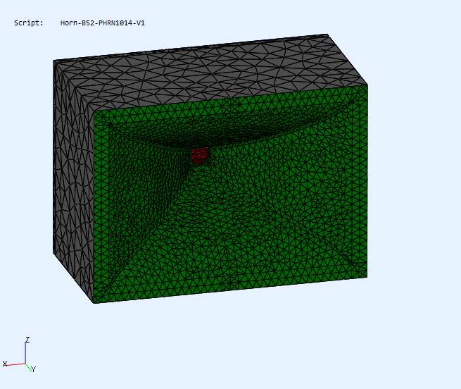

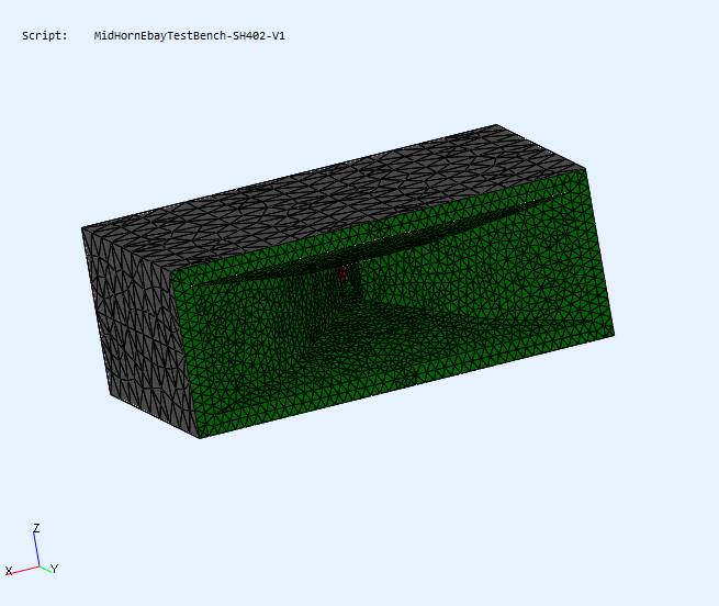

Let's compare 2 horns that I have both physical items and simulation models. The SH402 (like a 2370a, diffraction horn) and a PHRN1014 (like the QSC, OS like) both are approx 90x50 coverage and relatively constant directivity. The complete model sim data is at Modular active 3 way - work in progress They are advertised to be useful to 400Hz and 500Hz respectively.
The actual SH402 requires 6dB EQ to make it flat at 800Hz, and the PHRN1014 requires 12dB and you can see that in the RadImp (loading) graph differences. So the answer depends on how much EQ you want to apply as you force output at lower frequencies. Both horn mouths are large enough to control the wavefront to approx 600Hz and used the same compression driver.

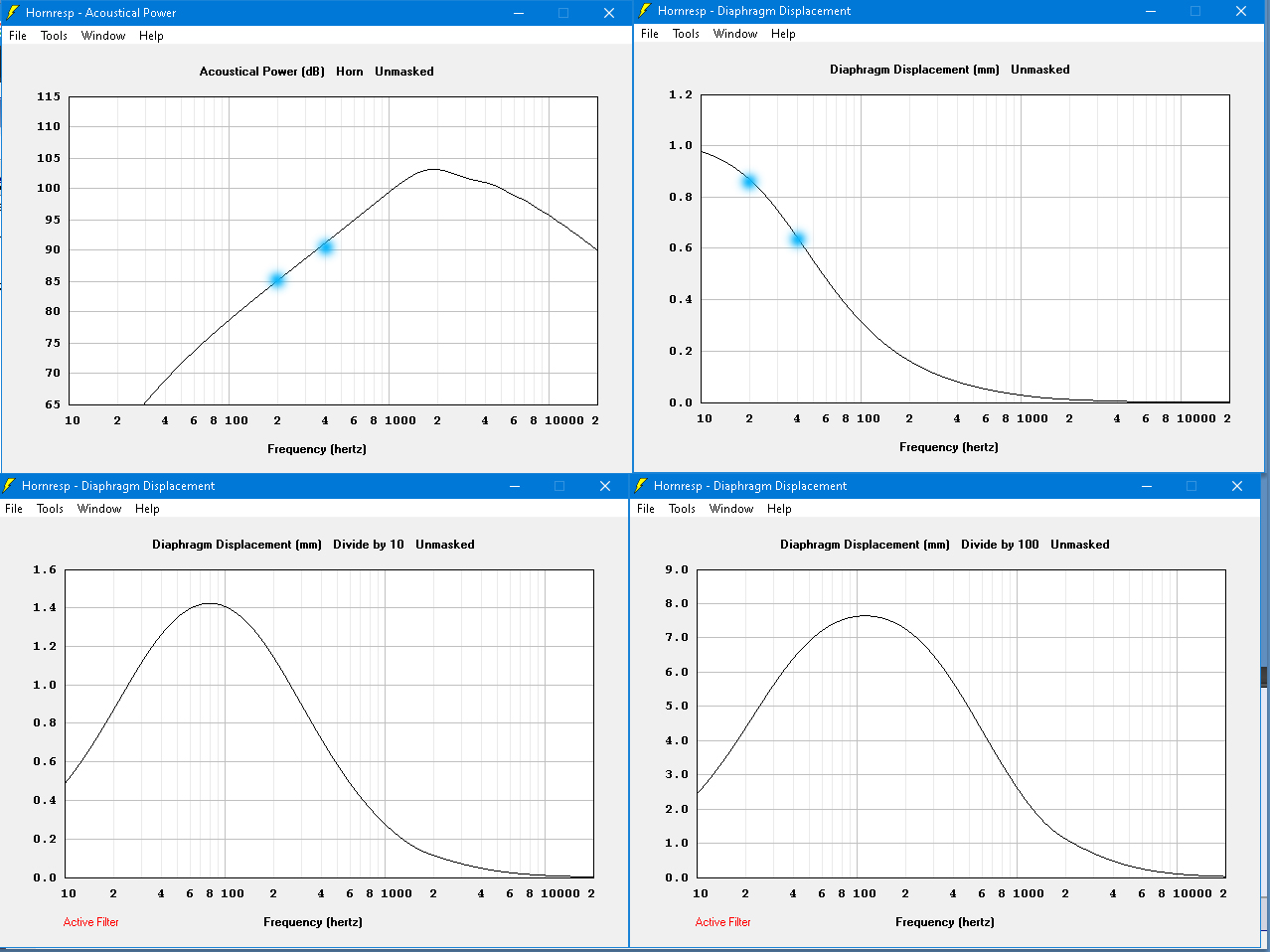

ok I reaaally need to pay attention to my hornresp modelling cause I let the calculator change my exit size...ok
The smallest thing I can sim is a 1000hz horn...
but I can see that as long as my dimensions of the diaphragm are close, with this 1000hz tuning, theres no support at 200hzand400hz right?
attachment.php
if thats too big let me know....on a 65" screen everything is small to me)
um the bottom left is after a 200hz 6db butterworth and the right is a 400hz.
Thank you for showing this Don. My first thought is that these two horns have resonates within the passband...with a waveguide the tuning is generally out of the passband (or at the tippy top of it, looking at Fluids waveguide) so the EQ is going to look different but your though set still applies, after all is said and done ...done how much eq...they are able to produce waveguides where the on axis response is nuetral...from the horn aspect, it starts at the Axi's free air measurement from here?

Let's compare 2 horns that I have both physical items and simulation models...
...Both horn mouths are large enough to control the wavefront to approx 600Hz and used the same compression driver.

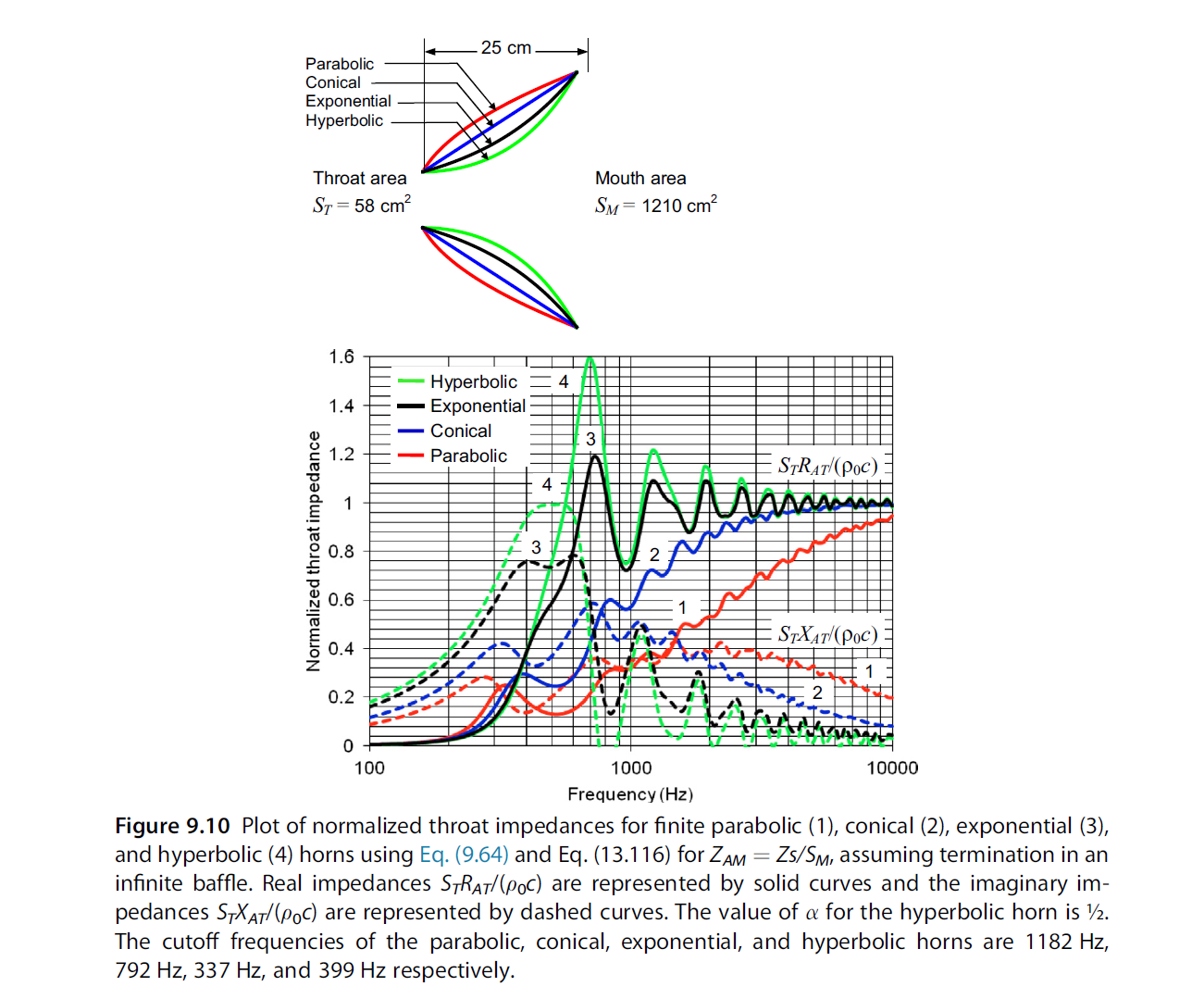

Up-to-date overview of horn profiles with their respective impedances:

Let's compare 2 horns that I have both physical items and simulation models. The SH402 (like a 2370a, diffraction horn) and a PHRN1014 (like the QSC, OS like). They are advertised to be useful to 400Hz and 500Hz respectively.
The advertising obviously has nothing to do with practical reality 🙄
The values should be doubled, the 2370a can be used from about 800 Hz and the PHRN1014 from 1000 Hz.
