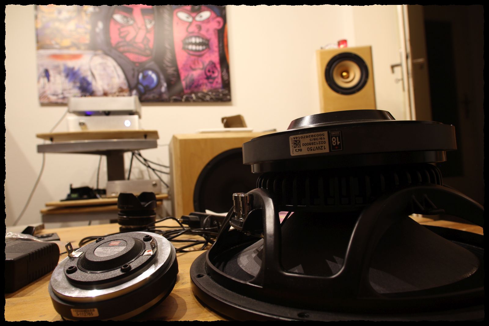

Today my first (a used) 18 sound 12 inch model arrived, a spherical wave horn with a 1 inch BMS [4538] driver is planned.
Due to the coronavirus I will unfortunately not be able to cut wood until mid-February

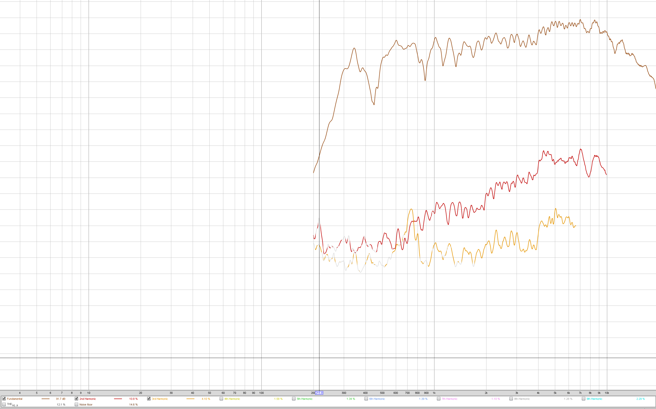

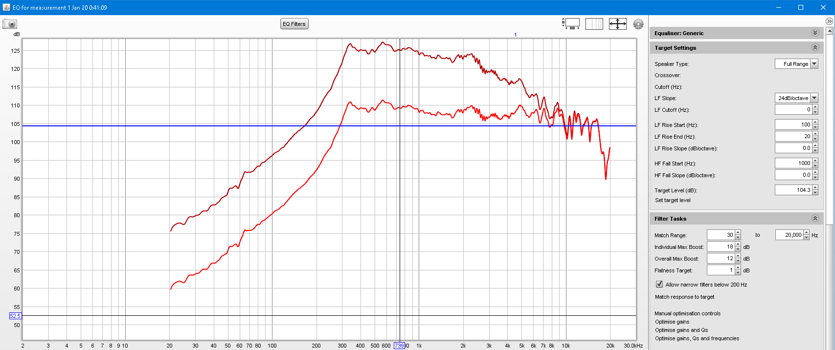

The measurements at the mouth are the most intimate, no? so if any resonances were to be recorded, this is a great place to inspect, correct? The measurements look pretty good to me...I did not see any one make a comment so I guess I will speak on it. The spectral decay being comparable if not better than the SM75-150....I get excited.
I have not really gotten intimate with the combo, but I do believe I have found the xmax or close to it....this is why I posted the quote about titanium the other day, lol...and no I did not here any clacky sounds....the sweeps were done with kid noise in the back ground, I don't know if that would throw my thd readings off but...
Thats at ~ 1meter (with eq), I was holding the mic lol, but I did measure the distance...Funny story about the voicing...I don't recall measuring without eq at 1 meter, so the (uneq'd) curve is actually a lot closer to flat at 1 meter...which describes why what I was hearing sound so flat.....yet the measurements at the mouth...I'm sure you get it...thats definitely a rookie mistake, laugh at my expense 🙄...So my first attempt at eq, i let REW do to its thing just see what would happen...but that was a no go...but eqing it the way I would of thought first .....with one low pass shelf... I can pretty much get it going in the right direction...
the measurement above (first pic) had just one low pass shelf, with about 9db of attenuation....which is too much...if it turns out flat at one meter with no eq I'm going too be happy but also facepalm...also the dips in the response are from the ceiling again....itis just not convenient to take measurements here lol! It will be more conducive when I get everything set up.

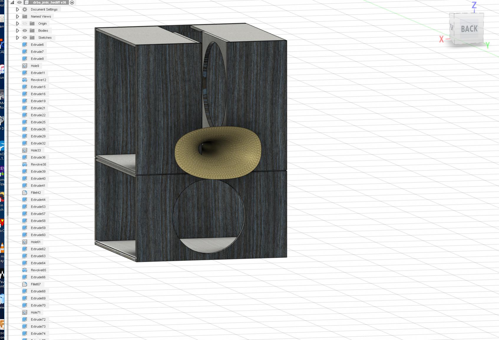

I made a crappy model of the horn again, but closer to the real thing, this time I used a 2" source with a baffle that was the rectangle size of my horn....so theoretically speaking my horn, in real life, might have some similar polar? probably not close at all but better than the last model lol!!
Finally does this
make sense to anyone? In terms of ideal?

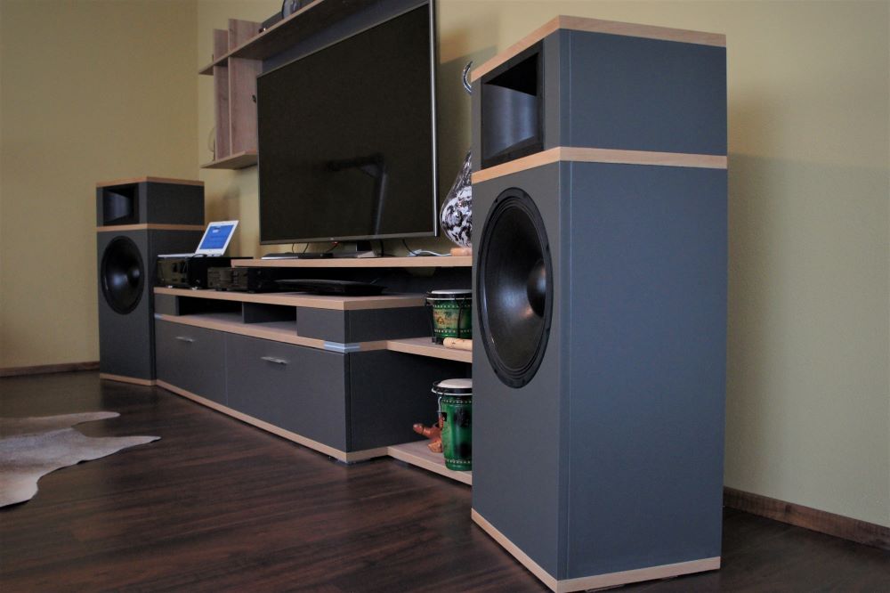

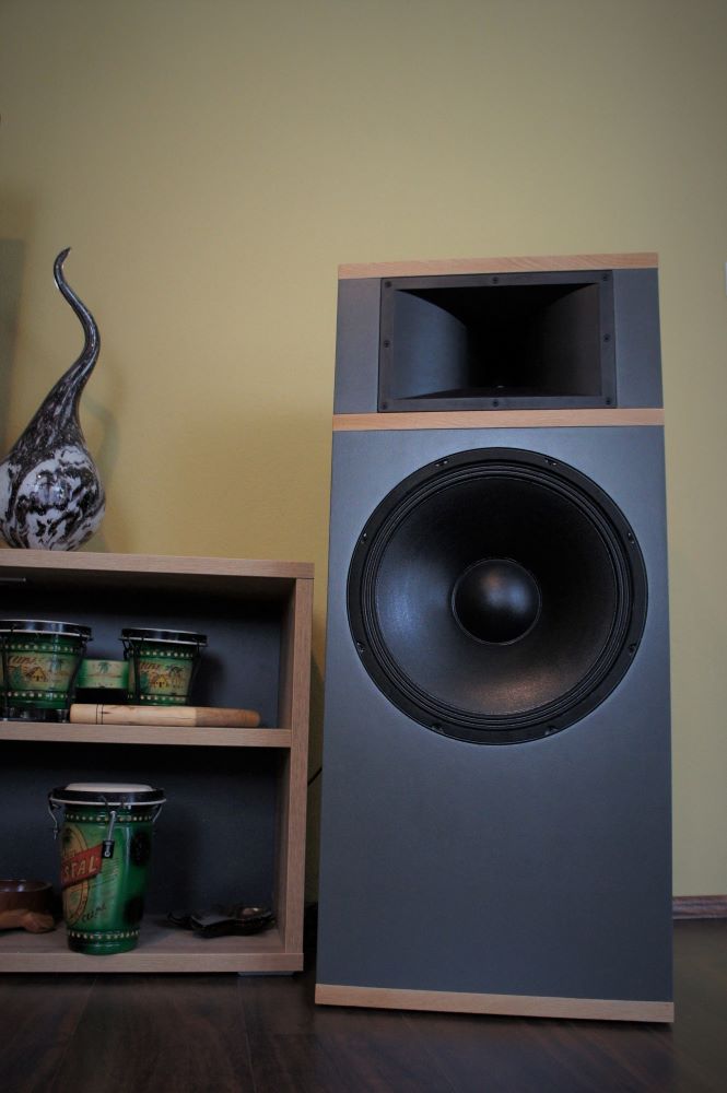

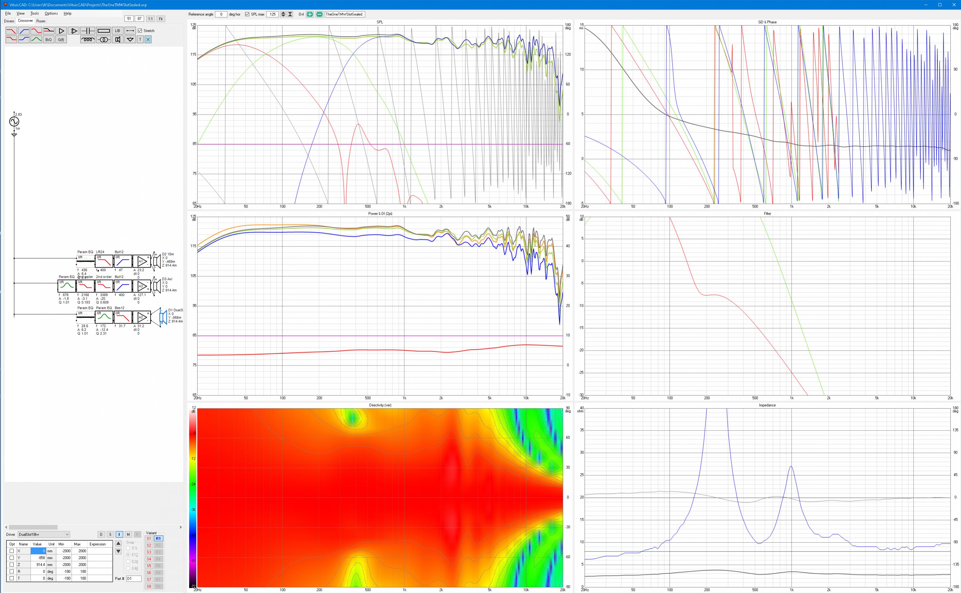

Sorry, I haven't read the whole thread, but here's my 2-way that fits the topic quite well. The drivers are LaVoce WSF152.50 and Tymphany DFM2535
Hi Rese,
Nice two ways!
What internal volume did your cabs end up at and are these ported or sealed?
Thanks.
Very nice speakers with color matched furnitures. Why you crossed them @1.5k? You could make it a bit lower than that if you want to, I guess...

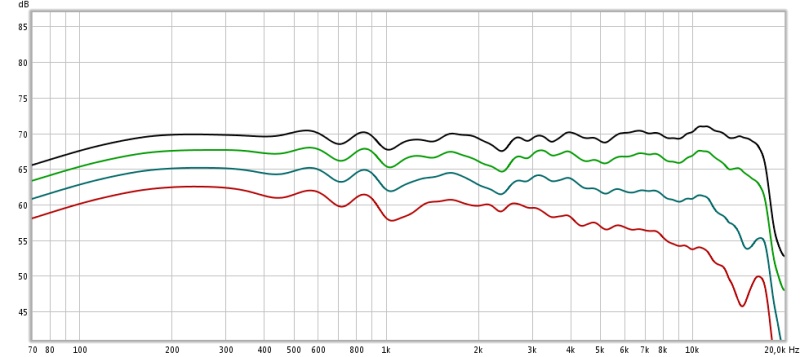

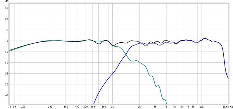

lets see your measurements, looks like it was falling off at 100hz above.....
These measurements are only valid from around 250Hz upwards, because in normal living rooms with 2.5 m high ceilings you cannot measure deeper without catching the reflections.
The bass can be simulated without any problems, so it is not absolutely necessary to measure it. I also added the simulation.

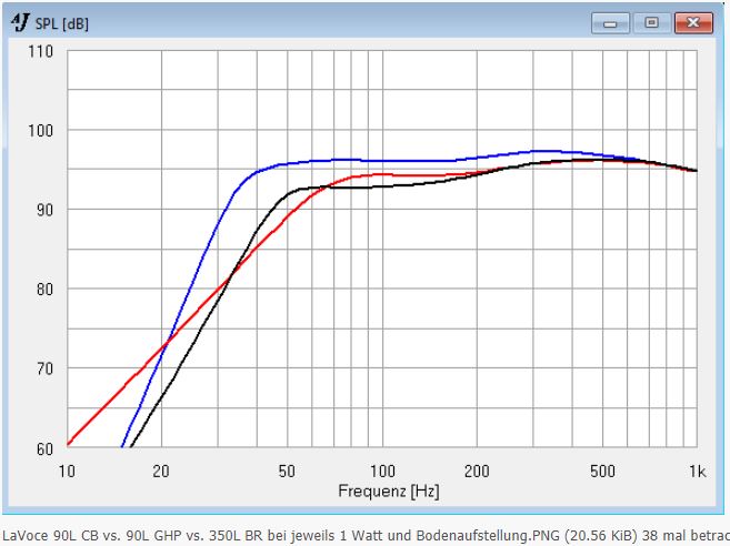

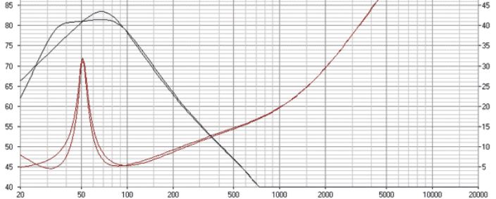

The internal volume is about 90 liters (3.17ft³) and it is closed, but with a large high-pass cap, which pushes a little in the bass. In the second simulation you can see what effects this has. Red is closed, black is with a cap. Blue would be a very large BR case, but it doesn't matter here.
@plasnu:
You're right, I could have crossed down to around 900Hz, but the off-axis response of the woofer and horn fits very well at 1.5kHz. I also tried a deeper crossover, but it got worse and would have required more effort for the crossover. And the woofer also does a very good sound up to 1.5 kHz.
Is the GHP based on the capacitor being loaded with the real, measured impedance of the woofer in box?
Yes, the capacitor lowers the impedance a little below the impedance peak of the closed box and thus enables higher levels in this area.
Unfortunately I don't have a measurement with and without a cap.
But here is an example of a subwoofer simulation based on the same principle.
