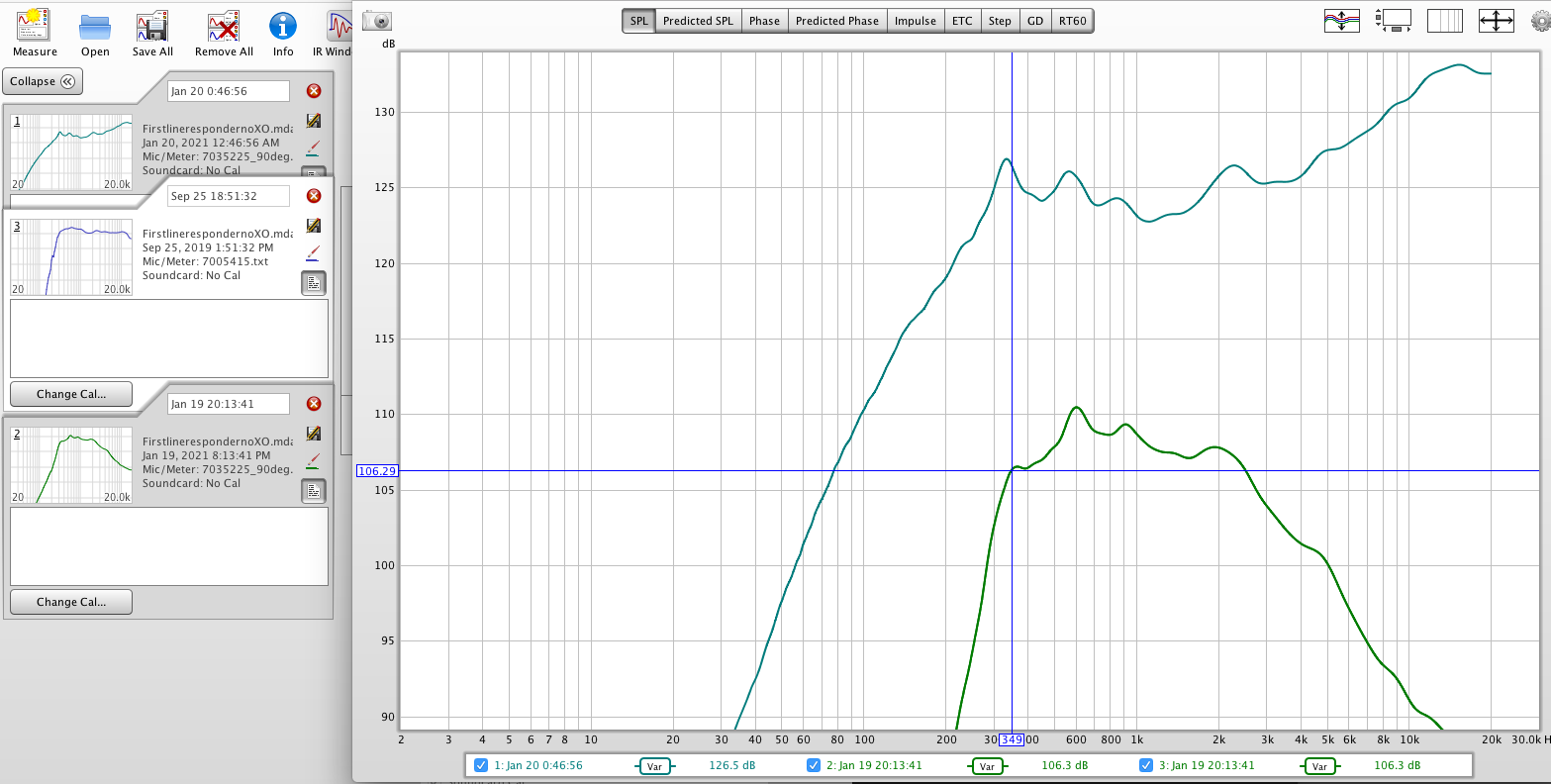

Heres some more measurements at the horn mouth no XO....
Assuming you are asking about the Xmax of a high frequency driver, when second harmonic distortion reaches around 10%, probably close to Xmax at the Fc (lower horn cutoff frequency).
When running a HF driver down low, Xlim (the diaphragm hitting the phase plug) is more of a concern.
The clickety-clack sound of the diaphragm hammering the phase plug will decrease in speed at lower frequencies, but the distinctive sound won't be multiples of the fundamental as in harmonic distortion.
I can't tell from your labels what any of the measurements are, though obviously most of them include various processing. Response at the horn mouth isn't great at predicting response at a real world listening distance, unless you are planning to use the horns as "Texas Headphones" 😉
That said, looks like the horn/driver combo has an Fc around 350Hz, making it to around 2kHz before dropping off at 6dB per octave. Will be interesting to see what the 600, 900, 2kHz, 4kHz "bumps" do at a few meters distance, and off axis.
If you have questions, posting the specific measurements would be helpful.

OK thats my fault, I selected save all measurements....In my mind that meant group delay/fr/phase etc lol
In the last measurement I have measurements from a 4" mid a 1" tweet and a whole bunch of other random stuff that was never supposed to be in the mix...my apologies
Here
AXi350hznoXO.mdat - Google Drive
You should find one single measurement minus any processing....this is a measurement that was in the mix of previous files...so it is still at horn mouth...I'll try to get some more data to share today.

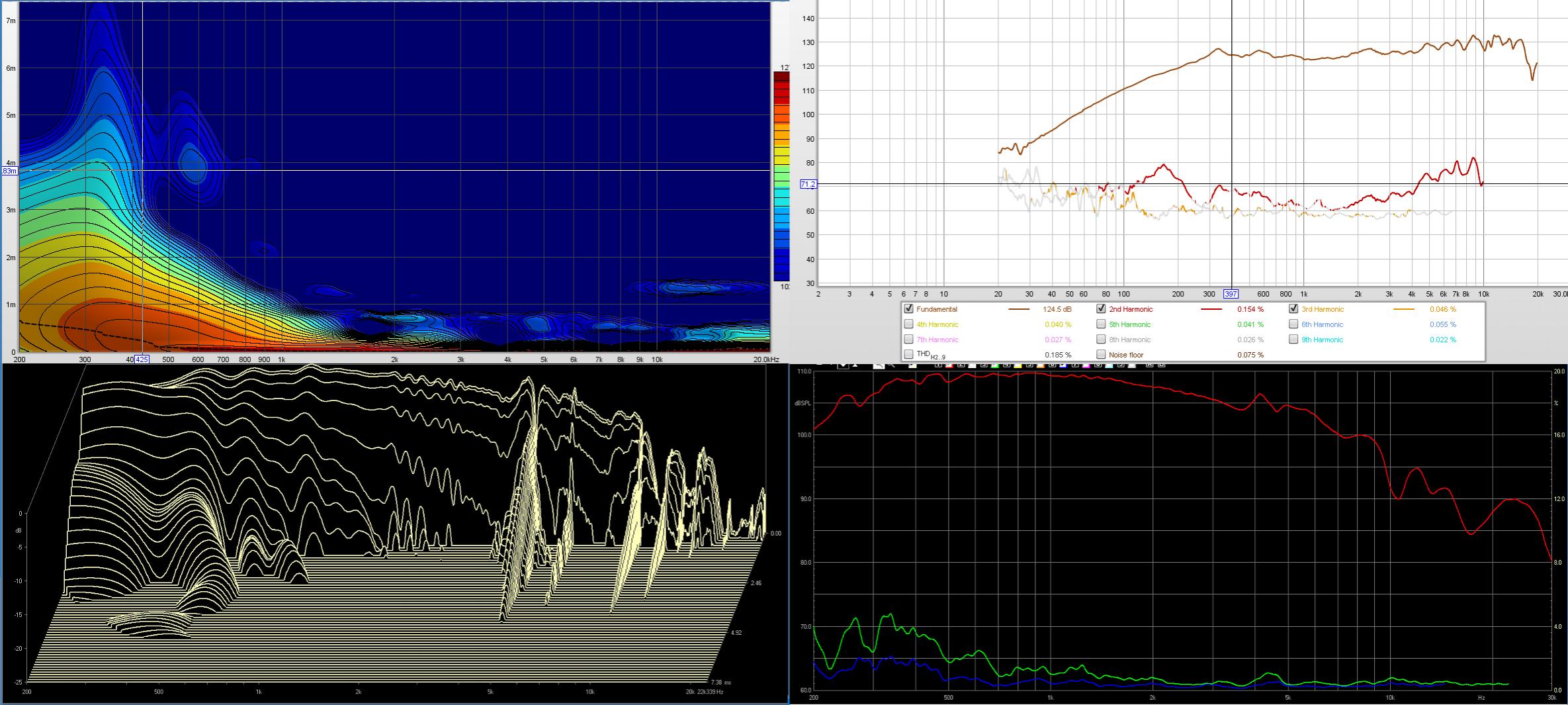

I thought I understood amplifiers well enough....so confused how this amp should be 2000watts rms...but yet I can only get so much volume after subtractive eq and high pass....and when I run test tones through REW I get much more volume than running VLC and mp3's? Makes no sense. Guess I'll get there slowly but surely... Not sure how accurate my measurements are but that 350hz test tone was much louder than I'd be playing it at nearfield and that was just one driver going so I am very confident, so far, about crossing at 400hz.....or basically as low as 350hz as long as system group delay stays in check......with a 350hz horn...I compared the spectral decay to that of a krk kevlar 4" and they were very similar.....the group delay of the resonate tail of the horn was the one major difference.

The volume between 400 and 2khz are similar though my measurements are at the mouth of the horn the measurements of the ATC sm75 are at 9"....in that small range you get reference and with distance accounted for, the magnitudes are similar in that area. I'm not sure if the distortion figures can be compared.
I think I used a 400hz 6db/oct xo and some eqing? I initially wanted to compare the resonant character of each...I cant say they are miles apart. Spectral graphs are set up for -25db

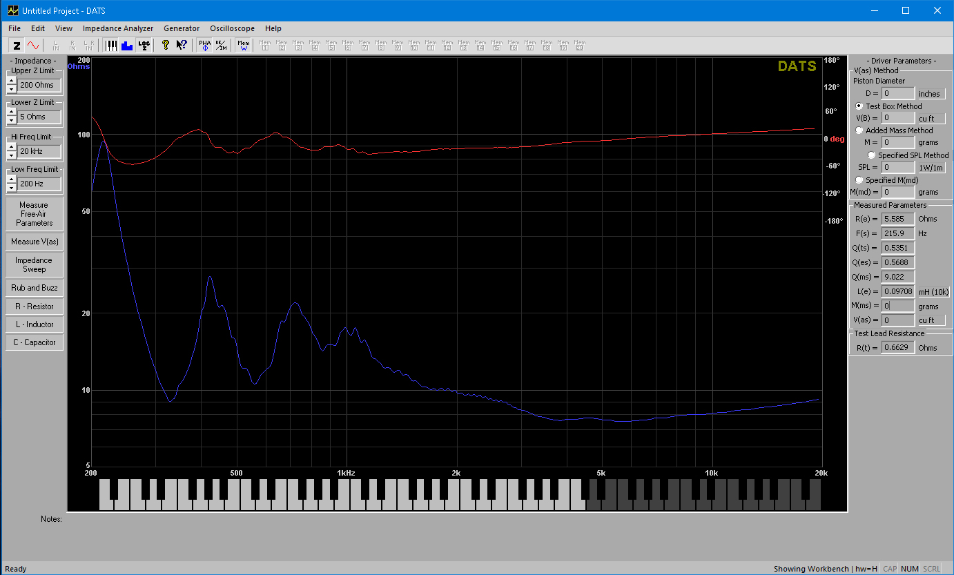

I got around to hooking up the DATS....below is the impedance I believe...I wonder if i play with mass and driver sd figures if I'll get readings on the rest of the specs?
What do you guys thing? Take the Axi apart so I set some mass on the diapragm? :headshot:
