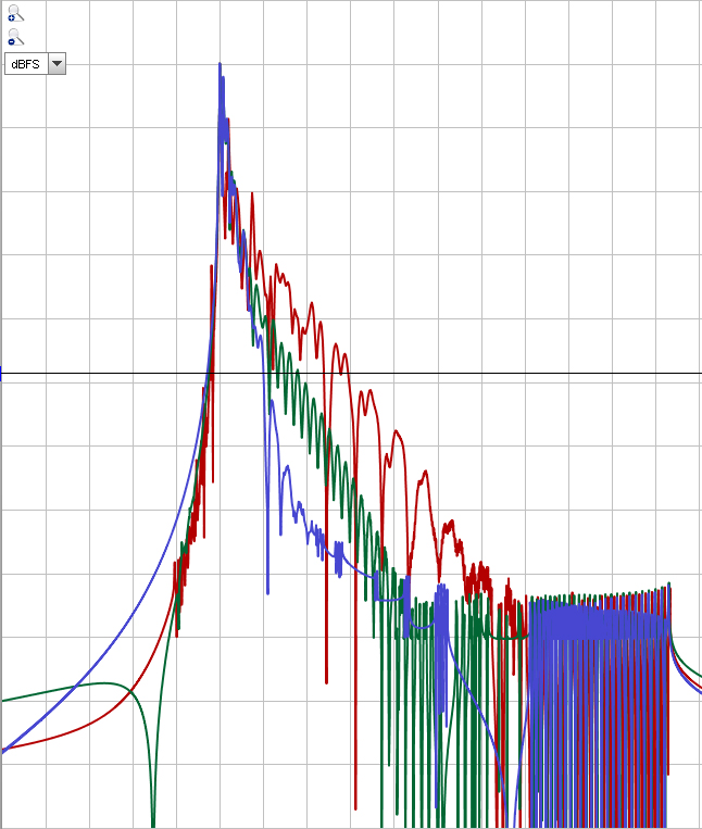

As I investigate enclosures with HR I thought this was notable
My woofer in a 3 different but same volume enclosures...Sealed slot load, Ported slot loaded, and a BR, both vented designs with the same port dimensions. The slot loaded ported seems to be better behaved than its non slotted cousin. The resistance of the slot must help to dampen the driver.

Which ETC is which constellation ? My guess is that the blue one is slot loaded-closed, red is ported and green is ported-slot.loaded.
What was the stimulus ? Pulse or step ?

You nailed it....What I've learned is that a fully stuffed low tuned (15hz before stuffing) vent has characteristics that might be hard for one to differentiate from a stuffed sealed enclosure while still carrying an extra 2 db at 300hz...
