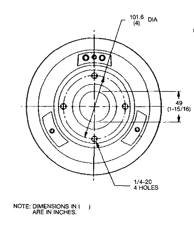

So all of my jbl products that are considered to be 2" are actually 1- 7/8ths......while the Axi is a whole 2"..it kind of left me jaded to even try my other horns due to this technical aspect. Whats the deal with that?

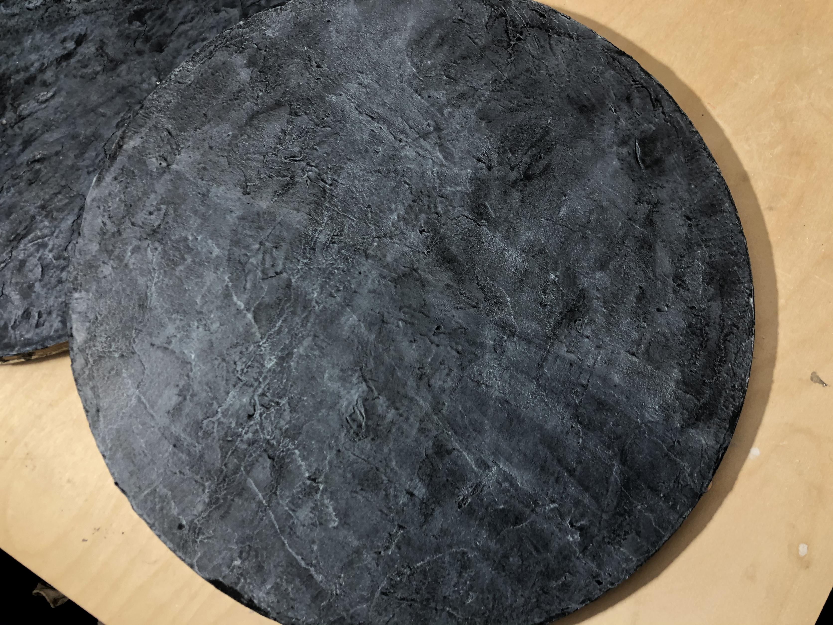

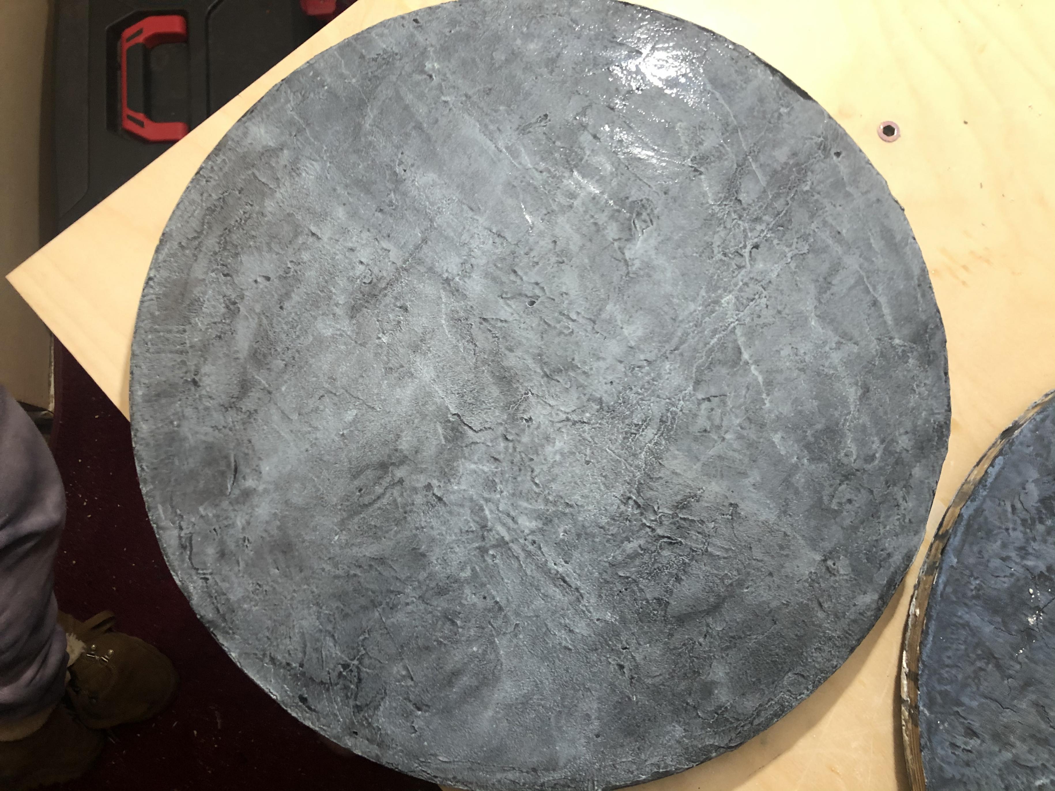

I finally came across a paint scheme that impressed me....I 'm accomplished at texture rolling poly enhanced cement only to realize that no matter what...after the cement sets and gets painted....it tends to look like a rock (the goal) anyway....and flat and smooth looks pretty appeasing....guess I'll texture lightly...
(sorry for the bad pic quality, actually the same model in both pics, lighting is closer to reality in the second pic, not sure why they didn't transfer as high res...)
The JBL's are supposed to be 49mm, 1-15/16", you must have some counterfeit products 😉So all of my jbl products that are considered to be 2" are actually 1- 7/8ths......while the Axi is a whole 2"..it kind of left me jaded to even try my other horns due to this technical aspect. Whats the deal with that?
Let’s just say my measurement was off...it still isn’t 2”....should I care or is small beans?
