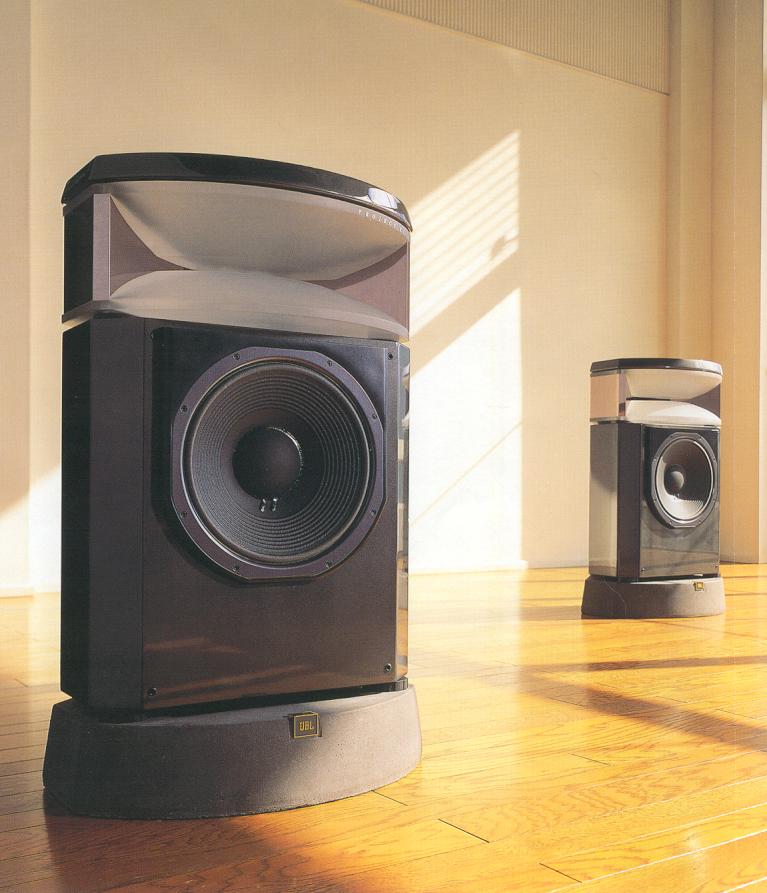

Still, this was a quite a succesful speaker:
Whereas this wasn't:
However, this was mainly due to the small price difference.

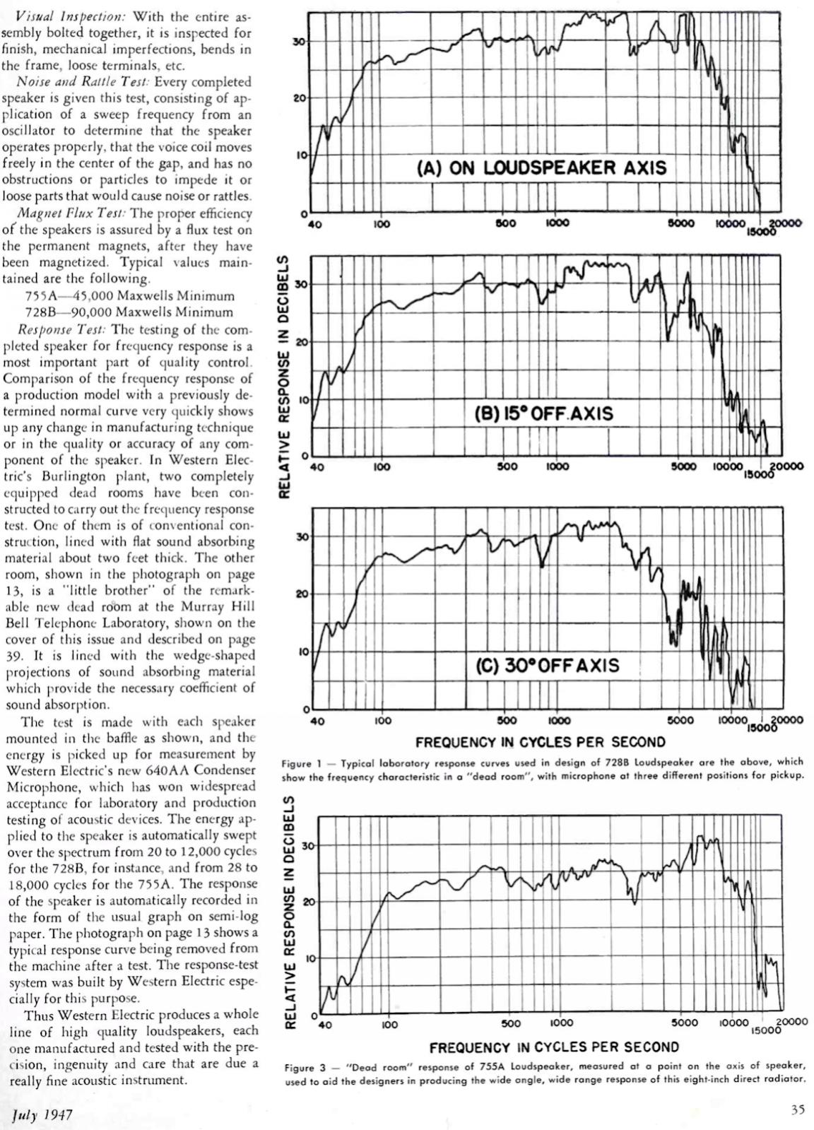

Here's a link to a video of the WE757A demo at Munich High-End, as discussed in the reddit thread. Skip to 6:50 in this video,
if you don't want to listen to Joe Roberts explanation.
The music is not everybody's cup of tea, the microphone (postition) not optimal, but it's good enough to get an impression.
Here's another video in which the innards of the 757A are revealed.

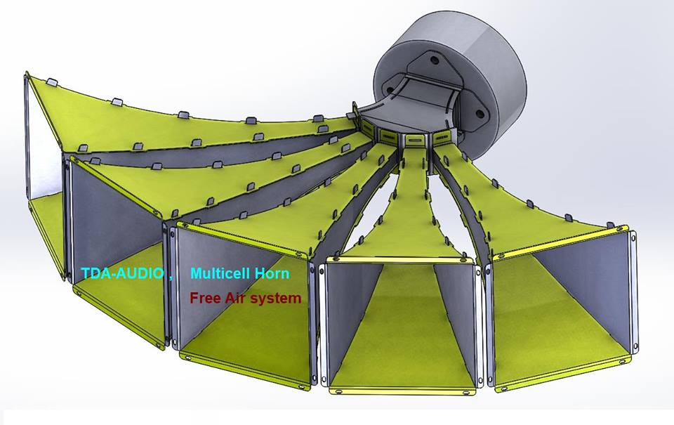

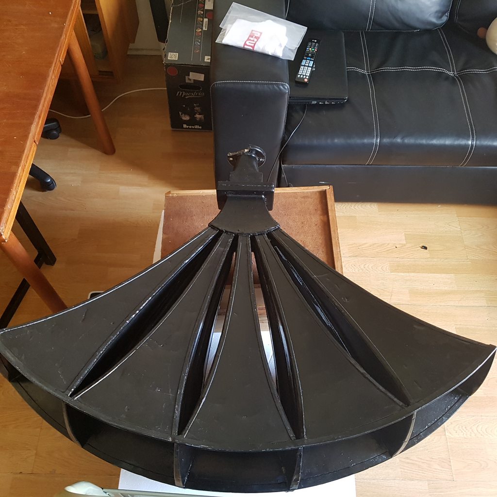

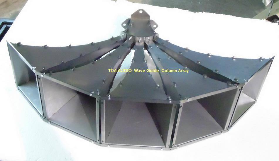

It would be interesting to develop a slightly modified and modernized version of those KS-12027s.
Some Russians have pursued a similar goal.
The KS-12027 is a more advanced multicellar horn, compared to this clone of an earlier WE design .
