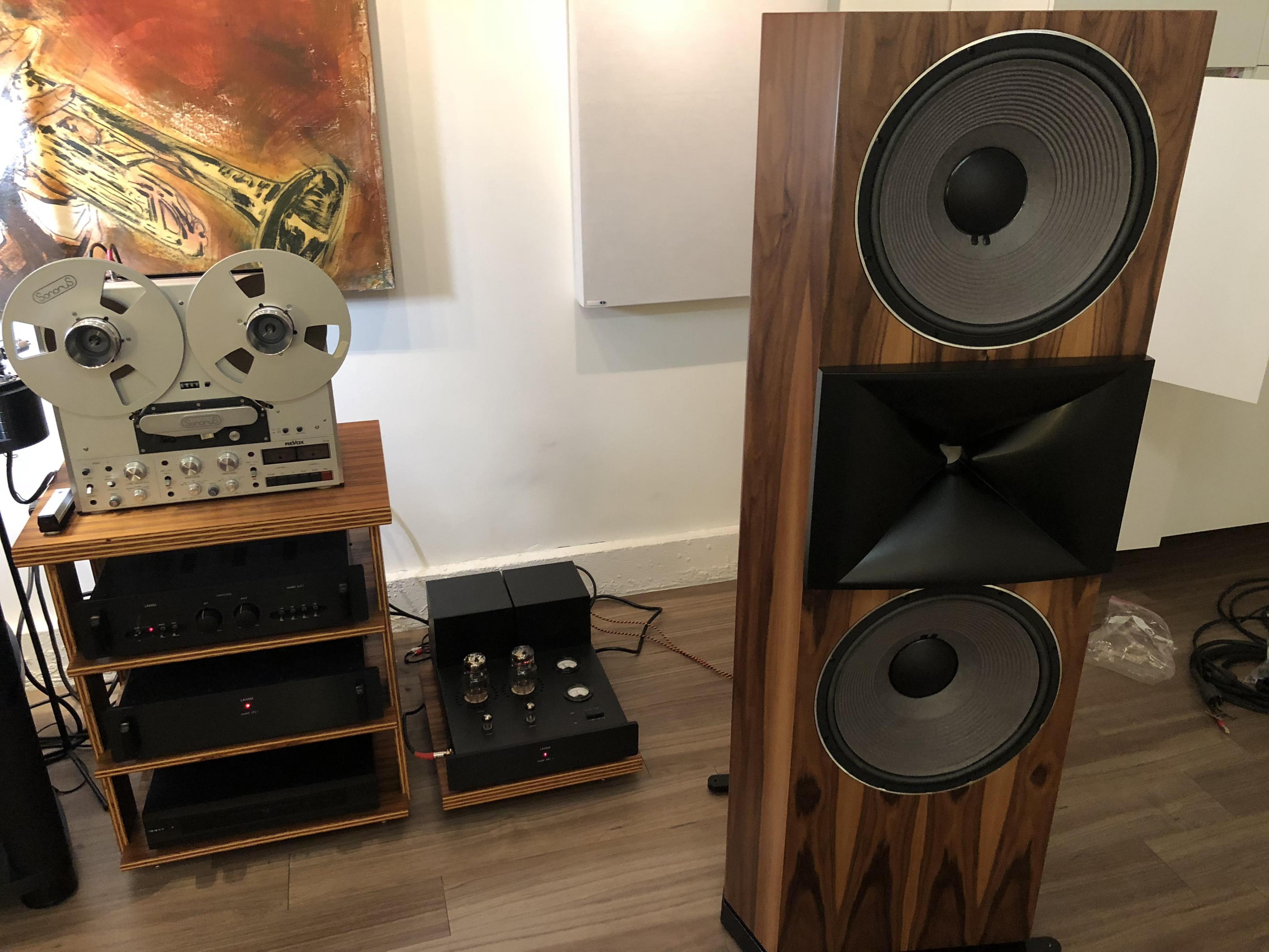

Like the previous image, this was his initial setup with both TD15M and TD15H.
The phase plugs are visible. Compression driver is a 745BePB.

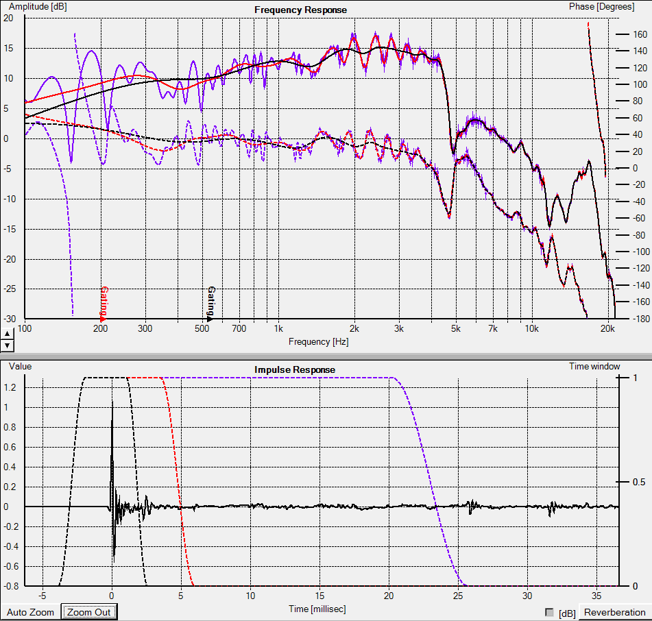

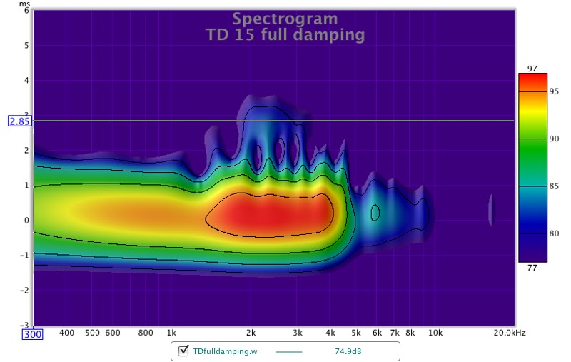

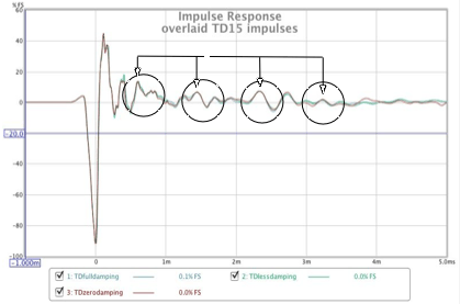

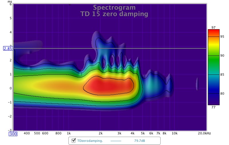

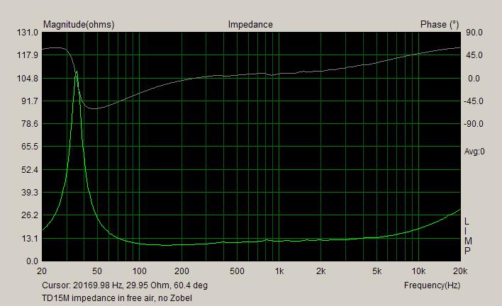

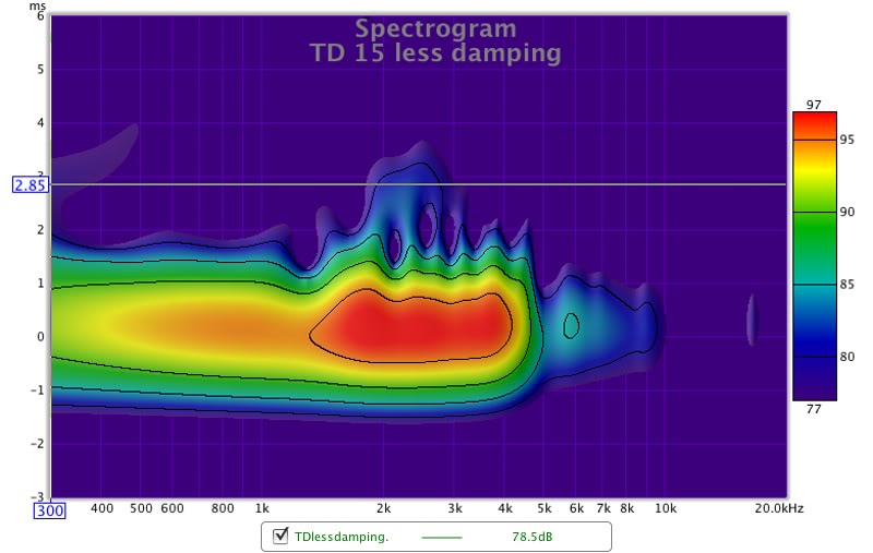

The reported 'problems' with the TD15M are probably a thing of the past.
Here are some measurements.

I didn’t figure out what problems the 15m had, yet...must be the resonance in the impulse you are referring to ����*♂️

If I remember correctly, the phase plug, or the surround of the 15M supposedly was the source of some resonances.
I don't think this is a deal breaker, especially if you intend to cross low.

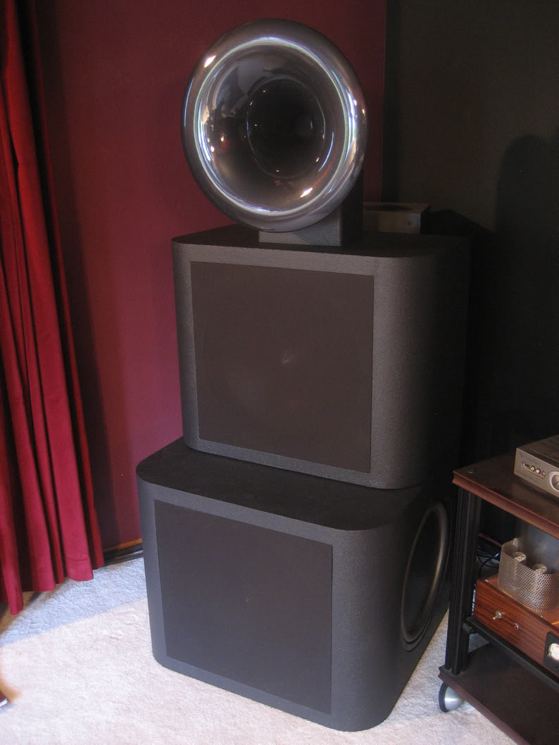

The sonic differences between (round) Tractrix and JMLC horns will be subtle compared to constant directivity horns.
For a given mouth circumference the Tractrix will load the driver better, because the mouth of a JMLC is effectively smaller.
A large part is taken up by the roundover.
With a JMLC you'll almost inevitably end up with a multiple horn solution, or a higher crossover point > like Gary's system.
