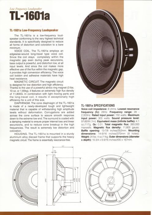

This is 'on the edge' for midrange duties, but usually also crossed (way) below 800Hz.
There's a rule of thumb, which usually distinguishes technically advanced concepts with perfect measurement data from similar loudspeakers that were developed with the acoustic perception in mind.
Never use a woofer with a MMS >80g above 500Hz.
There's much more to this statement, but it basically comes down to the handover between the woofer and the, preferably 3", compression driver diaphragm.
You don't need a PhD in physics to 'see' why a 120g cone crossed to an 1.75" diaphragm is a recipe for 'shortcomings' in the midrange.
Mms on its own means nothing.
It's the ratio of the electromagnetic force factor (BL^2/Re) to Mms that matters w.r.t. faithfully reproducing higher frequencies. And lo and behold, that is directly proportional to the Efficiency Bandwith Product (Fs/Qes).
I don't mean to come across as snarky, but... while one may not need a PhD in physics, some understanding of the actual physics at play would certainly help.
And alas, intuitive "rules of thumb" rarely cut the mustard.
Amicably,
Marco
😉 Agreed.
I deleted the EBP part from my post, that's why I stated "there's much more to this". EBPs of TAD woofers were considered benchmarks for a long time.
Still, I think the rule of thumb applies.
Electrically and mechanically "faithfully reproducing higher frequencies" still doesn't automatically translate into a sonically 'correct' midrange, but I admit it's an important aspect in loudpeaker design.

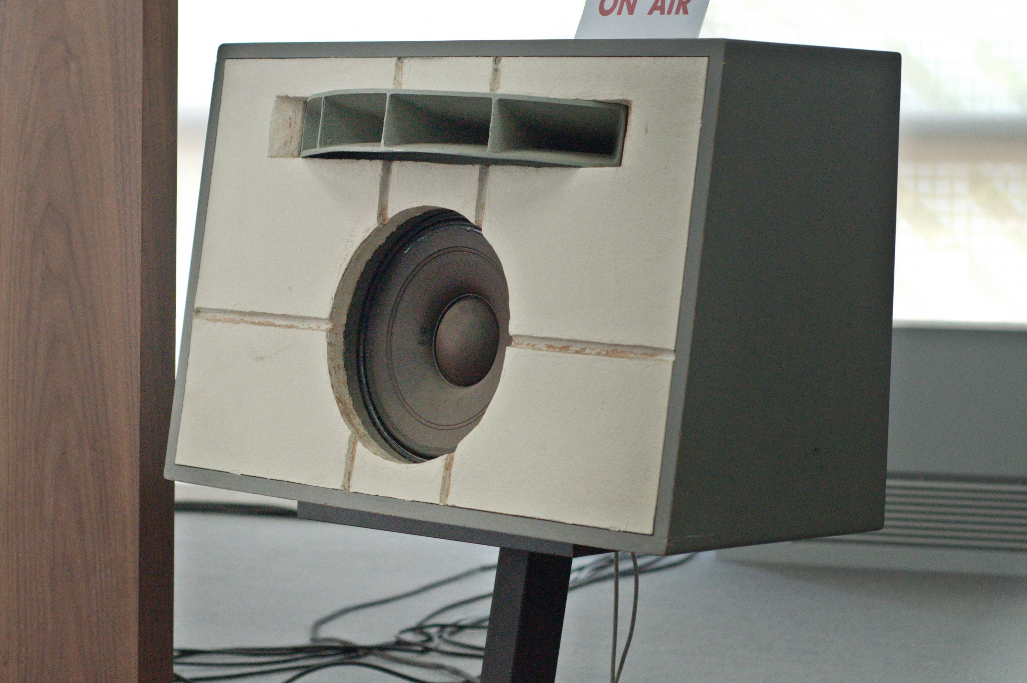

For similar reasons, a number of reviewers, apparently not yet poisoned by an overdose of mediocre high-end products, rated the 1947 WE754A monitor 'best of show' on a recent Munich High-End.
