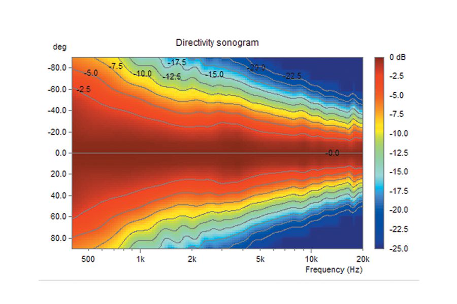

Your listening spot is 15m from the speakers? That's nice, because even with the tractrix you'll have a reasonable sweetspot. 20-30 degrees spread (in the top octave) is usable and it actually makes sense to use a tractrix in this case.
Many waveguides, especially OSWGs won't cut it 'full throttle' in such spaces.
Also, you don't need to worry about the blending between the horn and the TD15M, because at 15m they'll pretty much sound like 1 coherent source, after DSP.

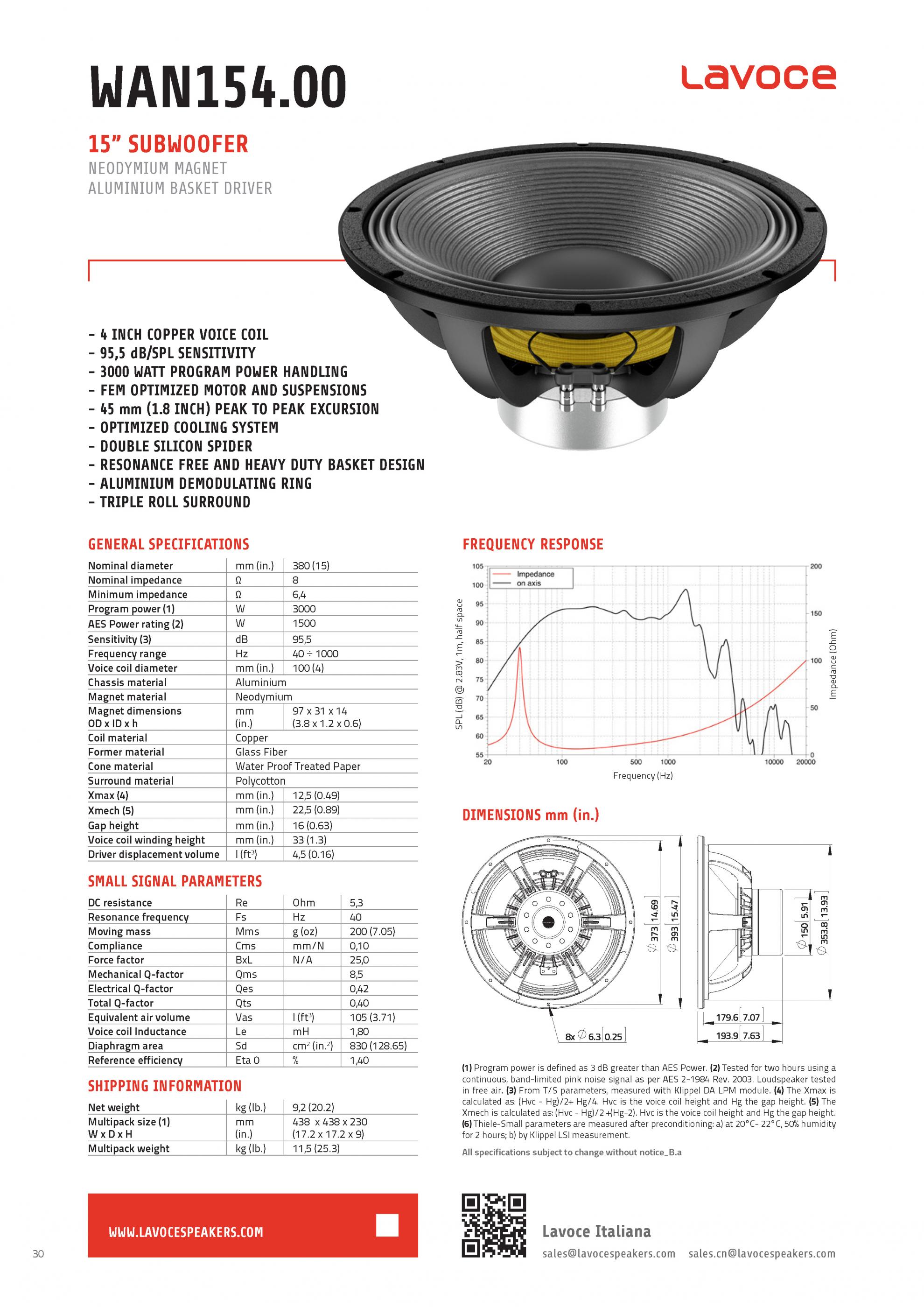

Less an air pump, much more efficient, better power handling (1500W AES), won't go as low as the Dayton, but much louder.
Specs are quite impressive, especially considering it's currently only $240 at PE (Clearance item).
