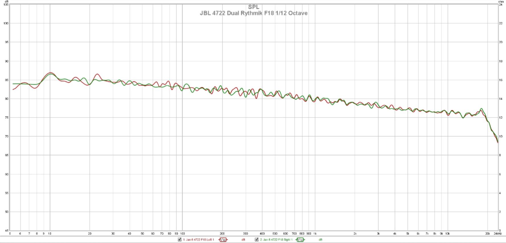

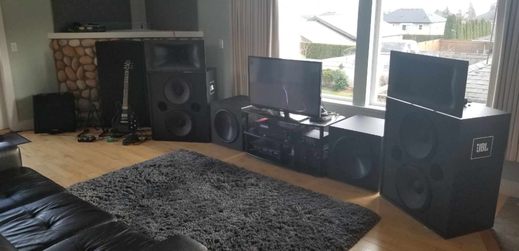

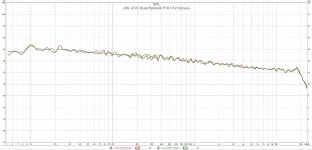

I am pretty happy with my 2 way with the addition of the subs:
attachment.php
attachment.php
Good luck with your build!
757784d1558322977-cover-spectrum-spl-low-distortion-2-a-f18-jpg
757785d1558322977-cover-spectrum-spl-low-distortion-2-a-jbl-4722-rythmik-f18-jpg

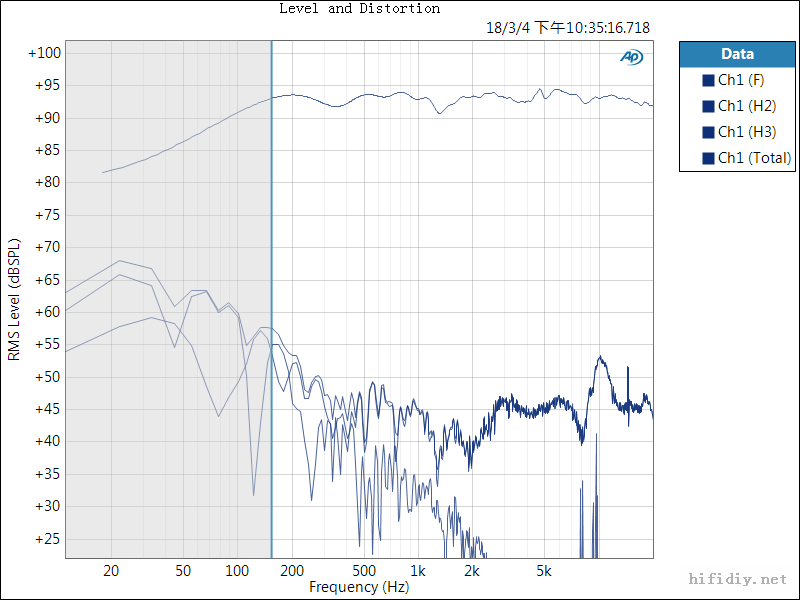

How about my work:
15WU/8741+6640, 10 Liter cabient.
SPL and Distortion measured @ 100W input, 1m distance:
I will never use 100W input power for this speaker, because my small listening room is only 7m^2.
