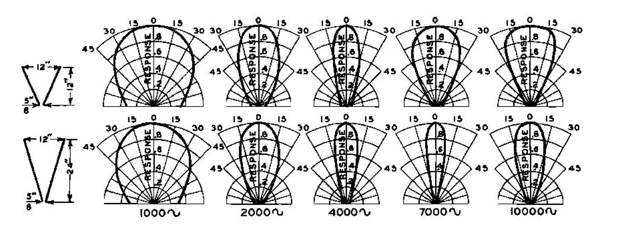

Thanks! That's very interesting. It's unfortunate that no other horn flare types are given. Since we are generally using flares that flare completely to perpendicular in order to reduce mouth diffraction, the examples given are only helpful to illustrate my point if you visualize the examples as a section of the final horn. It seems though that my theory holds pretty well and that the diameter where wall angle predicts radiation is about equal to double the wavelength.

I've owned Olsen's book for nearly 40 years. I have found that it is filled with errors. Don Keele commented on this once when he found that a horn that he measured didn't look any like what Olsen said it should. I have come to believe that much of what Olsen shows is based on his hypothesis of how things should work and not on actual measurements. So I would take those drawings with a bill pill of suspicion.
There's a lot of that going around, people sometimes can't seem to separate the subjective from the objective.I have come to believe that much.......is based on ... hypothesis of how things should work and not on actual measurements.
A hypothetical piston emitting spherical waves through a 5/8" throat opening into conical horns is different from a typical compression driver of that era, which includes a deep conical exit section.
The Models We Use ...
… always bare imperfections. The unknowing sometimes drive nails with a ballpeen hammer, and then observe the bent nails in amazement. Olson's original book is circa 1940, and there are errors in some of the math presented their as well. See attached file containing results form a superior model produced by John Sheerin.
WHG
WHG

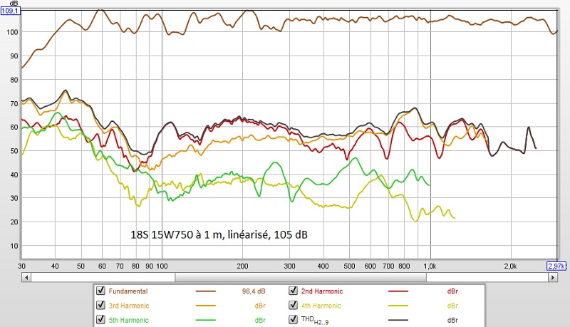

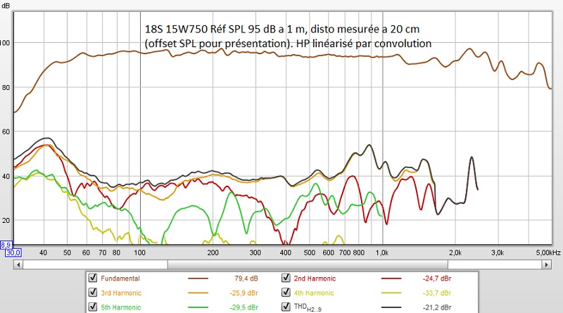

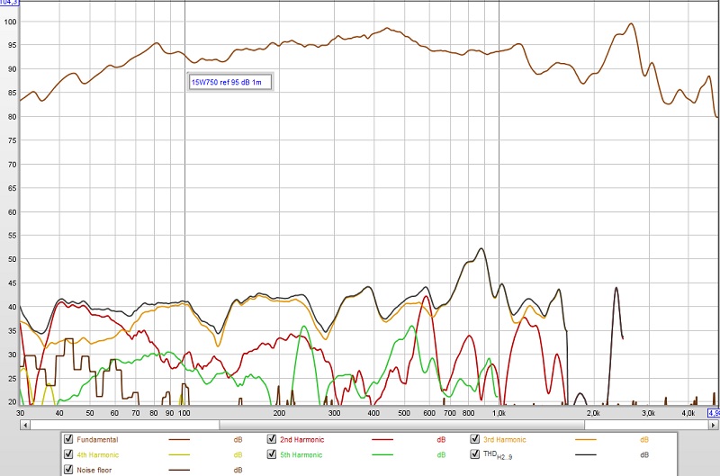

A more affordable and very capable contender is 18Sound's own 15W750.
18S 15W750, measured at 20 cm after calibration SPL 95 dB.jpg115.1 KB · Views: 511
18 S 15W750 in room 1.2m of the ground, 2m from the walls.jpg101.8 KB · Views: 505
18 S 15W750 in room 1.2m of the ground, 2m from the walls, measured at 1m.jpg103.5 KB · Views: 508
18 S 15W750 in room 1.2m of the ground, 2m from the walls, measured at 1m and 105dB.jpg105.2 KB · Views: 494
- Is it possible to cover the whole spectrum, high SPL, low distortion with a 2-way?
