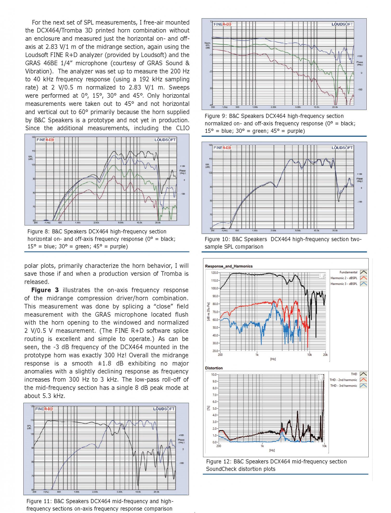

DCX464:

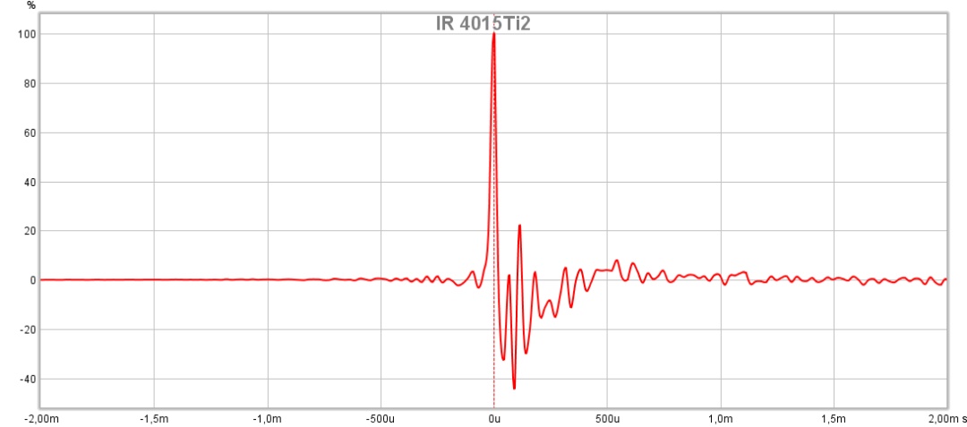

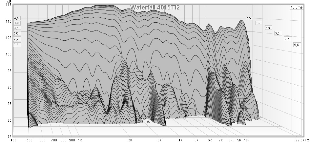

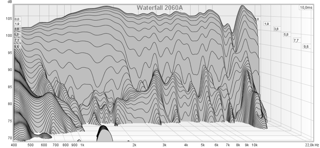

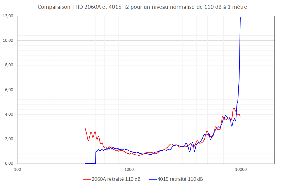

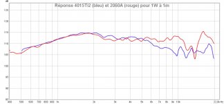

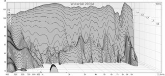

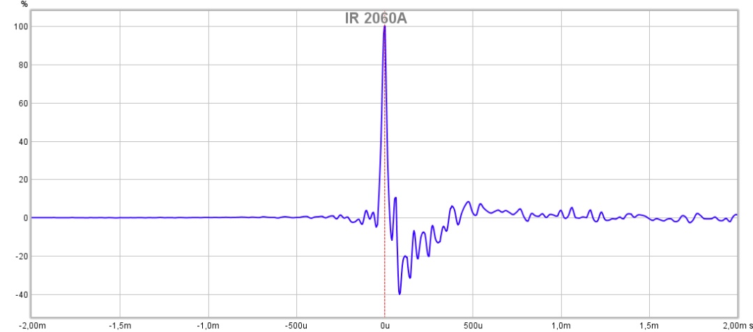

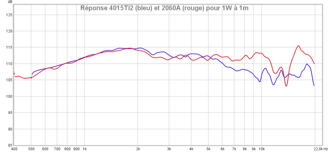

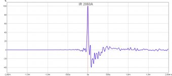

18Sound ND2060A versus 4015Ti2:

With Paul Klipsh's modulation distortion equation in mind, surprised no one mentioned going 3 way instead of 2 way.

I found one of his studies (https://pdfs.semanticscholar.org/79d0/b397722fb432c888965fd4cc0b18c56a7d5f.pdf), not sure if this is the one you are referring to but thanks for bring it up, the conclusion is noteworthy.
In a nutshell its saying large diameter drivers, and Horns are the enemy of IMD
CONCLUSION
The fact of the case is that distortion is closely proportional to power output. Also the distortion is closely
proportional to diaphragm excursion. The 30-cm directradiator cone had to move about 1/3 as far as the 20-cm
direct-radiator cone for the same output, and the distortion was close to 10 dB lower. The horn diaphragm motion was too small to be measured but could he estimated
to he about 1/ that of the 30-cm cone, so the 17-dB
difference in distortion is the right order of magnitude.

The article just showed that quality associated with with Horns, known as "dynamic contrast", said to be an unmeasurable spec...is actually technically known as amplitude modulation distortion, which horns tend to lack, and like I assumed to be true contrarily, is absolutely measurable.
The more we know....
Sorry, but this is not correct. There is no data to support that the issue is "actually technically known as amplitude modulation distortion", in fact I doubt that this is a factor at all. What is known is that linear phenomena such as diffraction becomes more audible at higher SPLs which can also be heard as "dynamic contrast" and which, based on my research, is more likely to be the issue.
