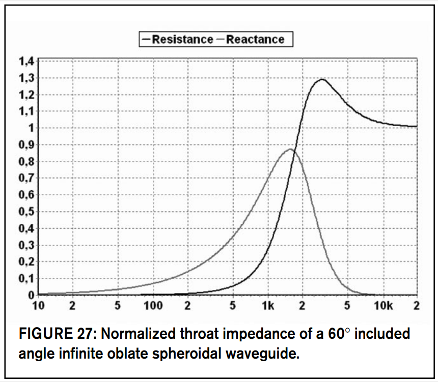

Bjørn Kolbrek (audioXpress 2008-3):
"The OS waveguide does not have a sharp cutoff like the exponential or hyperbolic horns, but it is useful to be able to predict at what frequency the throat impedance of the waveguide becomes too low to be useful. If you set this frequency at the point where the throat resistance is 0.2 times its asymptotic value,
so that the meaning of the cutoff frequency becomes similar to the meaning of the term as used with exponential horns.
The cutoff of the waveguide depends on both the angle and the throat radius. For a low cutoff, a larger throat and/or a smaller angle is required. For example, for a 1″ driver and 60° included angle (θ0 = 30), the cutoff is about 862Hz.
The advantages of the OS waveguide are that it offers improved loading over a conical horn of the same coverage angle, and has about the same directional properties. It also offers a very smooth transition from plane to spherical wave-fronts, which is a good thing, because most drivers produce plane wave-fronts.
The greatest disadvantage of the OS waveguide is that it is not suitable for low-frequency use. Bass and lower midrange horns based on this horn type will run into the same problems as conical horns: the horns become very long and narrow for good loading.
To sum up, the OS waveguide provides excellent directivity control and fairly good loading at frequencies above about 1kHz."

Just his numbers, I calculate the cutoff to be lower, but then I don't know how Bjorn defines cutoff. Otherwise I agree with what he has stated. Again, just because the "loading" is falling below some point does not mean that it doesn't work well down there. It just means a few more dB of gain in the crossover, that's all.

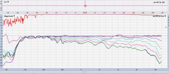

Given the Peter Morris boxes keep getting mentioned, I though I'd post some polars for the PM90 with the bms 4594he/HF950 ..
taken today in a lot more wind than makes for good measurements...but I took them anyway as a sanity/comparison check for today's measurements I was making on the synergy effort...
on axis (black) to 60 degs, 10 deg increments....
my standard tuning...which is make on-axis flat, see how off axis holds up...
(10deg purple looks extra wind suspect..)
LR72 @ 100Hz HPF
LR72 @ 100Hz HPF
Looks good Mark, despite the wind.
