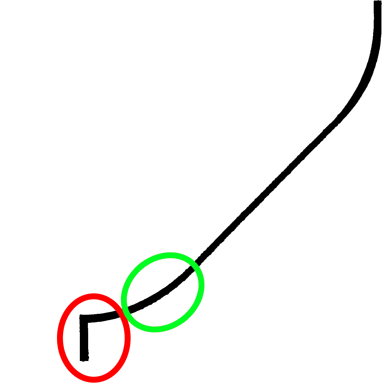

A narrow opening in general means that there will be wide dispersion at the lower frequencies but much more narrow at higher frequences. I would never consider narrow opening as a good thing.The vertical dispersion on a smith horn has to be pretty wide with such a narrow opening.
Narrow, pinched, or low flare rate?
Initially, the OS throat is also narrow (outlined in red) - a low flare rate without pinch, but it instantly opens up 'fully' - at a high flare rate - to the mouth section (outlined in green).

I often get confused with terminology....
is 'flare rate' the change in curvature, or is it change in area? (what I've been thinking)
Or can it be either, depending on context? This seems to be the case...
The OS throat is probably the best 'compromise' (no pun intended) and Dr. Geddes deserves all respect for the invention by working out the maths behind it.
The magic of the OS is - what I like to refer to as, "the pull-out trick".
In simple words: the throat pulls out the wavefront at high frequencies, even those at the wavelength is smaller than the throat circumference.
As a result there's no beaming all the way up to 20k.
Due to the short throat there's hardly any loading of the driver below, say 800-1000Hz.
