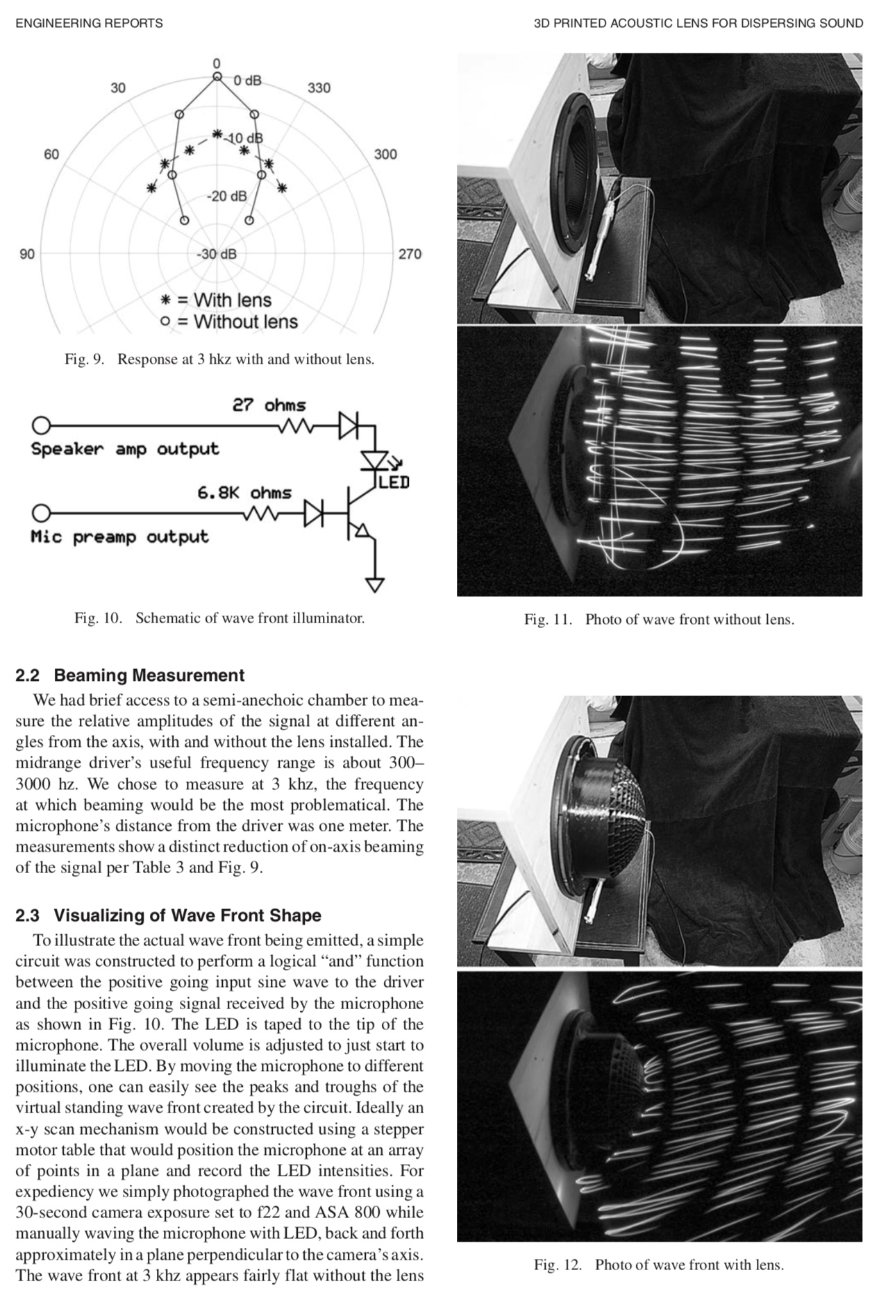

Is it possible to cover the whole spectrum, high SPL, low distortion with a 2-way?
Like this.

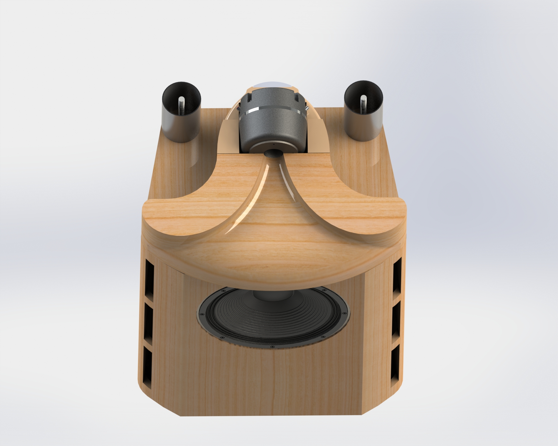

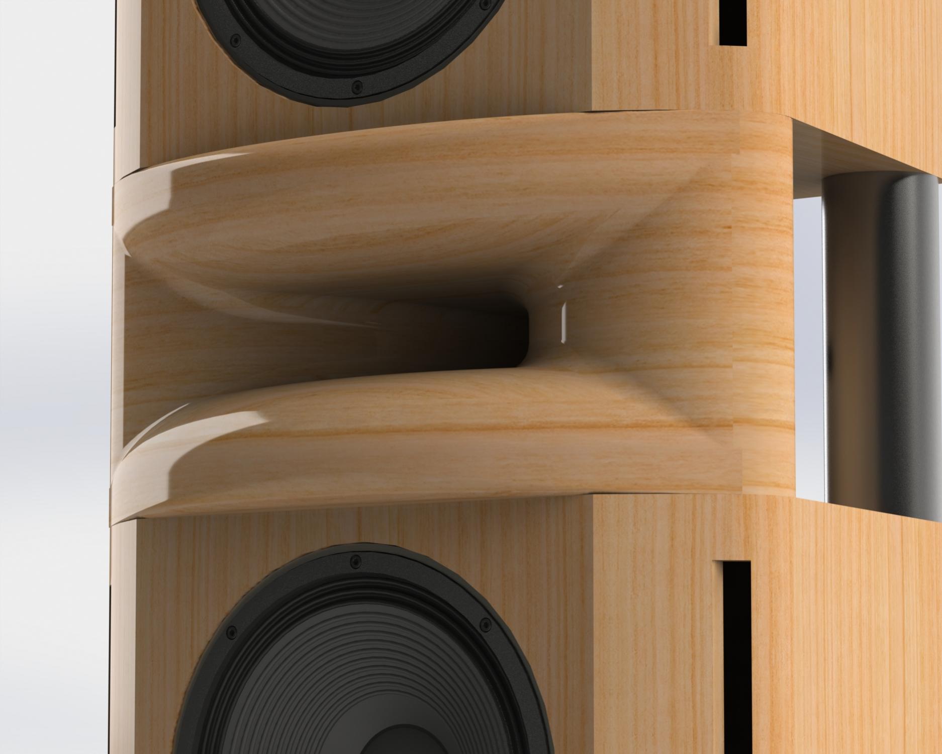

It's a radial horn, similar to those of Arai/TAD/Vitavox/Yuichi etc.
If Joseph Crowe were to inflate his ES-800 to an ES-300, it would be about the size of the G.I.P. 9712 (excluding his roundovers).
I actually will be involved in a project where the ES-300 Biradial will be used for customer's speaker. The Yuichi A-290 was originally slated for the design but they've opted to use the ES-300 instead. I've not built this size yet so it will be very interesting to see how it performs. The decision was based on the ES-1200 and ES-800's measured performance. The chosen compression driver will the TAD TD-4001. We are fairly certain this will be the best chance of obtaining wide coverage in the upper treble but there's no way to know until the horn is actually built.
