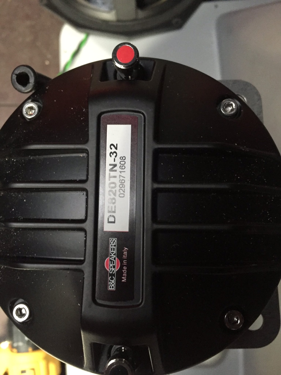

Does anyone have experience with the B&C DE880 and/or DE980-TN?
I was pleasantly surprised by the smoothness of the older DE820, when I heard those mounted in F1 Resolution 3s at high SPL.
The ..880s are supposed to be even better, especially in the top octave.
Danley exchanged FaitalPros for DE880s in the SH96 (non HO).
