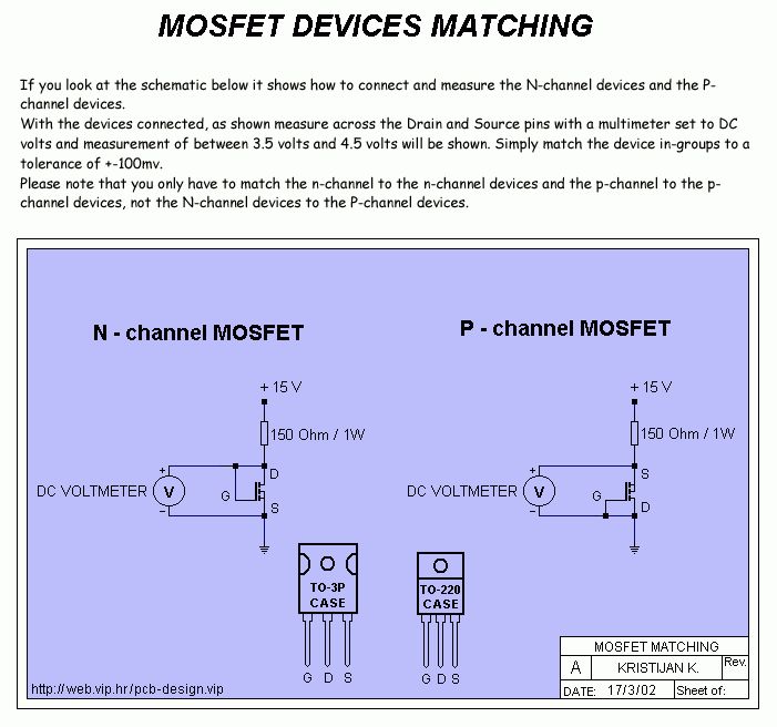

Nigel, please leave the working channel alone, don't mess with it (if you poke it too much...). We are talking about and taking readings only from problematic channel.
Take out off the board Q3 and Q6 of the problematic channel and check them using the matching procedure:
http://passdiy.com/pdf/matching.pdf
That will show the problematic MOSFET.

1. No need to change anything.
2. You are fine without C2.
3. MOSFET-killers are, most often, heat and too high Vgs (more than 20V). We can exclude Vgs as a culprit here. So, the first thing that comes to mind is quality of thermal coupling between the MOSFET and the heatsink - check the temp. differrence between them, the MOSFET' case shouldn't be much hotter than the heatsink (say, 10 degrees C at most).
Also, check the connections on the board (especially around power resistors) - bad solder joints may reveal themselves only at higher temp. It might be a good idea to resolder any suspicious looking joint (those who look too gray, porous, without a shine).

Nigel, I'm glad it worked all right :up:
Please check the temperature difference between the MOSFET's case and the heatsink. It will show whether you did a good job on mounting MOSFETs to heatsink or not (it is an important reliability factor).
Here is the sch. that will help you check your old MOSFETs. Never mind the current through them (the 150R resistors sets it at about 75mA) or measurement voltage (it doesn't have to be exactly +15V, anything from +10V upward will do). If you get a reading on the voltmeter of about 4V - MOSFET is OK.
Take care about polarity (N-channel vs. P-channel).
